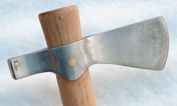

Cleaned off the paint, polished it up a bit, worked the handle a bit, drilled out the threading, made a symmetrical hole on the other side and then inlaid with some brass.
Phase one complete.
AGain, I seem to purchase completely inferior tools to you Wayland, do you shop at super B&Q? I have bought hawk no2 to modify as a gift for a friend. As it is a gift I was going to try the above and inlay some nice 6mm mosaic pin. My drill bit did fine at trimming the thread on the origional hole, but after getting half way through the other side the bit has now melted to 4 or 5mm at the tip and put enough vibration through my drill stand to make the initial hole slightly too big :(
At least if this doesnt work out too well I can learn and modify my approach to hawk no2 to keep it as pretty as possible.

I took mine with me on my Arctic trip this year.
It was the only practical axe I could carry due to weight restrictions on aircraft but it performed very well under the circumstances and has now earned a permanent position on my equipment list.
It has been used many times before and since although I have never yet seen fit to throw it at a tree.
I wonder how much you have tested one?
Look at that picture. Obviously completely useless. I'd suggest you just dispose of it safely to me to save me the hassle of modding mine as they're not as blingtastic as a GF proper tool.
