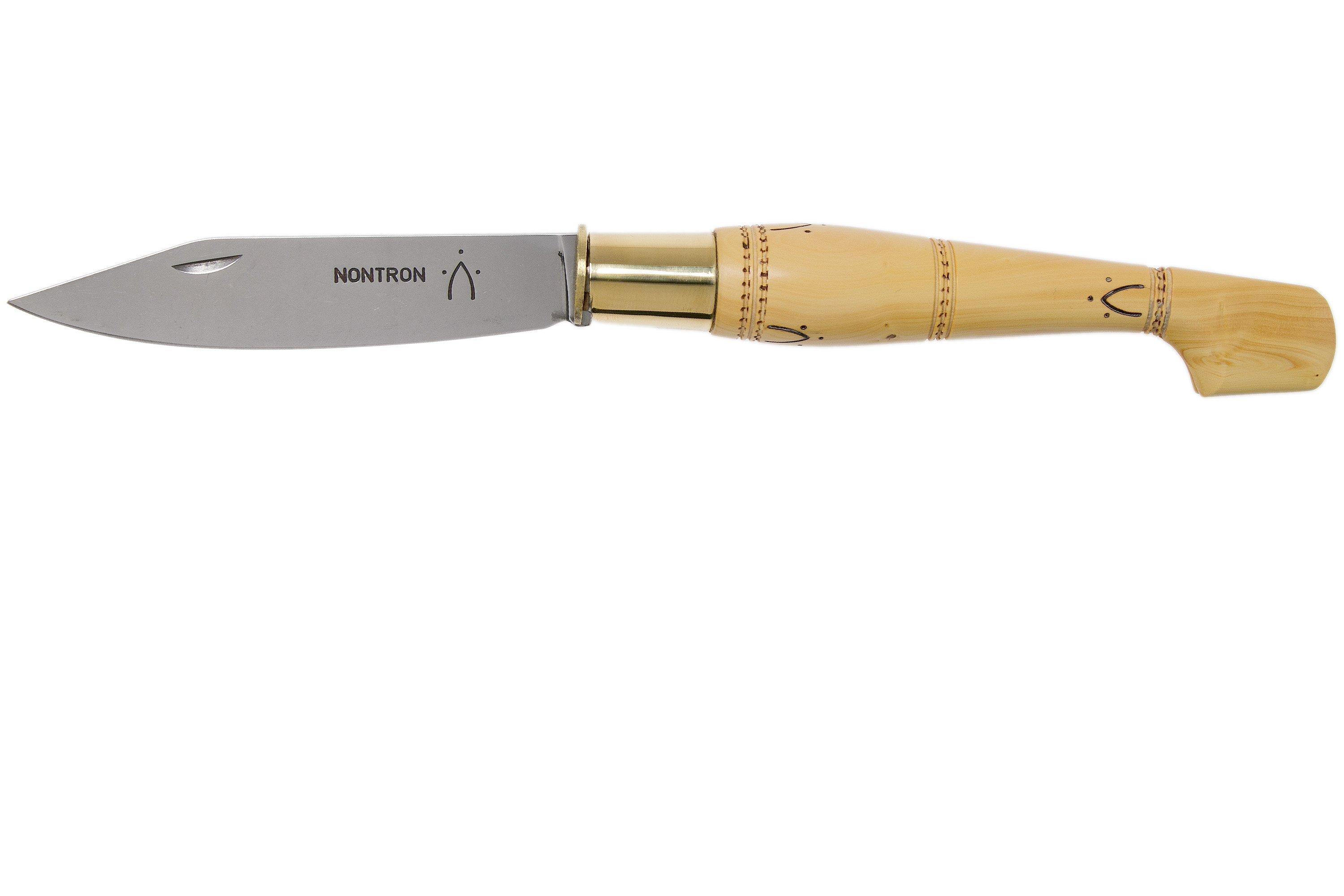

The traditional Nontron knives have a very similar mechanism but made of brass and without the bulge that the Opinel has in order to keep the moving part on the head of the rivet. The Nontron has a flange on the fixed part.
Reactions: Pattree
Yes indeed, I like this lock on the Nontron and might one day ask someone to do something like it in stainless steel for me. I only have a toy wood lathe.
My problem with brass is that, with heavy use, the back “shoulder” of the steel blade will make an impression on the brass collar. As mentioned elsewhere a 0.15mm depression will increase the turn on the lock by anything between 15 and 20 degrees.
