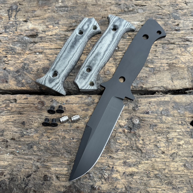

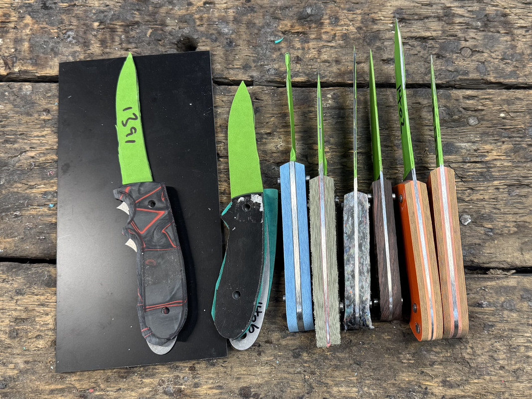

How will you put your mark on that one with the Cerakote?
That one isn't getting a blade mark; we have decided that sterile suits it.
The lasering still works with the Cerakote though, it just burns through it.

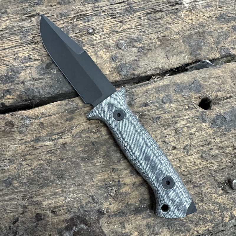

Aye I would love something like that P90 in 2mm!

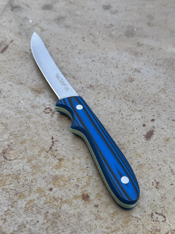

Not a P90 but this is from a couple of weeks ago, 2mm stock SF100 steel.
Blue/black Suretouch (G10 and rubber layers) and Starlight GITD liners.
I like the sound of the Suretouch. Sounds like it removes one of G10's main drawbacks. Does it affect the weight at all? That being the other drawback. With it being rubber, how does it cut/grind? is it more susceptible to overheating/damage?
Lovely knife too.
Lovely knife too.
It is a nice material.
Probably a little lighter in weight than normal G10, but I have never checked it like-for-like. Cuts and shapes nicely, no problems. I finish it down to around 400g, and I find that fine enough.
Kydex moulds well around it, too, so there are no overheating issues.

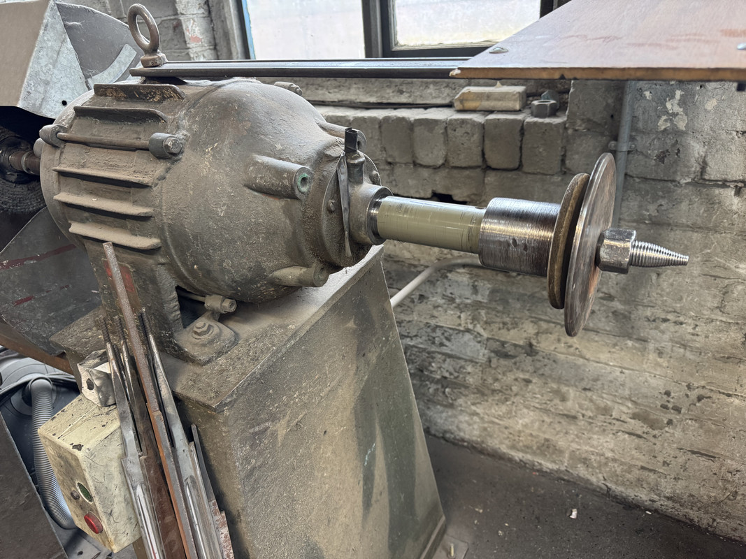

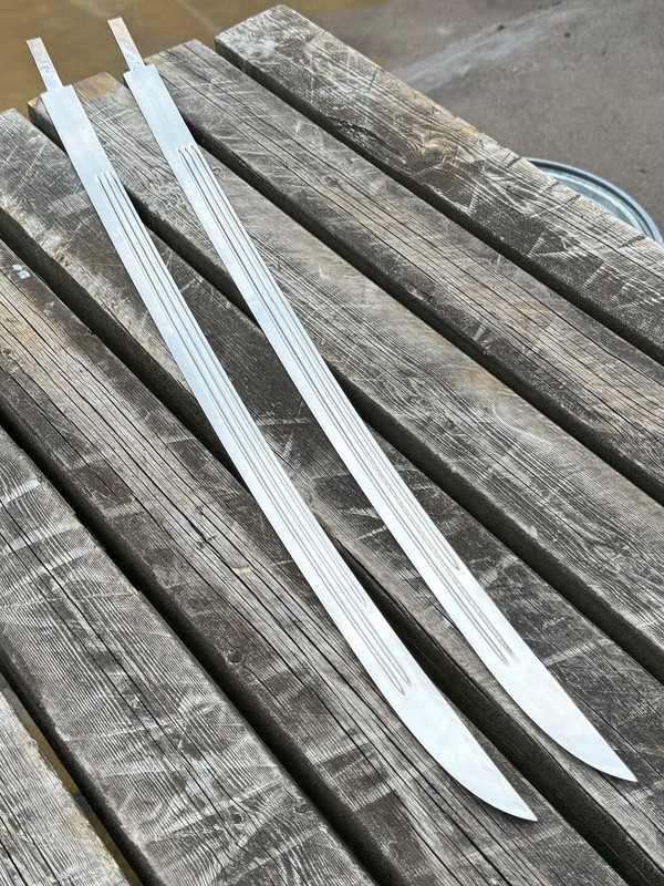

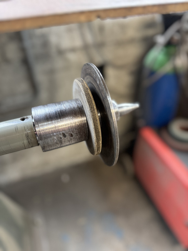

How do you do your fullers Stu? Ball nose end mill?
I set this up...
Like this...
The smaller 'wheel' you see there is the cutting wheel, the larger is a steel disc that the spine of the blade can rest against.
I fit spacers between the steel wheel and cutting wheel to govern the distance from the spine of the blade to where the groove is cut.
Once I have a to gro ove cut where I need it I remove the steel wheel and use different grinding and finishing wheels to adjust groove width and finish etc.
A but Heath Robinson but it works and what I really like about the set up is that I can grind curved grooves.

Quite an elegant solution really. I can see the benefits of it for grinding curves. I like it.

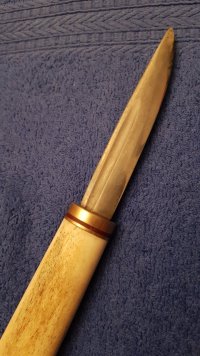

A gent on another forum has a knife in his possession, a knife he has a long history with and one with great sentimental value to him. However, it is Scandi ground, and he cannot get along with that aspect of it. So I told him to send it to me.
It is a nice knife, nicely made and finished, etc, and you will all know the maker (is Lance still making?). The grind just doesn't suit the fella and what he wants to do with it.
Well, it didn't.
