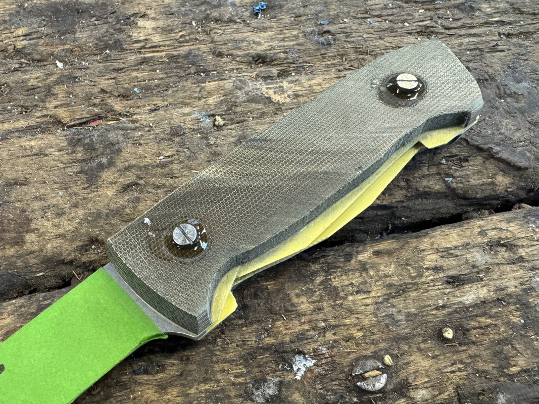

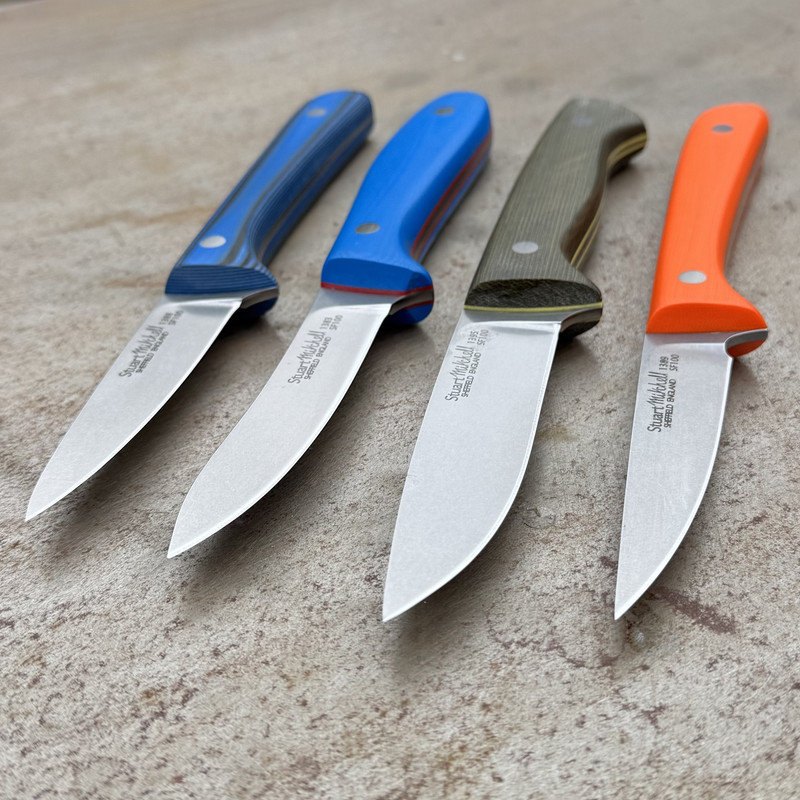

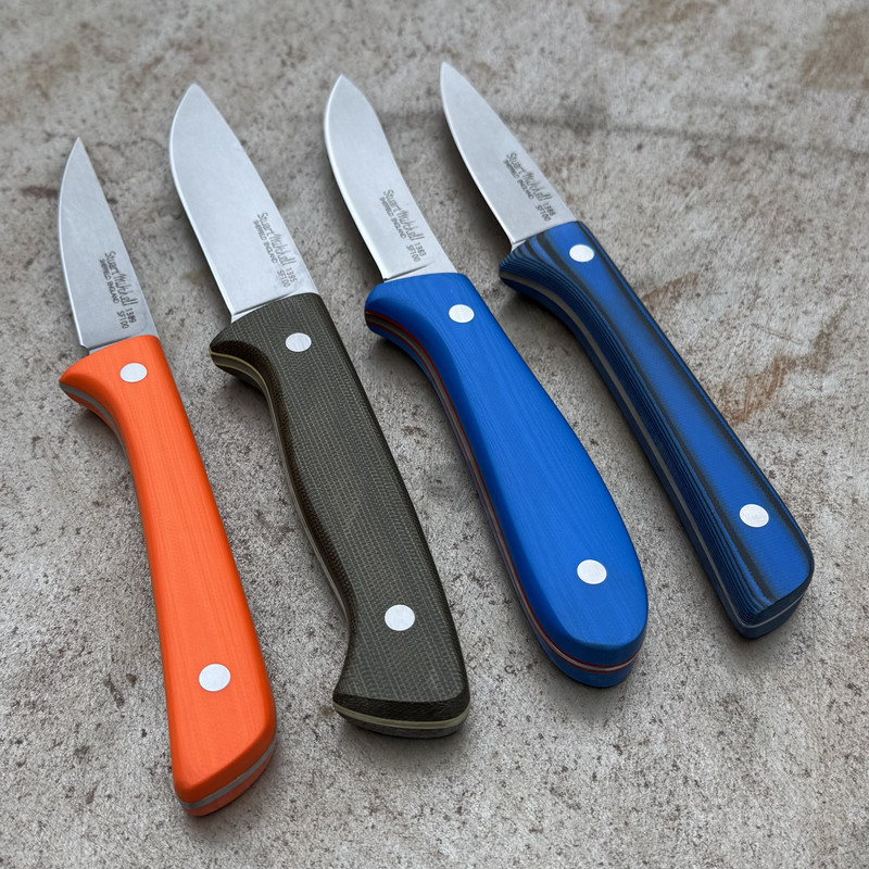

Looks like two sets of bolts glued with cyanoacrylate and one set with epoxy. Is that right? If so, what is your decision maker for using one vs the other? Same glue under the scales too?

All cyanoacrylate there, I suspect that the difference in appearance might be that those photos were taken at different (later) times through the day?
Rather than working on a couple or three at a time through each process, all those builds (as I call them) came with their own challenges, so I did one at a time.,
Yes, same glue under the scales too.

@Stuart Mitchell Knives Are you using only the cyanoacrylate for scales and bolts? Does it offer a strong enough bond? Could you explain the advantages and disadvantages of using it vs epoxy in this context please? I’ve only ever used it in woodworking where I want a temporary or low strength/fast setting adhesion.
I might use epoxy now and again, not very often at all, though. I find the CA much stronger, by a long way. I use two different viscosities, too, thin and medium. I find that thinner stronger than the medium, but there isn't much in it, but you have to be fast with the thin, as it goes off like mad.

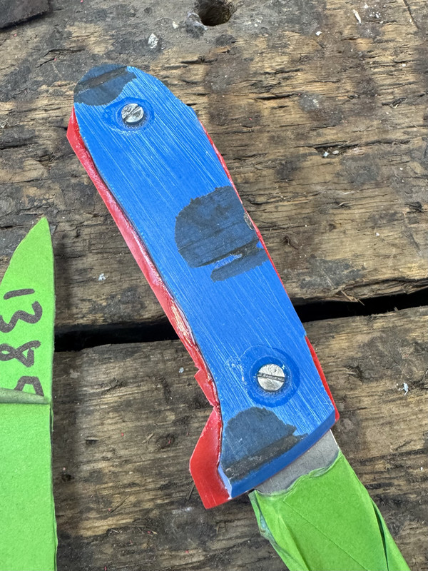

The blue and red knife you see up there, like an idiot, when I bonded the scales to the liners (with the thin CA), I created two RH scales. I know that they would not come apart, no chance, no way. I suspect the G10 might delaminate first. With epoxy, I would have got them apart.
I have actually saved them, took a little thinking outside the box though :)

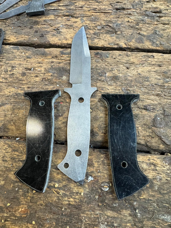

I did a couple of removable scale knives a few years ago. Used 3mm dowel pins for initial alignment. Drilled and reamed through holes in handle and blade. Needed to lap holes back to size after heat treatment as I didn’t have a carbide reamer the right size.
Handles held by two pairs of stainless screws from https://www.accu.co.uk/brand/1-accuscrews
Tried various head styles. M4 Torx countersunk flat was best but countersunk domed were interesting too. Screws fitted into brass threaded tubes that were a snug fit in reamed holes. Had to make the threaded tubes myself. Not an easy thing to find.

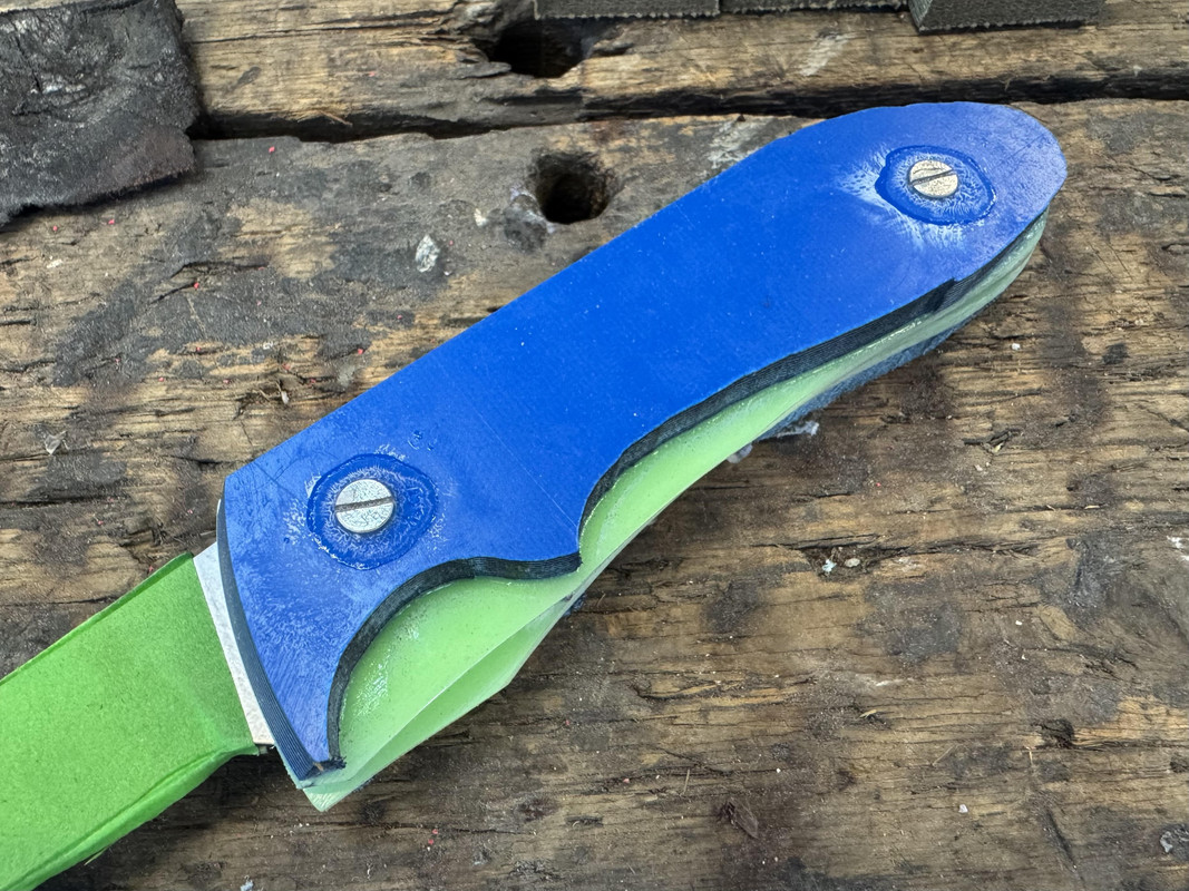

This knife.
Now looks like this.
As mentioned earlier, like an idiot, I glued up (with CA) 2 x RH scales, which isn't going to work, is it?
I was short of blue G10, though, and I knew that that incorrectly fitted liner would not be coming off without causing damage, so this morning that knife looked like this.
Pile side.
Mark side.
Red, blue, red, tang, red, blue. I had to use that incorrectly lined blue scale, so a liner was also applied to the other side.
Obviously, I planned to grind the unwanted 'now outer' liner away as I shaped the handle.
Even at this stage, that red is now less than 1/2mm thick in places, I could not prise that red away from that blue. Nothing else is holding it other than CA. The shoulders of the bolts, of course, are deep inside the blue scale.
