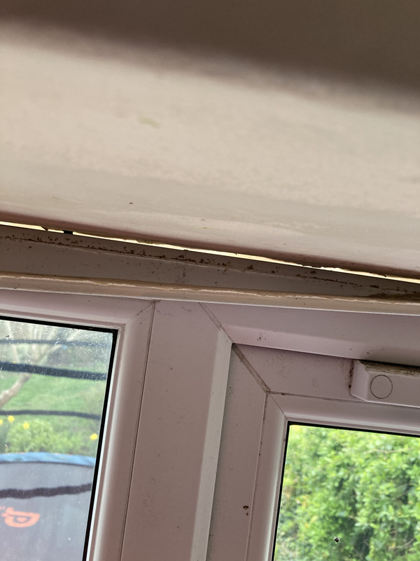

I’m not diy naive but I was quite shocked when I discovered this today in my daughters bedroom.
We’ve been here a year and her room is a struggle to heat so we had been looking to install IWI.
In all the prep, have discovered the ~1.5m wide window has no foam around it. It’ll be rectified tomorrow and will see how that affects the heat!!
I’ve also added checking the rest of the windows to my large list!!
Fitters that do that kinda **** need to have a foam cartridge release into their behind!
