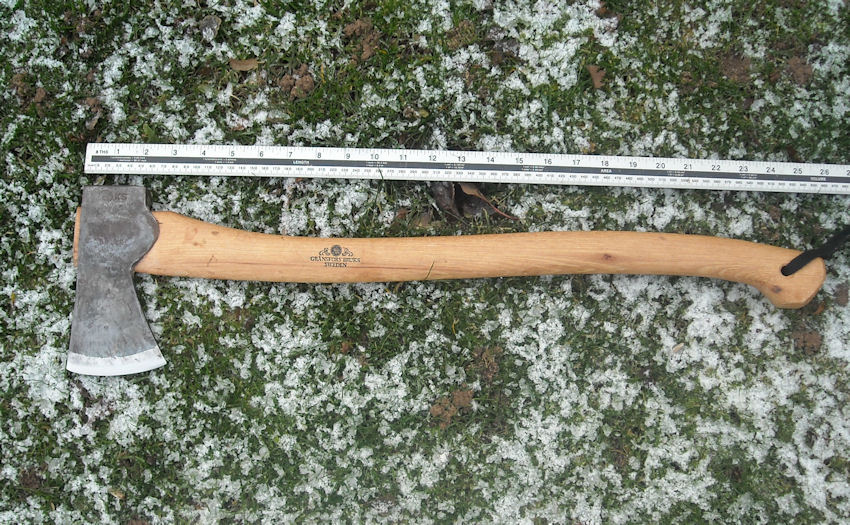

OK, my GB Scandinavian Forest Axe, 25 and 1/2" overall length:

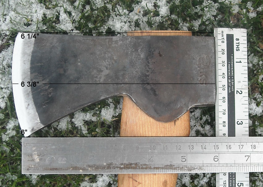

Three measurements from the edge of the bit to the poll:

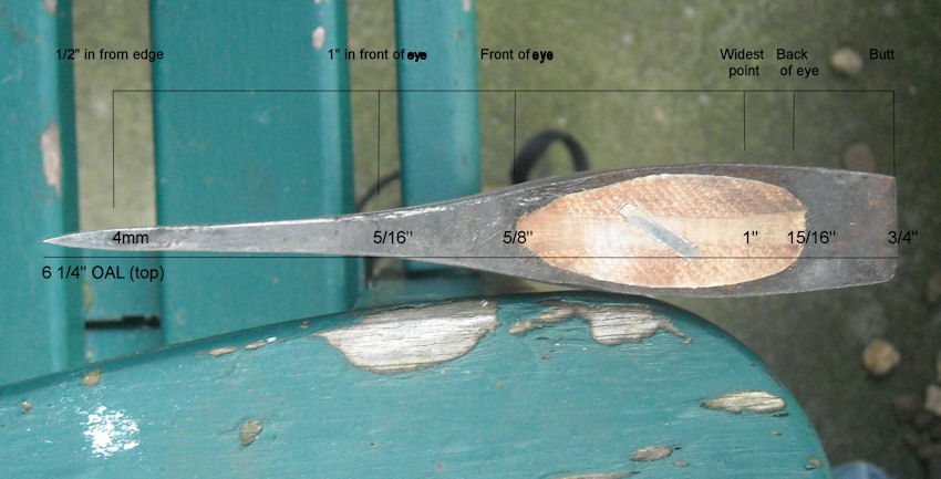

Six width/thickness measurements taken:
* 1/2" back from the edge
* 1" in front of the eye
* at the front, widest point and back of the eye
* at the butt
My apologies for the crudity of the images, but they should serve to give a good basis for comparison against Shewie's new axe.

Camera batts are on charge at the minute Xunil but I've got some measurements for you ....
RM Wilderness - 24" over length
RM - 6", 6 and 1/8th" & 6"
* at the butt
RM -
* 6mm
* 10mm
* 22mm, * 30mm, * back of eye is widest point so again 30mm
* 21mm
Hope that helps mate
Blimey !
Thanks for the dimensions Shewie.
I've just done an old money to new money conversion and basically we are looking at (figures are rounded off for simplicity):
Mine: 4mm 8mm 16mm 25mm 24mm 19mm
Yours: 6mm 10mm 22mm 30mm 30mm 21mm
That's a massive difference in thickness (and weight) and a slight difference in the edge to poll sizes.
Wow !
I'm going to have a think about that a little to digest it. Like others have already said I wouldn't want to cart that around on my back for any distance by comparison to my ScFA but I can see the potential for a lot of extra power to the cut. Why you would need that on an axe of this size is another (quite fundamental) question, and I wonder how it will handle carving given its extra bulk and weight, but you've given me a lot to consider.
Hmmm..........
Thanks again
