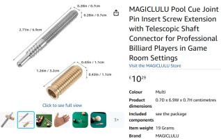

Looking for whatever this is called - I've located the type of thing it is from Amazon as its basically what is used for connecting Pool / Snooker cues together - a Male and Female connector.
I am however looking for a larger version of the same - to allow connection of two parts of wood via a screwed/glued in Male.
As what I have it planned for is somewhat chunkier than a pool cue it an be larger and it could even come with Two male ends and one female connector?
The thing I'm trying to join is standard tool handle width.
Ideas/Links for what this is called from the Tinkerers please. Thank you.
So M10 or M12 size?
You can get threaded bar and internal threaded bar or a few nuts welded together.
Is it a permanent join or intended to be packed down?

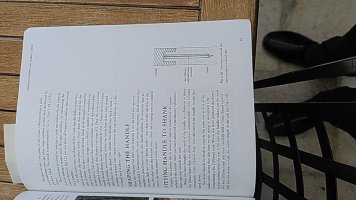

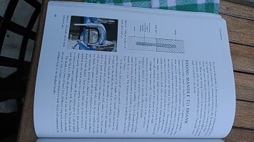

Had exactly the same problem with a similar ‘joiner’, mine was to reattach an antler handle to a walking stick. Couldn’t for the life of me think what it might be called, so I ended up on an extensive search of walking stick supplies, which was equally vague.
