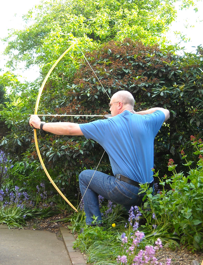

Yours truly, holding about 90lb at 32" draw.
This one isn't nearly as fast as the reflex/deflex longbows, but I wasn't chasing out-and-out speed. It is still very fast by longbow standards but what I wanted was a bow that would throw really heavy arrows for hard hitting bowhunting. It works well with heavy arrows of Ash or Hickory, but it only shoots Spruce shafts well if they are footed with very dense hardwoods, and it has been successfully used on several (overseas) bowhunts for geese and deer.
Hope you like it :)
