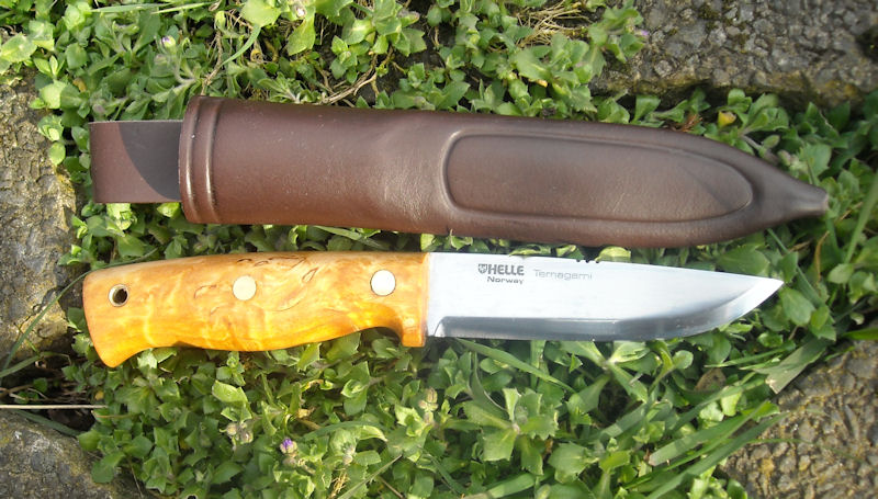

OK, I collected a missed delivery from my local GPO depot today.
I had £26-95 per knife to pay (I had ordered two) but then after paying the VAT at £18-95 plus Royal Mail International Handling Fee at £8 per knife, I was then informed that only one parcel could be found, containing one knife.
Hmmmm...
Two sets of fees - one knife. That doesn't add up no matter how you look at it.
After much searching by GPO staff I left with one knife instead of two and a claim in process for missing goods which, I am sure you will all understand, robbed the day of at least some of its potential :(

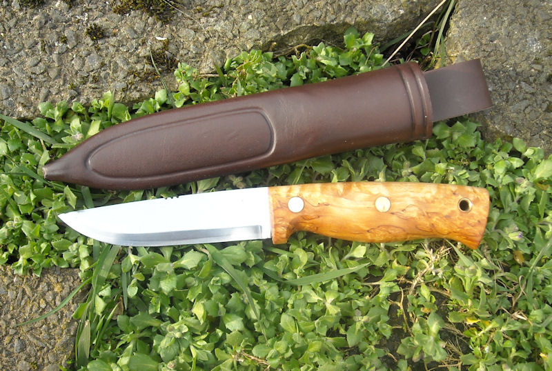

That aside, here we are:

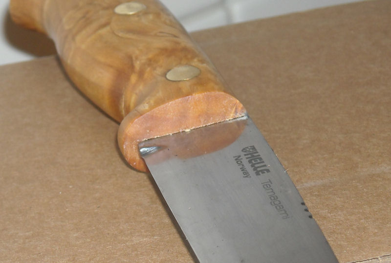

First impressions are very mixed. In size and shape this is a great knife for all round general work. The grip is very comfortable in all holds and the blade shipped pretty sharp, certainly good enough to get to work straight away. The handle material is very nicely figured and well finished.
The sheath looks simple and I guess it is to some people but it is more than adequate and contains a kydex (or similar plastic) insert to protect the blade and to prevent it cutting through the leather, so no prizes in a beauty contest but more than up to the job of working outdoors safely.

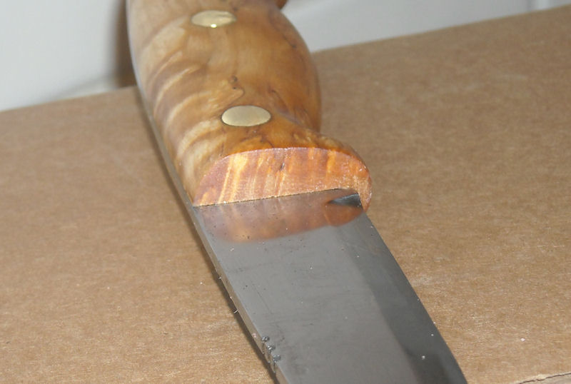

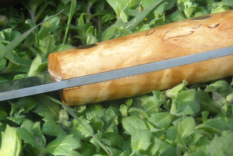

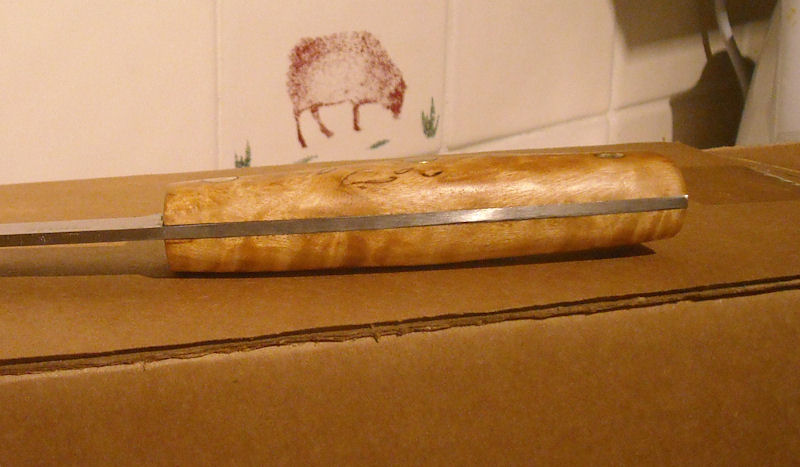

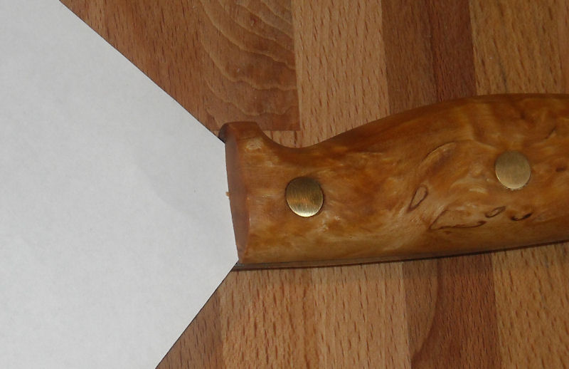

Now, the spine of the blade is slightly proud of the handle material on my example, and if you run your nail over it you can feel it snag quite badly.
More worrying on mine is that it looks like I may have a dry joint at the front of the handle material on both sides of the tang. If you look on the second photo you can see that the tight bond of tang to timber at the right of the image opens up to an obvious gap at the front of the handle. I've not looked very closely yet but it is either a dry joint or a wide joined that has been backfilled with epoxy.
On the one hand I very much like the feel of the knife in the hand and on the other I am disappointed with the fit and finish. I can easily sort out the spine (not that I should have to) but that gap at the front of the handle material is not something I am impressed with. I am going to have a closer look with a loupe or magnifying glass to figure out whether it is a gap or not. If it is a gap it's going back to Helle (as it were :rolleyes:) and it may still go back to them for the overall issues of finish.
Helle knives for the most part are better than this example in my experience, and I am surprised to see these issues on something more expensive than their usual range.
So aside from the issue of a missing knife (some thieving light fingered delivery chappie will, I hope, slip the first time he uses it and do himself a mischief :D) this particular example has some finishing issues that I am surprised passed quality control.
Impressed and miffed all at the same time. An odd combination, to be sure...
I will think about my next move and keep you advised accordingly.

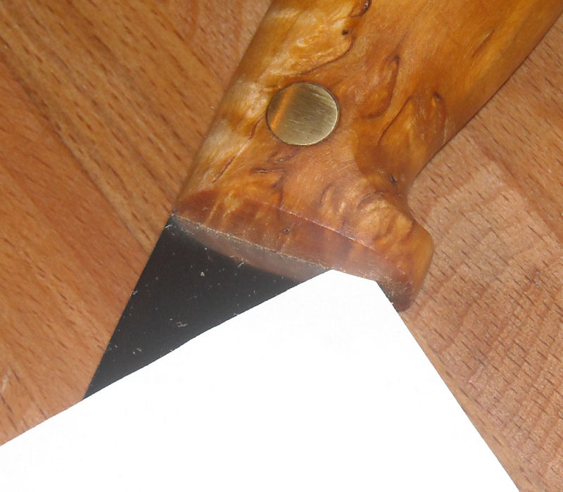

OK, here's what "scope eye" can now confirm: gaps/dry joint.
I had the wrong glasses on earlier to be able to confirm (hence my reference to a loupe/magnifying glass).
This one is going back to Helle and I will chase up the missing, second knife as a separate issue through the GPO.
I know what has happened here: the handle material has been machined prior to assembly and the wood has subsequently moved slightly after the slot was milled/routed or the whole assembly has moved at that end of the grip after glue-up.
In fairness it is not uncommon for this to happen and it is one of the joys/hazards of working with natural handle materials. In fact, it can happen even with stabilised handle materials and I showed another BCUK member only this afternoon a full tang knife with exhibition grade stabilised slabs where both ends of each slab had lifted slightly from the tang. Even supposedly dimensionally stable material can move enough to compromise a glue-up.
I wouldn't ship a knife out like this if I'd made it and I won't accept one in this condition as a consumer, but I am practical enough to admit that this is not a manufacturing fault so much as the very real risk of working with natural materials making itself noticed.
"scope eye" out.
