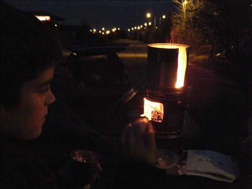

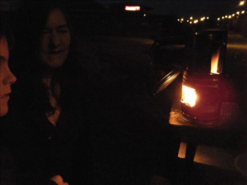

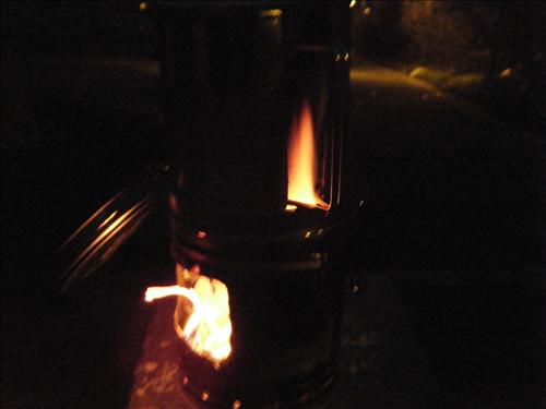

There is a possible flaw in this design.
While the heat shield now inflicts the gases heat right up the sides of the pot, as well as just on the bottom, It now sort of squirts out of the slot when you try to put the cup in, which sort of roasts your knuckles.
Not quite what I had in mind.
More Balls.

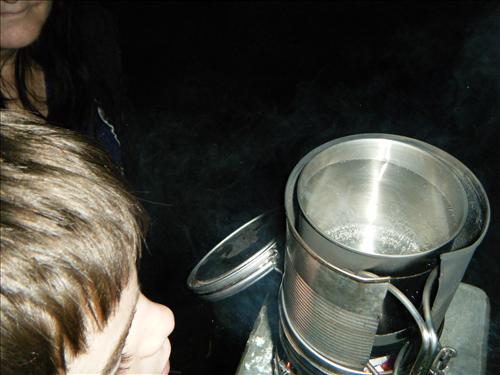

I think the pot would boil a lot quicker if it had a lid...
However, its quite nice.
