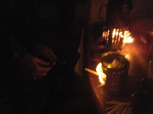

Pepperana arrived on his tour with his mate, who was grabbed of a game of Xbox and promptly disapeared.
Pepperana had a brand new hand built Hobo Stove in his pack.
There was no way we could let him go without testing it!
He put it together on the work top in the kitchen.

However, I had a fray bentos tin lid in my tins for Hobos collection, oh and a pair of scissors...

He took the lid and measured it against his stove body.
He was somewhat surprised you can cut tins with household scissors, but cut slots around the edge and folded it over, to raise the centre and get its diameter down enough it would fit in the stove.
He stood his grate on top of my baby Hobos windshield and drilled his holes with my dremmel.
Seems like he doesnt usually do things like that in his kitchen.

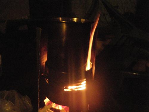

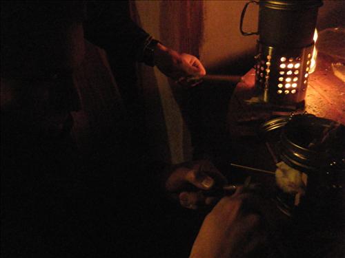

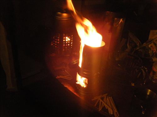

Its alight!

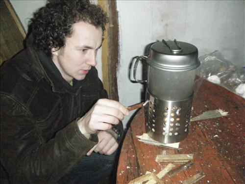

A titanium pot with lid on top of his stainless drainer type body, with a slot cut for refueling and for the handles of his titanium pot to go through when storing.
Oh and his brand new custom built grate lol
It didnt seem to be pulling enough air through the grate, so we lifted it up on blocks to allow it to breathe through the bottom holes in his body.
And I blinded him with my flash.
His mate managed to escape my kids and joined us...
Oh, and borrowed my baby Hobo.

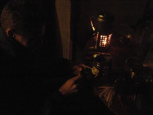

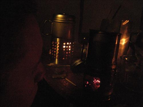

He is stuffing it with makeup remover pads dipped in acetone and some bits of cardboard and plywood I had on the table

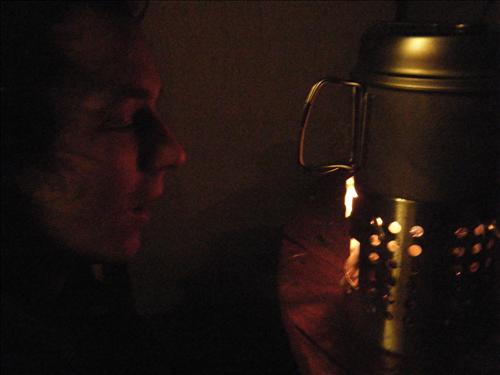

Pepperanas still flaming and his mates glowing

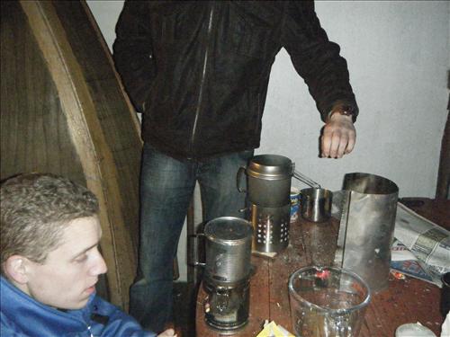

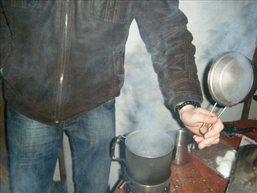

Mine boiled first, so Pepperana tried my heat shield, but felt it made no real difference.
The baby Hobo was taking its time too, although it did start later and didnt have a lid.
Thats the nose of Stupid Idea, my boat project stood against the wall behind Pepperana.
Pepperana boiled too.
Tralaa!
We all had hot chocolate and waited for baby to catch up.

lol good old mc donalds carboard for fuel again.
We were also using the wooden tea stirrers out of the resturants for fuel too
I think thats what he is poking it with.
