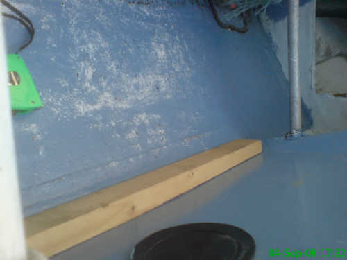

I stood it on this bit of 2x3 and pulled it.
That wasnt The most successful Idea Ive had.
The mast sort of lurched forward, the wood collapsed and the end of the mast went straight through the boat.

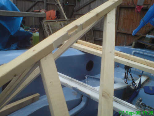

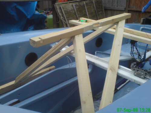

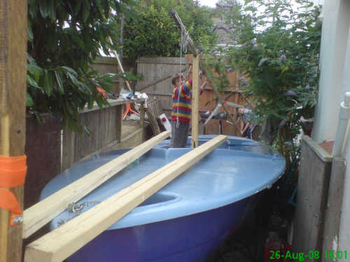

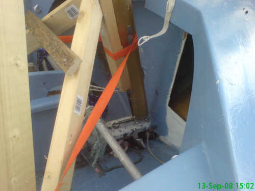

I decided I needed a cradle to lift it and it needed to lift from the floor here.
and up to here...
The angles on it were a real pig to get right.
This was what I wanted to try next.
Well, it sort of looked like it might work...
Famous last words....
So....
with some trepidation....

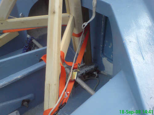

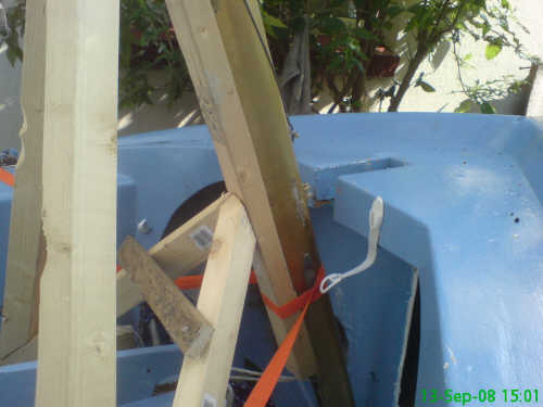

I strapped on the mast...
It still looked like it might work...

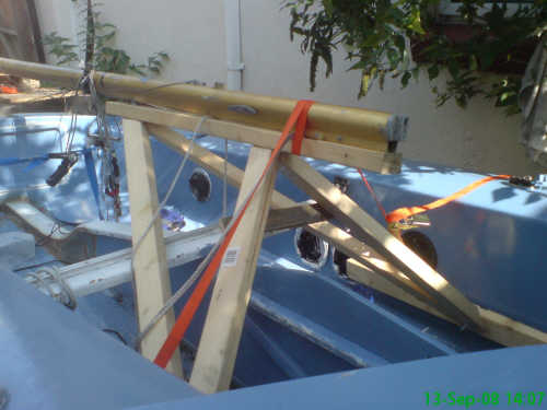

Time to put it on the boat..

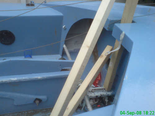

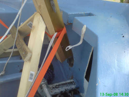

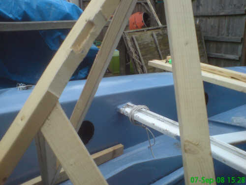

I stood a piece of 2x3 on top of it and tied the trailer winch over it and down to the top of the mast.
Sort of..

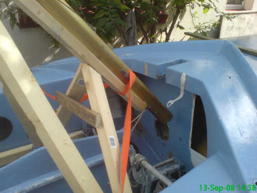

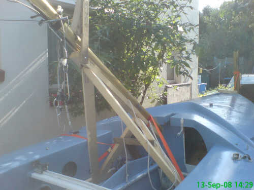

Winding on the mast handle did this....
Nearly there
It hit the bulkhead and needed shuffling a bit, but it looked workable.
It didnt feel that stable, but anything was better than how it was supposed to be done.

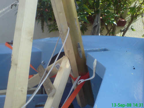

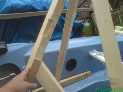

Tried it with more mast under the bottom of the lifter...
This was better, but needed playing with to find the right place.
Having got it this far, a good yank on the winch cable and it went in.
Its on its metal runner - the mast step.

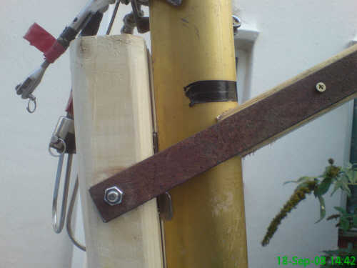

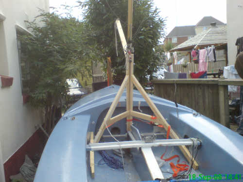

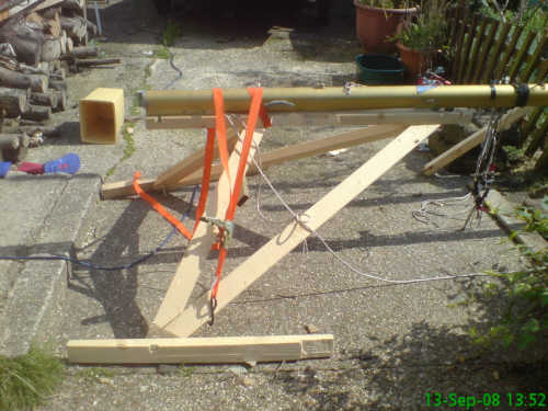

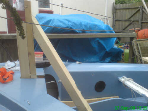

I took the whole thing to bits and started again with two bits to go along the mast, bolted together, so I could strip it down to put it in the car.
I made the build a bit tidier this time too.
I drilled a hole in the two bits for the pin the boom sits on to go through the lifter so its easy to set its height.
The pole stuck out the front takes a wire thats allready on the mast from the spinnaker so fitting the winch cable was simplified.
A bolt held the pole on the lifter.
Easy.
It was a nightmare to design and a real pig to build with all those angles to get the mast to lift between the centreboard handle and the bulkhead, while standing on the floor...

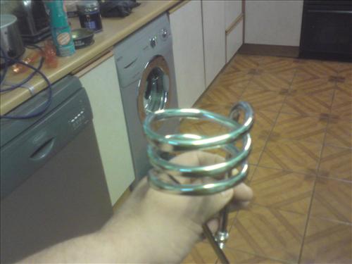

Another piece of pipe...
I bought two more rubbish pieces - rather than risk the nice ones Ive been given...
Just as well...
This one kinked and Ive messed up by running the vertical down the outside, instead of through the middle.
No Idea how Im going to do it how I need it.
Still....
Another squiggly piece of scrap.
Irritating at £5 per go....
No more potato thing until I work out how to bend the pipe properly
I think I need to make some type of former that will bend it tight enough and also stop it kinking.

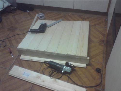

We built this....
Struggling with it as it sort of warped...

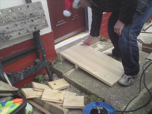

Still, this does work.
Some spacers....
