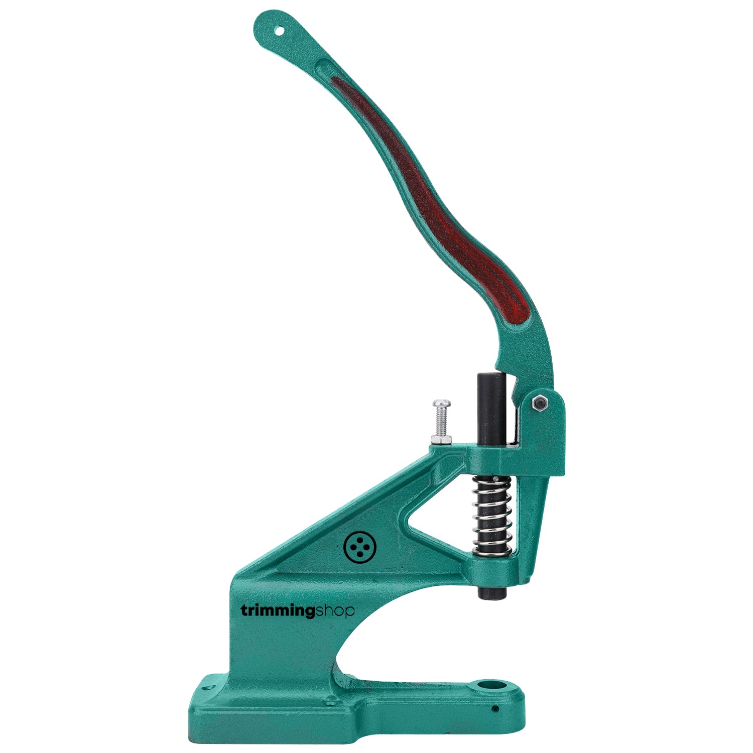

A hand press, something like this? This is just one a search brought up.
Reactions: Toddy and slowworm

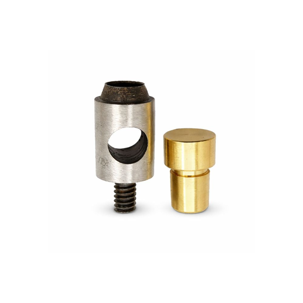

I've seen them and could probably just use the dies. But, I would expect it to stay sharp for a ling time cutting against the brass plate?
Jared
Sep 8, 2005
3,569
745
Yeah, brass to reduce wear on the cutting die.
Don't think it'd be too hard to resharpen the cutter, when does dull.
