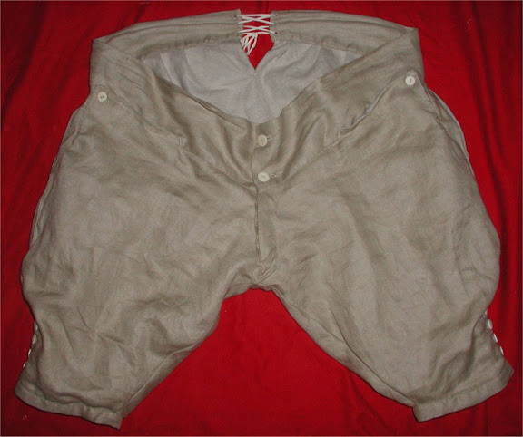

These have been by far the most difficult things I have made but they re now finished.
It's been a real learning experiance.
The pattern makers at first said they were happy to advise, then never actually did so i had to muddle through myself.
They are remarkably warm and comfortable, so warm in fact i intend to make a unlined all flax linen pair with out the side pockets, which will be a doddle after these.
Things I learned
Russian Drill hemp is a pig to sew as it frays like billy-ho. When sewing the 17 button holes after I sewed the perimeter lines of stitching I smeered a little bit of glue where I was going to cut and let it dry, this made sewing the edges much easier as they frayed like mad as you tried to whip stitch over them. This occured to me only after I'd done all the top hlfs button holes.
The waist band is too floppy for a man of my extreme lardyness, the next pair i will add a iinne waist bely of something thick and stiff like hessian. I'm going to add some belt loops to the lined pair which may not be authenic but at least they will stay up.
A magnetic pin cushion is a god send, normally the family are picking neeedles out of their feet for weeks afterwards but not this time!

The lining material is Irish linen, herself got me a roll with 11 yrds on it from a rag trade place in Manchester, a bargain for 30 quid and it passed the burn test so its kosher stuff
The pattern says 1730-60s and is based on British and Colonial American examples. The materials, unbleached hemp and flax and bone buttons are appriopiate to the working class/small farm holder.
