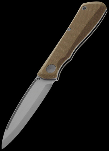

Gerber Mansfield slipjoint scandi grind. Bought one on recommendation. I'm no knife expert by a country mile but this is by far a fantastic unbelievable quality D2 knife for sub £20, dont say i didn't tell you

Heinnie shows blade length as 8cm, which might be the same as needing to grind off 3.8mm of length from the tip, which is a lot without power tools. However, it is possible that if you go by the letter of law, it looks like the cutting edge is shorter than the blade.
Personally, I won't go near a D2 Scandi with a 10 foot pole. I posted about this a long time ago, and know that some people with diamond stones thought that working a big single bevel edge in abrasion resistant steel was no problem. I have diamond stones, and a grinder, and on a Scandi I want high edge stability, which comes from fine grain and small or few carbides. D2 is noted for large carbides and abrasion resistance. I have a D2 Swamp Rat and it cuts like crazy, but after needing to flatten bevels of a D2 Spyderco/BushcraftUK proto, it has put me off the big bevels in that kind of steel.

The market for a slip joint bushcraft knife at *over* 3 inches must be...... small?
If it was sub 3 inches, I can see a fair few people "taking a punt" at £20.
But on the assumption that the law is your main concern (otherwise, why bother with a slip joint when a fixed blade is likely the better option), needing to spend time grinding away to bring it under 3 inches feels like a hassle....

Interesting design, I quite like it. Be interested to hear what you think.
I always thought D2 was stainless though but it has it listed as carbon. Have I missed something?? :news:

It tends to be called semi stainless. It'll go orange in a sweaty pocket and get a patina if you cut fruit for instance.

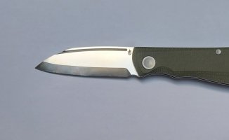

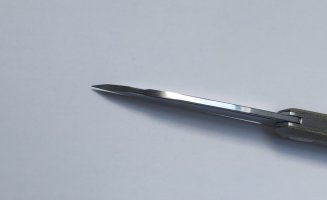

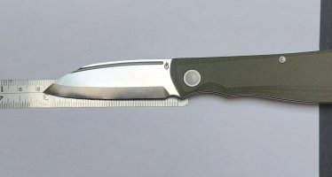

Well, I went and did it.
I didn't feel like trying to continue the Scandi Grind, It looked like it would be very easy to make a hash of it.
So, I started out as well by using my calipers to mask out the line in the knife.
I kept a pot of water nearby and quenched the blade whenever it stated to bubble.
Pic of how it ended up here.
Overall, Part of me feels I have "Lost" something about the aesthetics of the knife.
But, Compared to one of my other UK Folders,
I at least enjoy the bigger handle.
