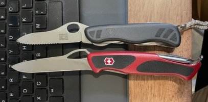

I’m not sure if this will be of any interest to anyone but I thought I would share impressions of my favorite knife, the Victorinox Soldier's Knife 08 (bottom). This is the actual model which is currently issued to all Swiss and German soldiers. I’ll also compare it to another popular Victorinox model, the Hiker (top) which has an almost identical tool set but only costs £30 compared to £50 for the Soldier’s knife.

As you can see from the photos the Soldier 08 is larger than a regular sized SAK and feels a bit more durable as a result. It has an ergonomic shaped handle which is more comfortable to hold and the plastic scales on the side are made from a gripy non-slip material which is helpful too. Compared to the Hiker which weighs 77g the Soldier's knife is almost double the weight at 131g but this difference feels less noticeable in the hand than the numbers suggest it should. However it does feel significantly larger and the curved shape fills the palm much better.
The blade on the Soldier’s knife is an unusual one. It’s a regular straight edge for the first one-third of the length then changes to serrated for the last two-thirds towards the tip. The tip is also slightly rounded rather than being a needle point. This sounds like a terrible design and to be honest I would still prefer if it had the non-serrated blade from a Victorinox Forrester M Grip but the one it has still functions well and the serrations probably do help slightly when cutting cord.
The blade also has a handy thumb loop which enables it to be opened easily with one hand. It’s a locking blade and the mechanism is optimized for left rather than right-handed use when closing. This works perfectly for me as I’m left-handed but it will make it slightly awkward for anyone wanting to one-handed close the knife with their right hand. I’ve seen a Youtube video showing that it can be done but it’s definitely easier with the left hand so that's something to bare in mind if you’re right-handed.
The blade has a 1mm micro-bevel which has only been ground on one side (the right side when viewed from above). This it makes slicing slightly easier when the knife is held in the right hand rather than the left but it does still work well enough in the left hand too. However as I’m left handed and always hold it in my left hand I've now added a second micro bevel of about 0.25mm on the left side of the blade by swiping a chefs steel down it a few times. This was dead easy to do and only took about 60 seconds. After having done this slight modification it now slices equally well with either hand so is something I suggest worth considering for anyone else who owns this knife.
