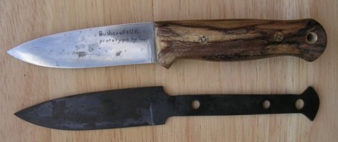

A mortise tang works well!
Reactions: C_Claycomb

That's a neat Finish on the grind, something for me to aim for the next time.
Like the shape of the Handle.
Thanks for the picture
