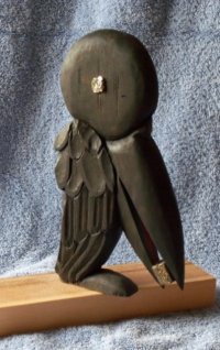

What do you expect for matrix? Here, it's a very hard and stratified shale or slate like sedimentary rock. We can chip it open in sheets. The local iron pyrite "Fool's Gold" appears in cubic crystals, 3mm/side to 15mm/side. But you have to bust rock all day to find those.
This one is about 15mm on a side. Maybe next pic is the deposit of origin.
