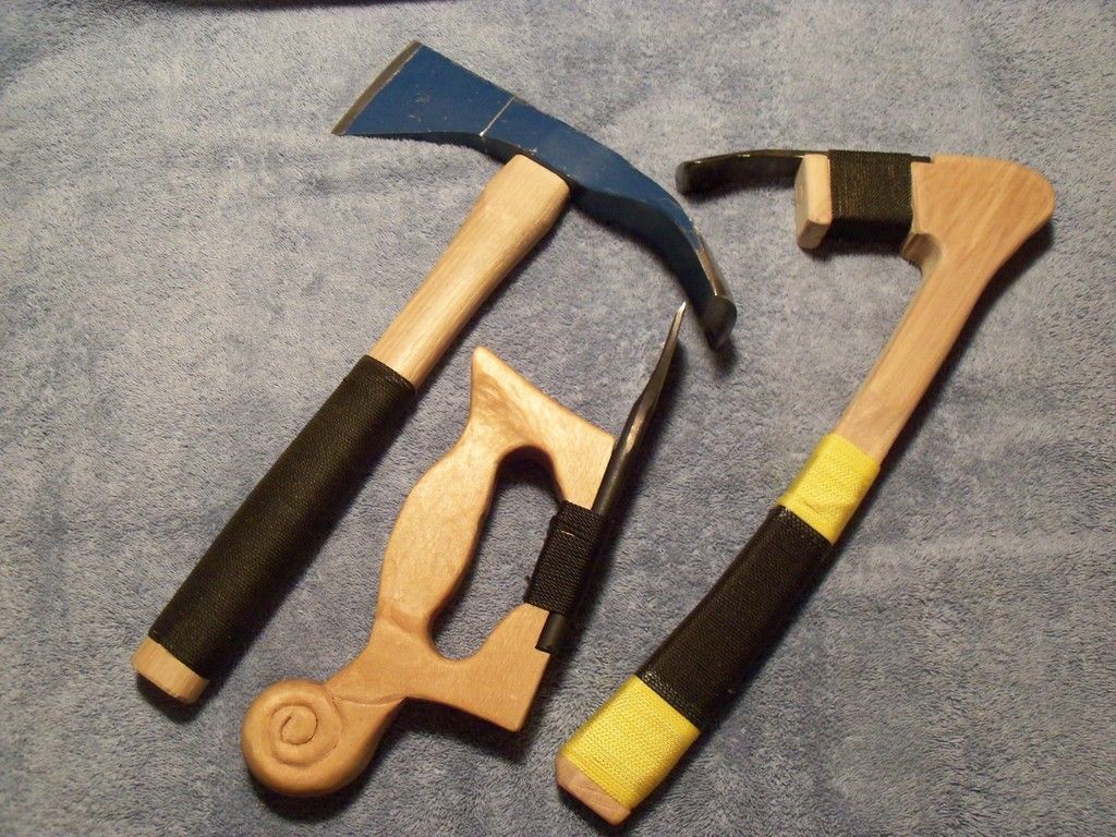

Change to the adzes and the crooked knives used by the magnificent carvers of the Pacific Northwest native community.
Now the tool is stationary and you have to move the abrasive in a very controlled fashion.
Time to relearn most everything. After 5+ years of this, I'm beginning to get it right, most times.
Then, you can modify farrier's hoof knives into perfectly acceptable carving tools, scorps included.
The adzes are really awkward to sharpen and hone, not much wiggle room I buy the blades and all the woodwork is mine.
The blue Stubai is a factory handle.

Robson Valley. An impressive array of tools with excellent woodworking skills shown in the handles. I'm with you on the soft leather front. I use thin leather on hardwood surfaces on homemade strops to avoid the give which wraps itself up and around the edge causing rounding of the micro bevel. I've used card, newspaper and cardboard too. As you say its the compound that does the work but I am getting marginally better/quicker results on MDF lately unless its my imagination!. It cleans nicely with a little oil too to get the steel residue out bringing the MDF back to almost new. I'm still very new to all this but my god I'm learning day by day. Anyway your suggestions and advice have been taken on board. Thanks very much. ATB. Pete.

I'd been carving with the conventional gouges for quite a long time.
I was sharpening edges for other people.
I was very well taught freehand sharpening in the beginning.
Then I began to wonder what was so special about the crooked knives and adzes which are so popular in the Pacific Northwest.
I labored under the false assumption that PacNW carvers made their own tools until I watched a native using Mora #171 (left hand pair, pic #2).
Change the bevels from 25 degrees to 12 degrees and get busy. Since then, I have revised maybe 15 farrier's knife blades.
I show these because they forced me to totally rethink how I sharpened and honed edges. I did that, successfully.
I think it's about 1/3 or more of what I needed to learn to have a really fun time making chips.
Then, I found a video (transferred from 16mm film) of the very old Kwakwaka'Wakw native carver, Mungo Martin.
Sharpened his best crooked knife with a rock and a bucket of water!
