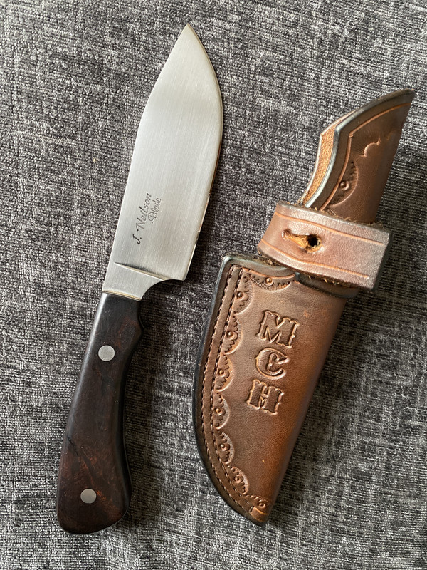

Great job you did :) Here’s on I did ooohh, must be fifteen years ago maybe. Blade is by J. Neilson, Forged In Fire judge. I fitted the Desert Ironwood with stainless Corby bolts. The DI has gone really dark over the years. One I’ll never sell ;-)
lovely!
I don’t think I will ever sell this one, due to the circumstances what brought about it being made (lockdown lol)
