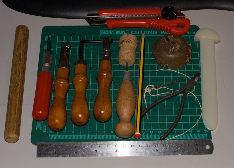

I have just started doing Leatherwork courses for people (outside my magazine work) and as such have built up a set of tools.
Each student gets their own set of tools to use comprising the following.
A3 Cutting mat (yes i know the one in the pic is a4 ;) )
Wooden slicker
detail knife
stitch marker
edge beveller
stitch groover
awl
pencil
wax
needles
pliers
plastic edger.
They also get access to shared tools like the heavy duty knives, rulers, other edgers, hole punches, stamps etc.

shopping around and using different suppliers as well as using discounts due to buying several at once, I think its about £60 per student. Was a bit of an investment to be honest and hopefully it will pay back, otherwise I will have to sell them.
Tandy do a "deluxe hand stitching kit" for £66 but it doesn't contain all the same tools. Though it can be had at discount for around £40. I did work with the identity store on producing some kits to sell at my courses but you really need to shop around and source from different suppliers to keep costs down. Also not every supplier sell the tools I like. The awls I like for example are only sold by one supplier.

From real life I think Bardster has got it pretty close on the tool front
Take away the tools you probably already have and you are left with specific tools you will use
A3 Cutting mat (yes i know the one in the pic is a4 )-use a chopping board
Wooden slicker-A bit of wood
detail knife-stanley blade or penknife sharpened
stitch marker- possibly but a fork or steel comb will do
edge beveller-Required
stitch groover-required
awl-againi its easy to improvise but Yes nice to have one in the kit
pencil-you know the answer
wax-cheap enough but again put it in
needles-easy to get but put them in the kit
pliers-oh come on
plastic edger.-well its lovelybut I think we can improvise here lol
So that means
we need
edge beveller
stitch groover-
awl-
Beeswax
needles
Linen thread
A nice pouch or container
That makes a starter kit
but I think good info on what and why you need it; is invalueable and more relevant
Hope this is helpful as its meant to be
