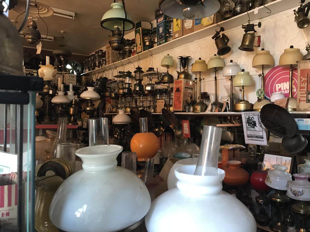

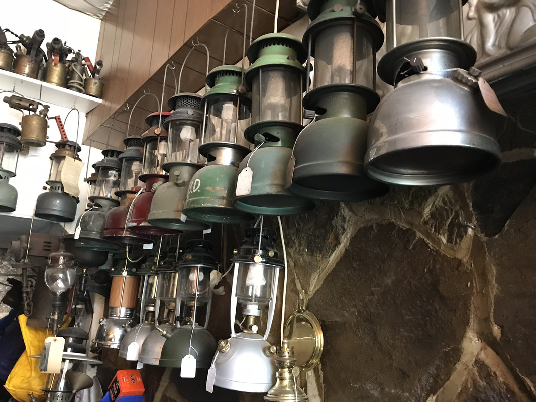

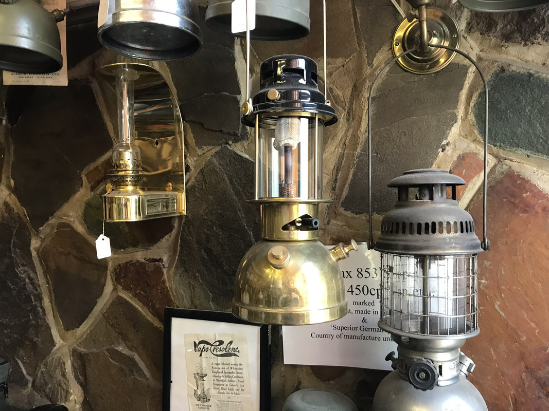

Having visited an Aladdin’s cave of a lamp and stove shop in Littlehampton, the owner and his wife being obsessed with stoves, lamps, lanterns, petrol and paraffin clothes irons etc, I can tell you running the correct mantle is crucial for the lamp. My Vapalux had apparently been run for years on Tilley mantles. He explained they shrink further than the Vapalux and cause the vapouriser to get too hot. Over time it causes damage.
He was also very helpful on the merits of Coleman fuel over panel wipe. It isn’t the same, and again will cause damage. He says Aspen Blue is identical to Coleman fuel and recommends it. Not particularly relevant to your question, but worth knowing.
Just a few pics so you can get an idea that these two folk probably know their stuff.:artist:

Wow nice 65 what an aladins lamp of a place.!what's the name of the shop? The place I contacted had only clip on mantles which are fine but expensive in comparison to the tie on ones. I also want to get some more spares such as glass and generator pump seals etc. This place looks the bees bannanas. I prefer to buy from shops rather than interweb. You can realy get propper info from a knowledgeable shop keeper.
Here you go. It’s a fair way from Exmoor. Bit of a strange place, google it and check the exterior. I had to phone them because I was standing outside a boarded up hairdressers and couldn’t see the shop. It was the shop. :D

Thanks buddy I will phone them. As you say it's a bit far away from me but good to know about if I was ever in the area. I'm sure others will find this information useful too. :beerchug:
If you give them a call you’ll get good advice and should be able to mail order what you need. They love talking stoves and lamps, you’ll have trouble getting off the phone.
