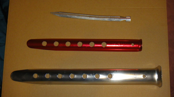

Alpkit - £15 for 4 posted ?
http://www.alpkit.com/shop/cart.php?target=product&product_id=16627&category_id=253
ex-member BareThrills
Dec 5, 2011
4,461
3
United Kingdom
If your going to get sand/ snow pegs the MSR ones are better suited to using as dead men as they are drilled with holes unlike the alpkit ones
