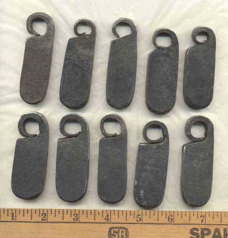

I made up these flint strikers for a flint knapper friend - to share with his buddies. They are THICK (5/16 inch THICK!), 1 inch wide and right about 3 inches long - and the bottom end has all the edges rounded and smoothed over. He and his buddies found out that they work great as a flint knapping baton when oot-n-aboot. But they only use them when they don't have their regular flint knapping tools. That THICK metal gives these strikers the strength to hold up to the hammering shock without breaking/cracking, and the mass helps with knapping technique. So now he and his buddies carry around their flint striker, and also have a knapping tool along to touch up flint edges. (But they still prefer their copper tools)
The hardest part of making these was how to hang onto them with tongs while forging out that little curl. I also made him/them some that were completely solid and rounded at each end but with a little hole drilled/punched through for a lanyard.
I haven't found any historical documentation for this particular style/shape, so these are more of a modern interpretation.
