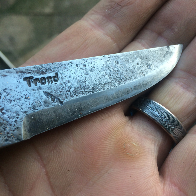

Hopefully this shows it well enough - a real scandi grind!
Part sharpened so starting to flatten. I think this shows why folk want it pre flattened as it's not the prettiest look in this state.
Reactions: 0000 and Janne
Yes it does cheers! I'd never heard of that before. I'd maybe have called it a hollow scandi or something! Yeah I can see that the centre of the bevel isn't being touched by your flat stone. Very cool my man! Also, nice ring!
