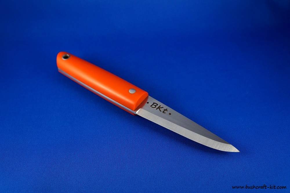

BogdanS makes a nice little puukko called the Beaver, not overpriced and might suit your needs.
http://bushcraft-kit.com/
This was mine. Not very traditional in looks, but with a wooden handle it’s a nice modern take on the style.
