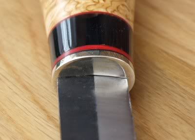

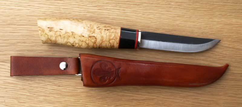

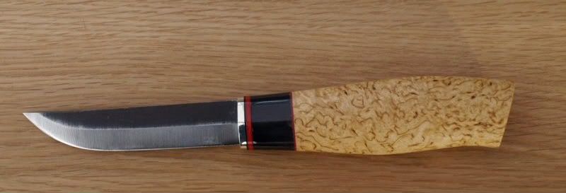

Here is my twelth knife and third commission for a Scout Leader on another forum
Quite simple a Lauri carbon 95 blade and factory bolster Handle is masur birch and buffalo horn with red fibre spacers
The sheath is wet moulded half tanned leather

Very pleasing bit of work there, Brancho. Masur Birch is beautiful wood. What did you use to finish the handle? Also, does it take more pressure, compared with veg tan, to emboss the design on the half tanned leather?
The hanlde was soaked in danis oil for a couple of hours any longer may have darkened the colour based previous experience. Then I applied a coat of carnuba wax with a polishing wheel. The Bufflalo horn was taken down to 1200 and polished with a mop and some polish
Needs the same pressure really.
The design is not as deep as it would be on 3mm veg tan because this is 2.5 mm and I had burnished the area before stamping it which was a mistake. Half tanned leather is very stif when dry but mould and takes a pattern well when wet.

Is there anything in particular you dont like about the sheath ie the style or do you feel it dosent flow right. BTW your comments are welcome.
Hi alf its the style and the shape just don't look like it will stand up to that superb knife. is there a plastic sheath in side the leather sheath. it looks like the knife blade will work its way through the leather.you have made other top quilty sheathes that would suit that knife better. still that my opinion if your happy with it that's all that count cheers:You_Rock_ stanley
Thats a lovely bit of wood. The knife looks really well put together and that handle shape,,,,well,,,,, you just know its going to be comfortable.

The sheath has no liner and due to the construction and leather type use (half tanned leather has a rawhide core) it does not need one the leather is ver very stiff. Unlike other sheaths though you can put another knife in it even temporarily as it may cut the sheath
Look HERE to see how it was made DKW did a great tutorial and I have added some bits. The Scandinavians trust this style so do I:D
