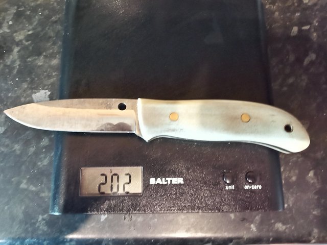

Spyderco Bushcrafter reprofiled to a sabre grind and replacement reindeer antler handle on a full tang, 202 grms. This sits so sweet in my hand that since I had the work done on it I've not looked at another knife :)
Having said that I do like the look of your Spyderco Proficient Chris, I'd be interested in seeing that if you bring it down to the moot this year.
