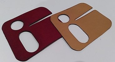

It's taken me a long time to reply, but here is a bit more info for you.
My machine is a SculpFun S9 with a claimed power of 9 watts (claimed to be equivalent to 90 watts, but that is just plain wrong) and work area of 410 mm x 420 mm.
It will cut softwood up to around 8mm thick if I program it to make multiple slow passes, but it's better to use thinner material, if you want to cut. Engraving works by burning the surface, while cutting is burning all the way through, so in reality the two operations are the same but with different settings for power, speed and number of passes.
I mentioned cutting leather and not needing to burnish the edges afterwards.
I made a finger tab for archery by cutting out a prototype with a scalpel, nibbling away until it was comfortable on my hand. I scanned that prototype and transformed it into a drawing in LightBurn. Then I used LightBurn to drive the laser cutter to cut two examples, shown in the photos below.
