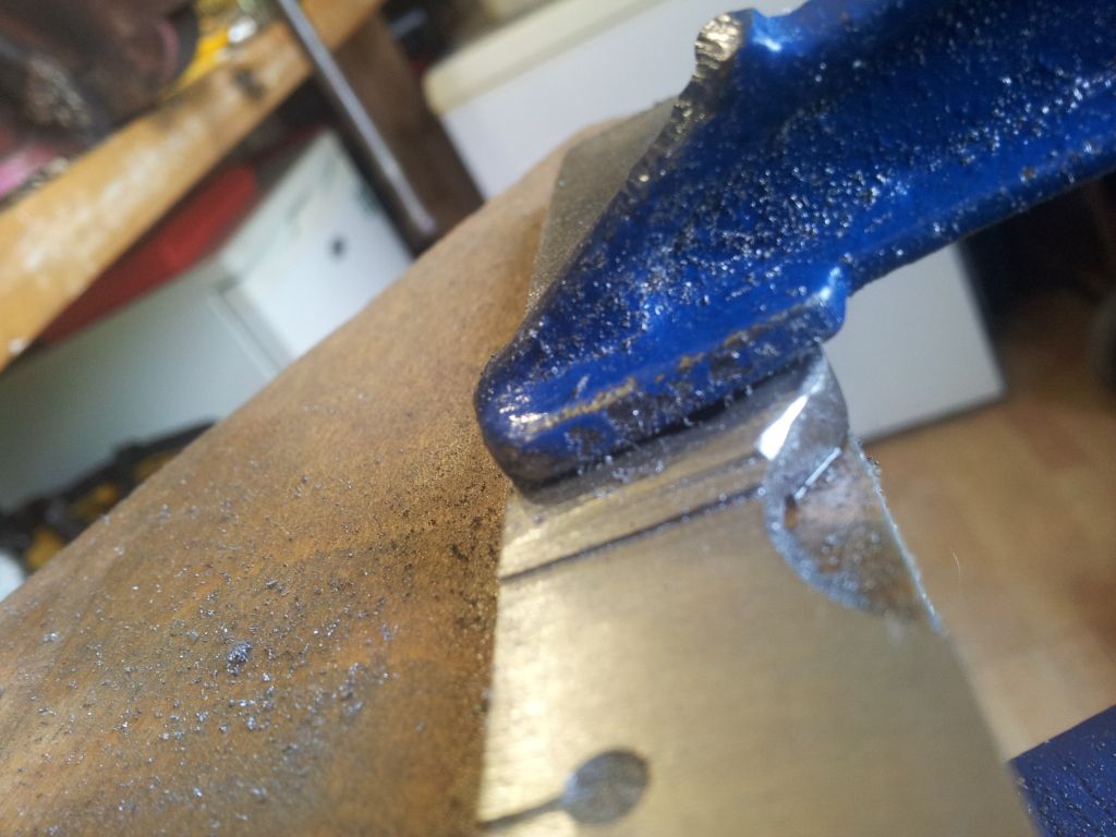

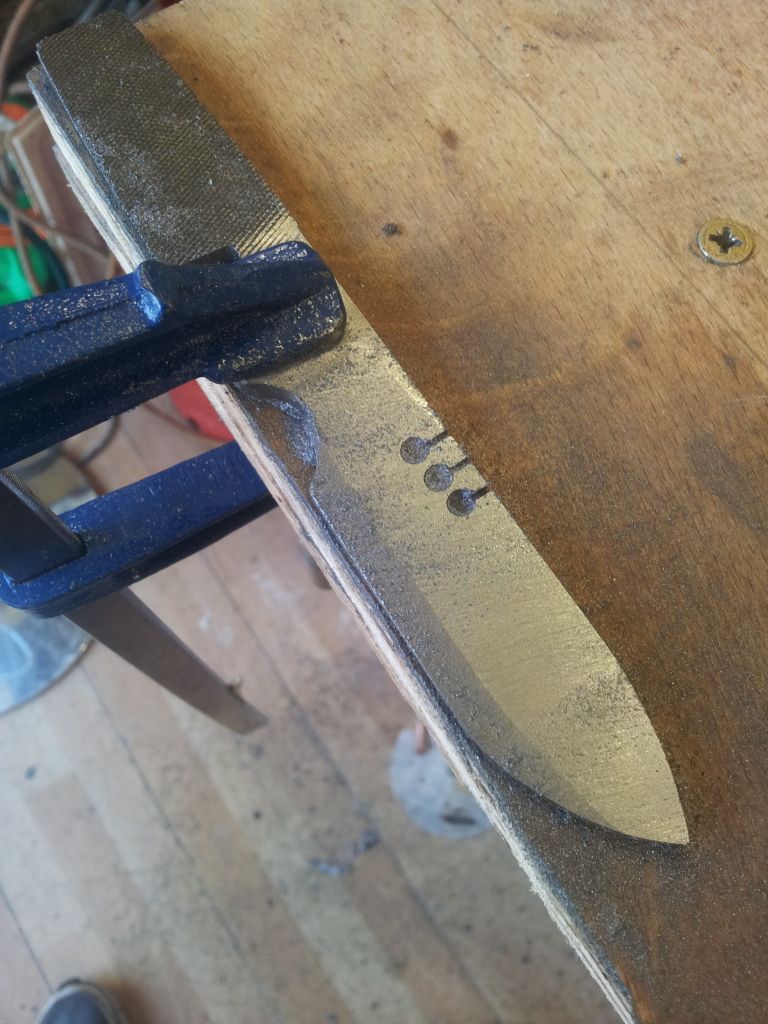

After all my talk of tools , I have now decided to keep it simple and build a filing jig , As the knife is so thick (5.5mm) its gonna take a while, but thats fine. Im enjoying the tinkering about . Im gonna file from edge to edge with the two thicknesses of ply set up , and then remove one for the final grind so it's slightly steeper

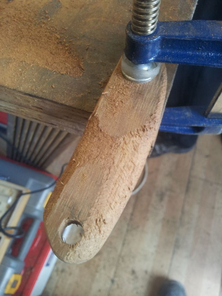

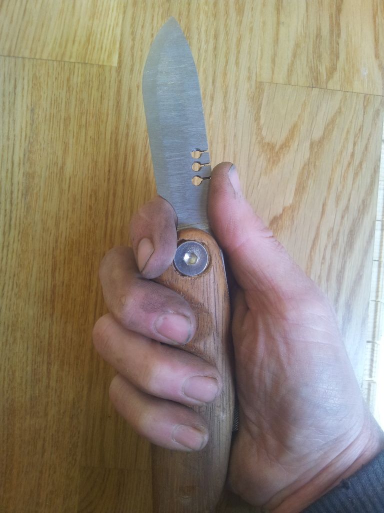

Few pics of my first scale making experience,Lets call it a TEST RUN for the final product. However it has turned out to be a futile exercise and a total waste of time...Well not a total waste,I've learnt quite a lot form it, like how to make sure the blade is only sticking out 3" instead of 3.5"
Heat treating tomorrow me thinks ...But for now I think I will look for sympathy for my stupidity in the bottom of a bottle of beer
The blade is always the easy bit! My advice is make a template, and having failed a couple of friction folder handles my template heleped me get it right for once!
Its helped me loads deciding what I want it to eventually look like , I realised early on it was wrong but stuck with it for practice and to see what it felt like to use, Got a bit carried away with the "Jimping" (didn't know it was called that ) But it feels nice to hold the scales just need to be shunted forward 1/2 and inch , the main fixing bolt is a bit messy too where the drill wobbled
I will make a template now I know what i'm looking for , Also discovered I don't need a pin to stop the blade (as in a peasant knife)as the file sits into the cut out nice and snug , and Im gonna make it shorter at the back , and this time the wood wont be given its beautiful finish with WD40 either
lol my advise with the fixing bolt/pivot is to use th drillbit in the hand. Do not use the drill, simplyhold the drill but with your hands. That way you can deliver a clean and controlled cut for the hole. Infact I would use a smaller drillbit than the diametre of the bolt thing, then slowly try and test when filing to get that perfect snug and tudy fit.

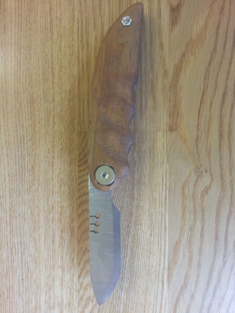

Im a lot happier with these, Now I have a legal 3" blade and its a lot less bulky than it was, it still feels a bit thick to hold ..think its gonna be a toss up between strength and grip. If I make them too thin I think they might break . The only other options I can think of is to have a play with some denim Micarta (not sure how strong it is ) or glue stainless steel to the back the wood scales
I still need to finish off the grind a tiny bit , then it will be ready for quenching and tempering some time next week ....oh this is so stressful
Really need to get this done, I think the universe is conspiring against me....I have been stricken with the terrible condition that some call decorating.

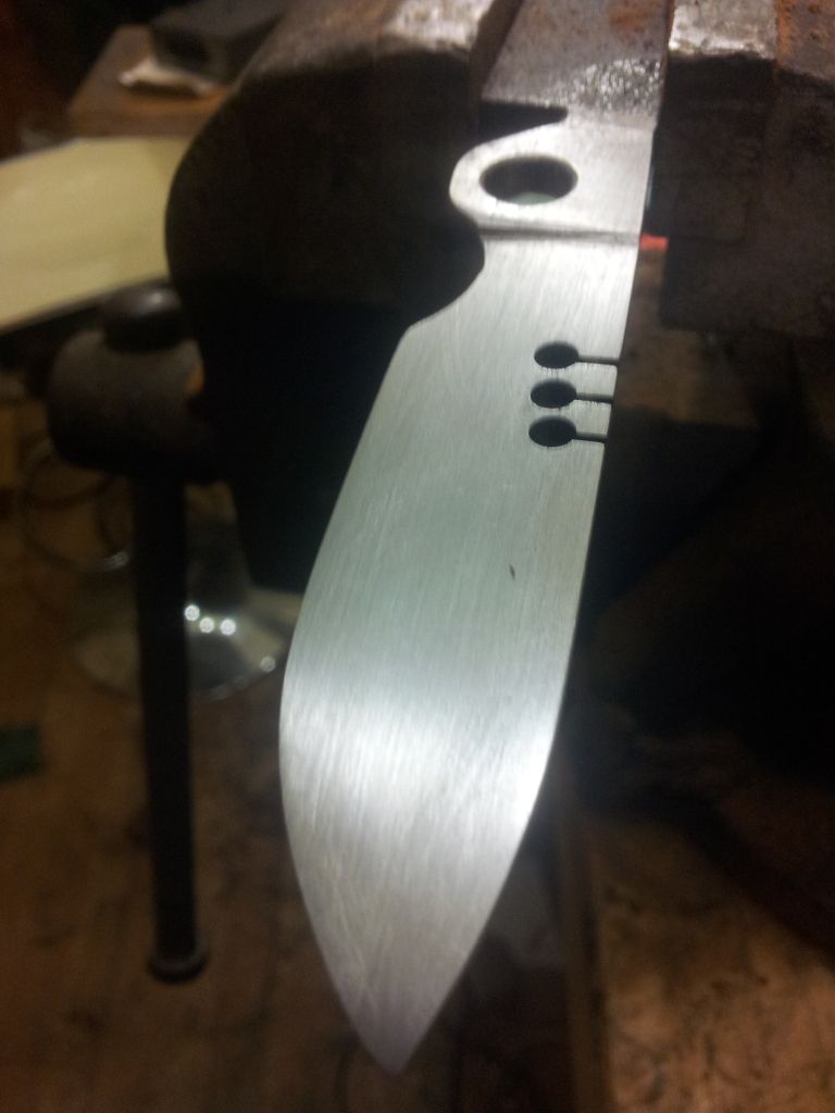

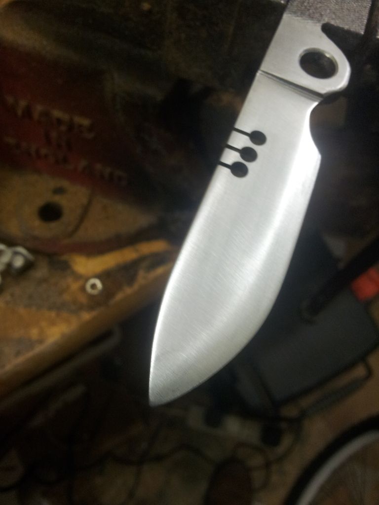

Got some more done tonight . Its finally starting to look like a real knife. used 80 grit to remove the gouges left after filing, Then 180 wet and dry to smooth out scratches

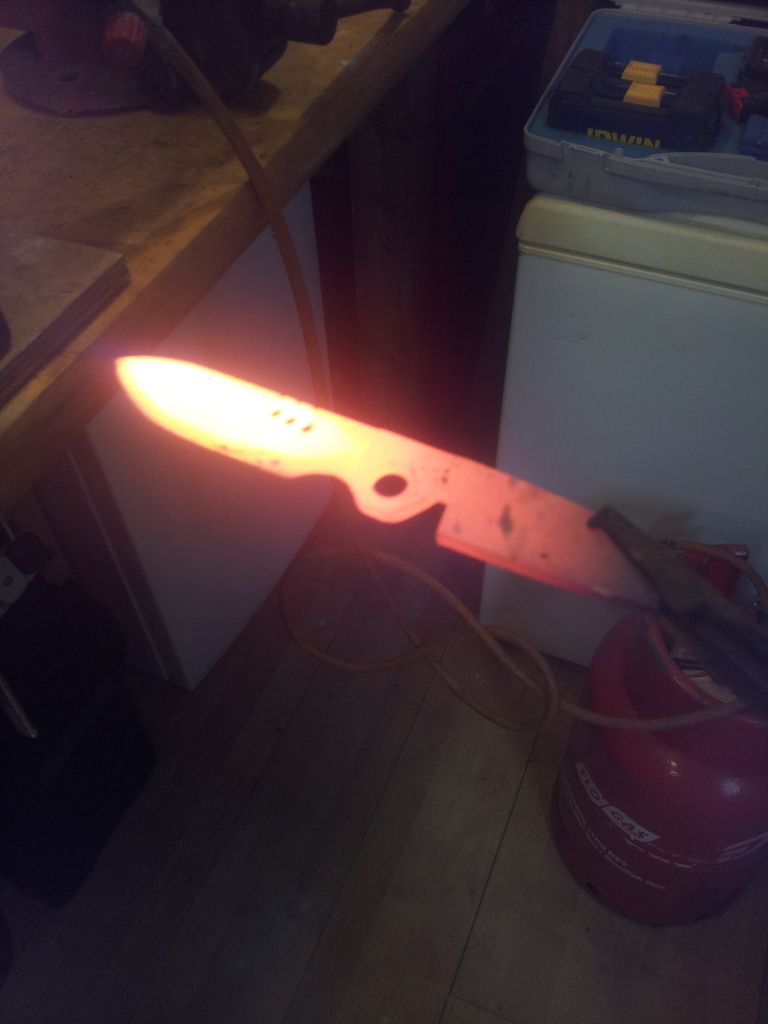

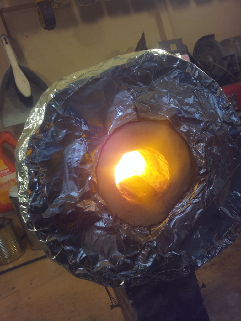

Pre heat the forge for 10 mins and then bung in the blade
The file end wasn't heating enough so I flipped it around length ways so it was heated evenly all over
when I was satisfied with the heat ,I dunked it into the oil
It came out with a layer of slag on it from the quench
I cleaned off the oil and slag gently because it is extremely delicate until its tempered and gave it a rough sand off
I then took it outside my shed to look at it the light and ....er ....kinda dropped it uppy_dog
so sorry for letting down anyone who is following this thread, But I have learnt loads from this ....Like look at the perfect martensite microstructure
