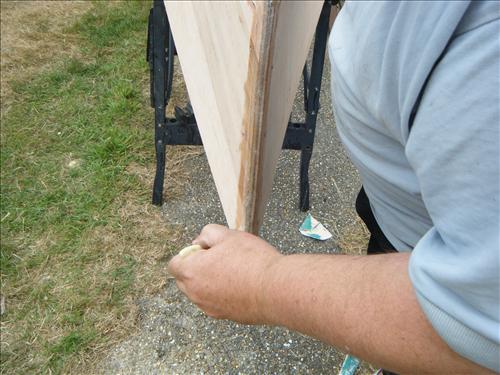

Now for some careful sanding of all the joints.
I have heard of sand paper - honest!

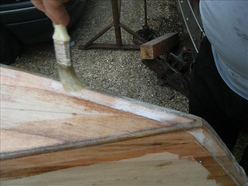

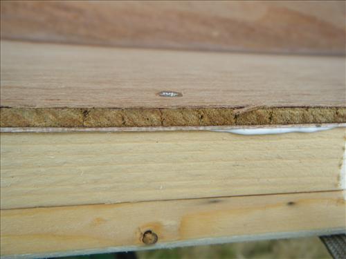

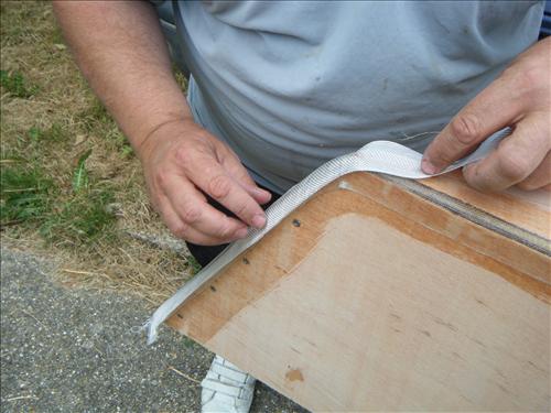

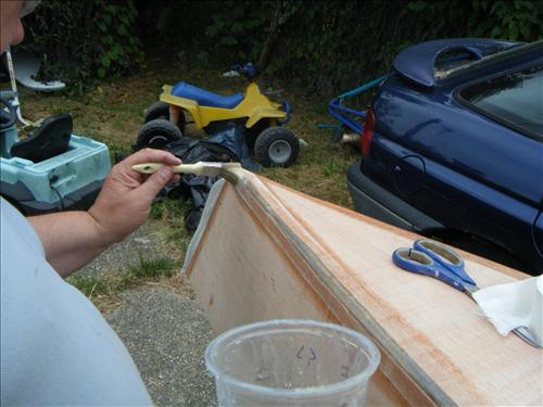

Its wetted with resin, now Im microfibreing the joints.

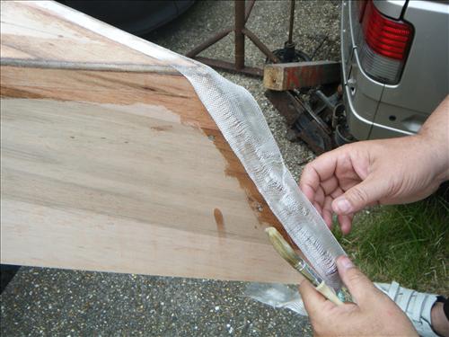

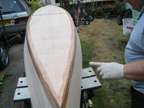

Stretching the tape along the bottom joints..

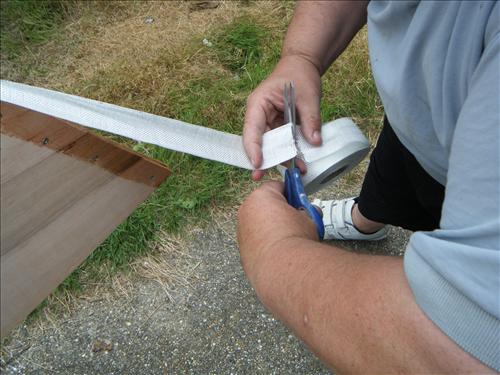

Cutting it a bit too long, as I can trim it later, but adding more isnt so simple.

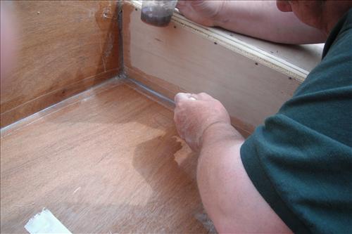

Wetting the tape out

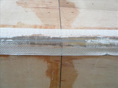

This is what the tape looks like when its resting on the wet microfibres..
It goes clear as you wet it. Mustnt add too much. Not sure why, but thats bad.

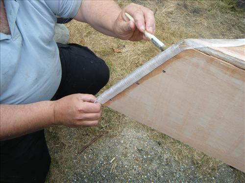

The ends are fun.
You lay the tape on...
Wet it to the corner...
Catch it by the edges and pull down...
The tape distorts tot he shape of the corner..
Jus like that!

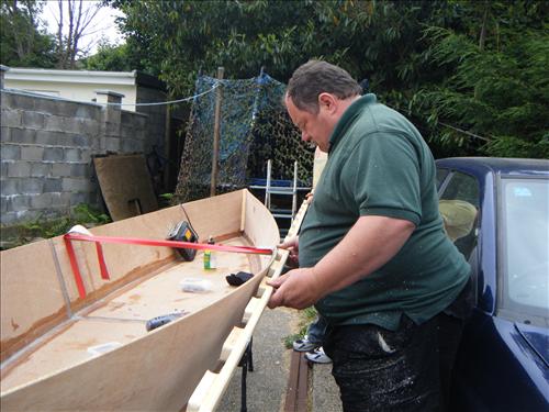

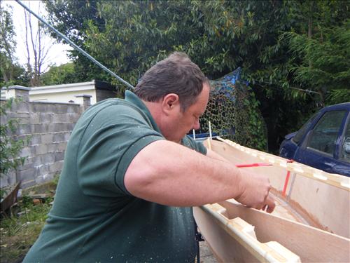

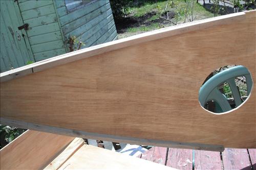

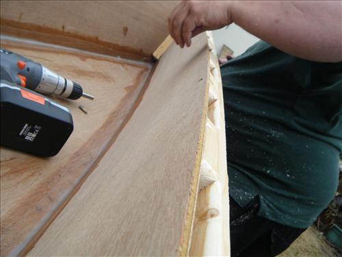

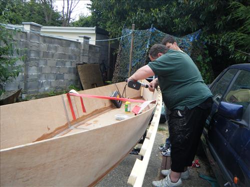

The bottoms set, so I rolled it over - carefully and started on the rails.
Im glueing and screwing them on.
Must remember to wipe off the excess before it clogs up the plane.
hmm... Wondered what happened to that.
Other side..
It would probably be easier if I didnt have as much stomach as a tellytubby.
Still... This thing might make a good excersise bike.

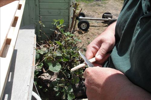

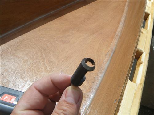

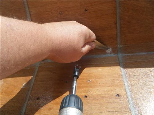

Found this thing. Think its called a plug cutter.
Used it to cut a disk out from over the screws..
Prising out the disks.

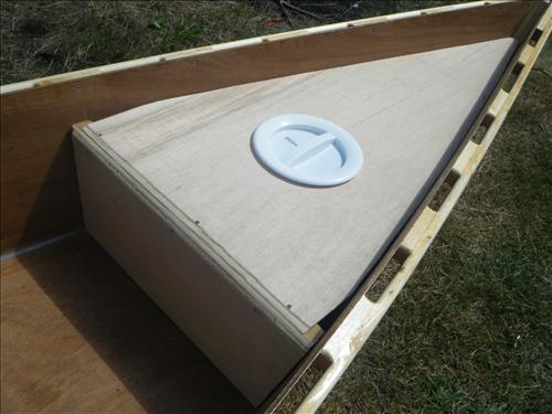

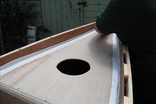

Decided that as the polystyrene is sort of coming apart in the kids boats, I wanted tanks as Bilmo suggested.
This isnt fixed in yet, but probably soon will be.
If I dont actually like them, I will just cut them back out.

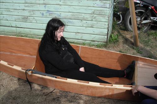

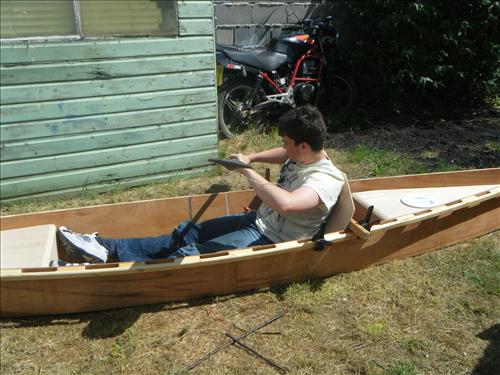

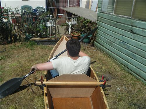

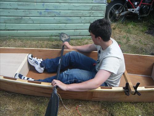

I need a backrest or my stomach will lever me flat in the bottom of the boat.
Got my kid to be my dummy so I could work out what I needed.
With feet jammed against the back of the front tank, and back against a back rest...
More power to the paddle.

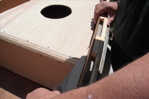

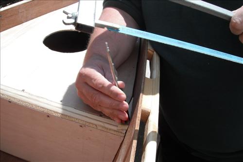

Cut some more ply to make a propper back.
Im holding it in with clamps until I work out exactly what I want.
Had to trim some off it to be able to move it back like this...
Happy with that. Simple.
Im not bothering with a seat bottom as I want my bulk as low as possible to help stabilise it.

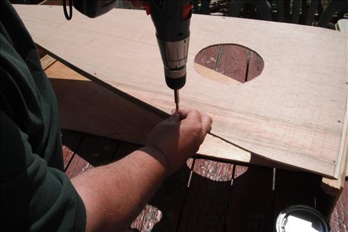

Decided I want the tanks in strong, as I stack several canoes together on Little Ideas trailer and I dont want it to crush.
I should be able to screw through the side into these battons to strengthen it if I need to later.
The ply I had wasnt quite wide enough so Im going to fill these bits.

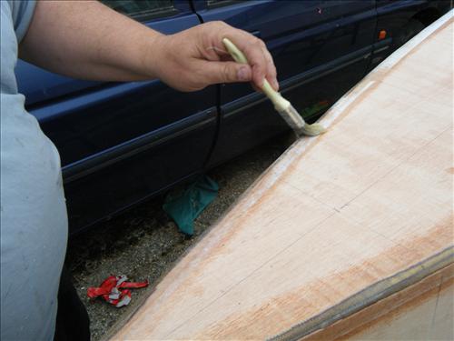

Taping it in..
Wetting it with resin..

So I got Biggest in the front and got Little Idea to do the paddling from the back.
The wifes boyfriend arrived with a new hat that hes sure will help him catch a fish.
...so I dared the wife to go out wiht Little Idea being her inboard motor.
Having had it thoroughly tested..
I had a go.
I hate pigging canoes. Hate this one too as it rocked alarmingly and frightened me.
After 30 yards, I got out.
