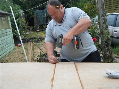

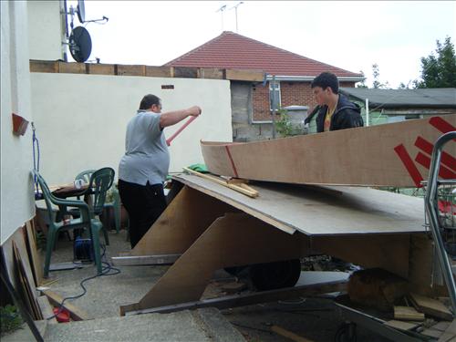

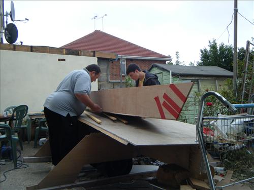

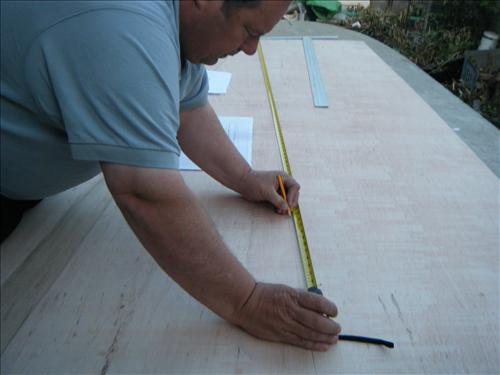

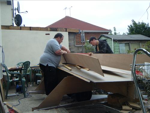

I need a new tape measure. All the numbers are blurred on this one.
I think you are supposed to cut the boards up and then join the ends....
Er....
Too drunk to make much sense of the instructions.
Filleting it - as I didnt get any fish to do. Grrr...
Er....

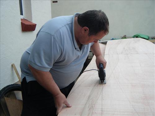

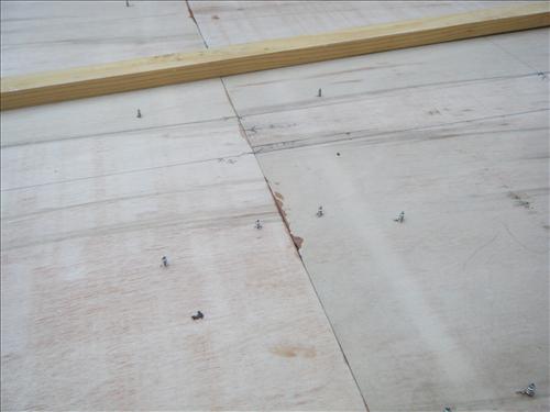

Just discovered that marking out the lines whare to cut is difficult if you have screws poked through everywhere.
Discovered the jigsaw didnt like screws either.
Wonder if I could get some wooden screws.

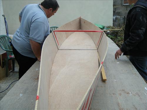

Staggered off and found some breakfast.
Now a few hours later and not quite so blurred...
Found one of my brats...

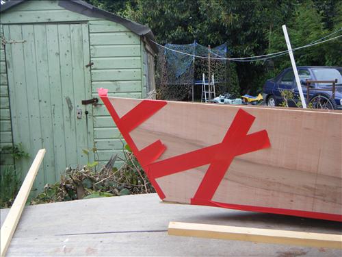

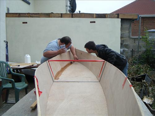

Time to put it together with duct tape...
One end done...
Now the other...

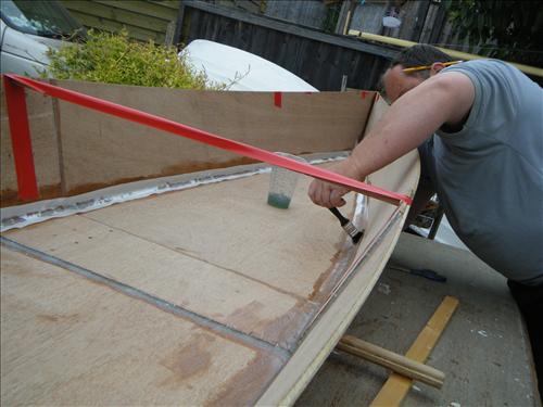

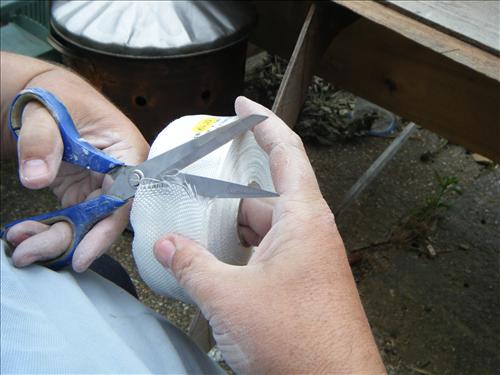

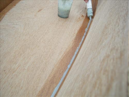

If we can shut up some of the holes...Its time to fibreglass..
Just patched a bit I missed...

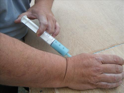

Wetting the joint to stop it wrecking the microfibres..
Srynging them on while biggest wets out the other side..

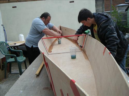

Im going to shove this on while the microfibres are still wet so they all blend together.
Not admitting Im too impatient to wait..
Getting there

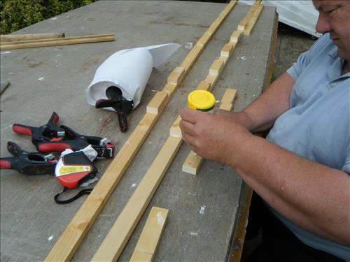

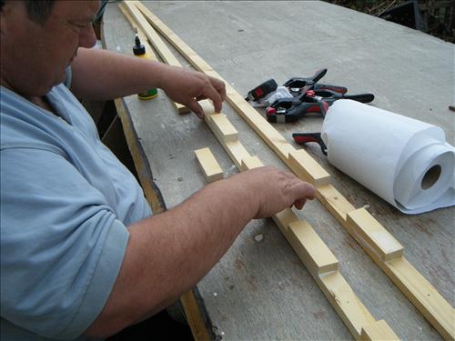

Ive glued the rub rails together and now Im gluing on the blocks.
Then I called it a day.
