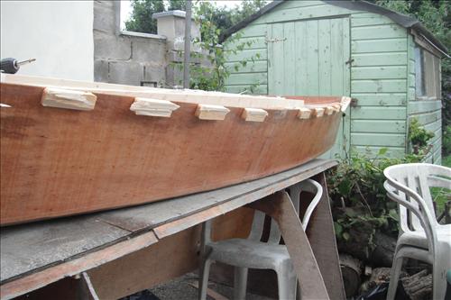

I cut the rub rail blocks (not actually in the original design), with a bandsaw, but the jigsaw would do it. Bandsaw £8 I guess at B&Q
Smoothing the edges of the rubrail - Probably could do it with the grinder, but I use a £95 Router from B&Q.

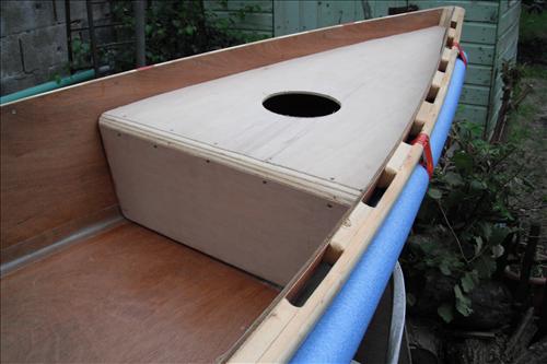

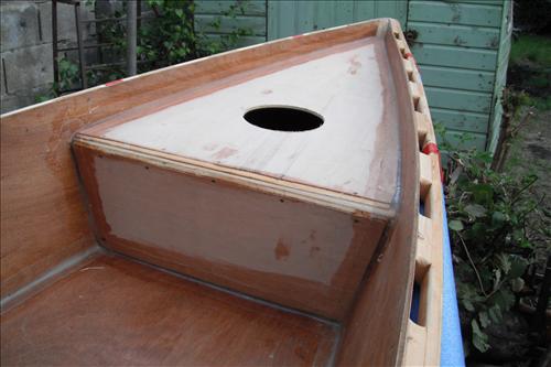

I went home and put the other end tank in...
Taped...
Er..I did varnish the insides before I taped them in so if they get wet, they wont start to rot.

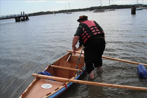

Arrived at the launch by the pier.
Dragged all the bits to the waters edge and sort of threw it together
I was pretty sure it wasnt going to work. Still. In for a penny....
It looked like it was going to rain, so I got my hat.
I am a firm believer in positive thinking...
"Itsnotgonnasinkitsnotgonasinkitsnotgonna......"
I think I need to work on my positive affirmations.
Still..
It was in....
With me chasing it and wondering how to get in without breaking it in half or missing and ending up swimming
I knew it was going to be a bad day.
There was a large cracking sound.
Still at least my kid missed the moment when I hit the water.

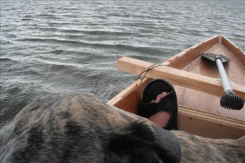

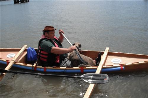

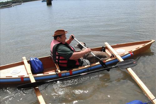

Stupid likes the little paddle best.
The big paddle drips water on his head and that makes him start - and hes still perilously close to my nuts.

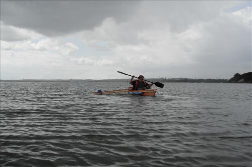

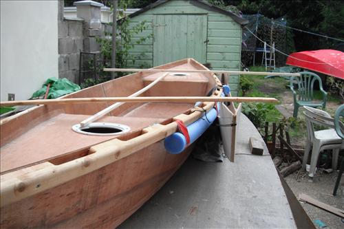

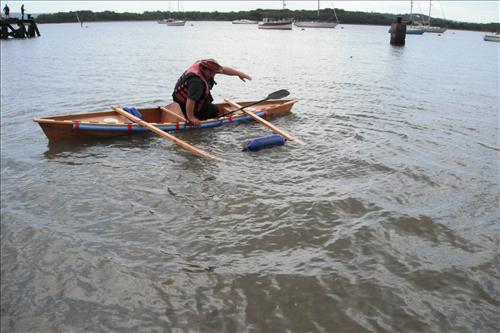

This is what I wanted!
No Idea
Sep 18, 2010
2,420
Dorset
I was loving it.
This boat is soo stable with the outrigger on.

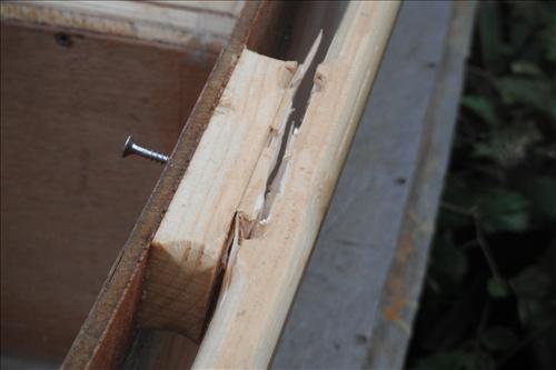

We had a nearly dry trip back as it stopped raining - right up till we made the beach and I fell out again.
Loaded the dog and biggests canoe.
Was starting to take mine apart when it made another dash for freedom.

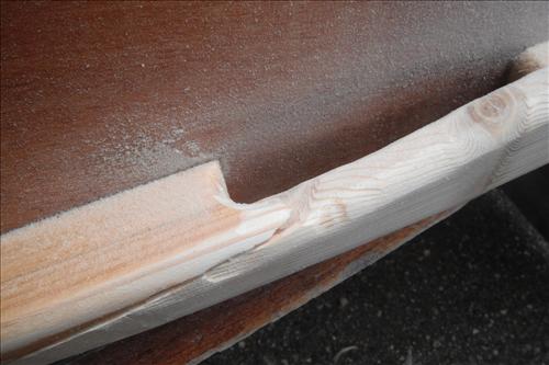

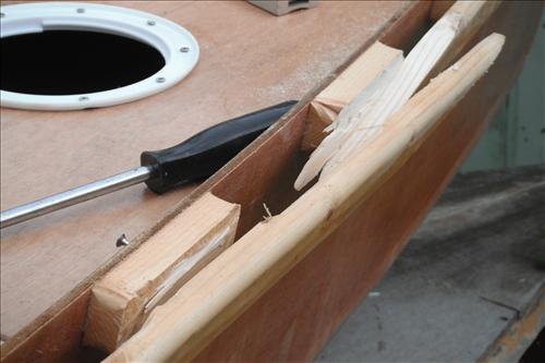

As I caught it, I saw what caused the earlier cracking noise.
Balls.
Looks like I need to go back to the drawing board.

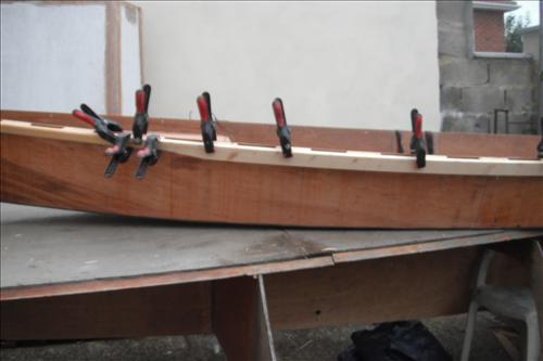

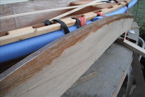

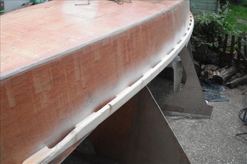

I needed to get off that broken piece of rub rail.
I keep hearing that layup fibreglass is seriously weak.
I think I need to differ.
The wood let go first.
Took me a whuile with a hammer and chisel to get it off.
Even then I splintered several of the blocks.

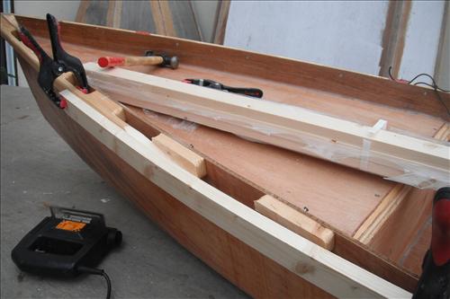

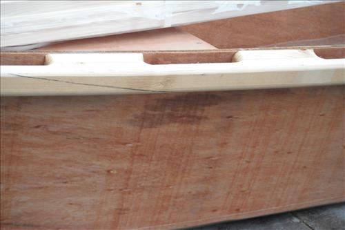

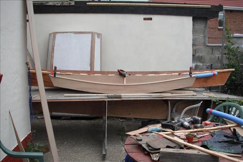

I carefully jigsawed through it at both ends of wher I decided it needed strengthening.
Here is the line I marked before cutting it through with the jigsaw.
Had to be careful not to damage the block or even the hull with the saw.
Its off! - Well, most of it.
Im going to replace that section with a thicker piece to reduce the chances of it breaking again.

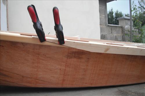

Now its clamped on, I can mark the line I need to cut to.
No Idea
Sep 18, 2010
2,420
Dorset
Its cut. I will need to blend the two pieces together after its glued on.
Done it.
Need to wait for it to dry.
Ive gone over it with the router and the grinder to put the curves back into it. The white stuff is wood dust.
Its going to need some tidying up.

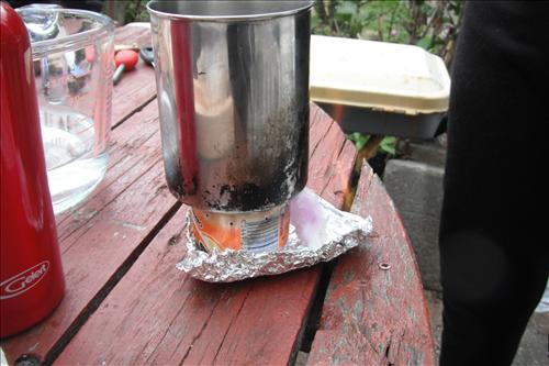

Little Idea said that fixing that was boring, so he wandered off and found some little coke cans and made a new meths burner with the holes round the sides instead of on top.
....Like you do when you are feeling bored.
Its too bright to see the flames.
Need to take pics at night.

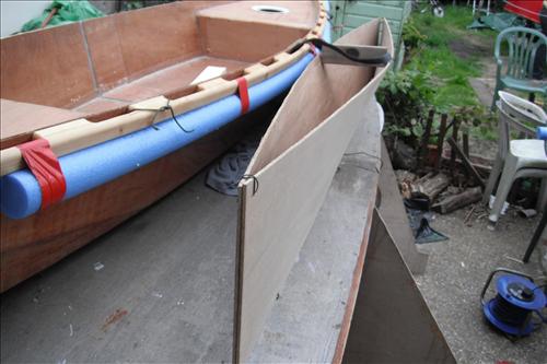

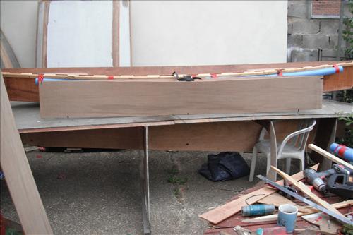

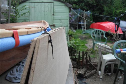

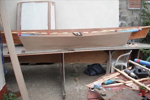

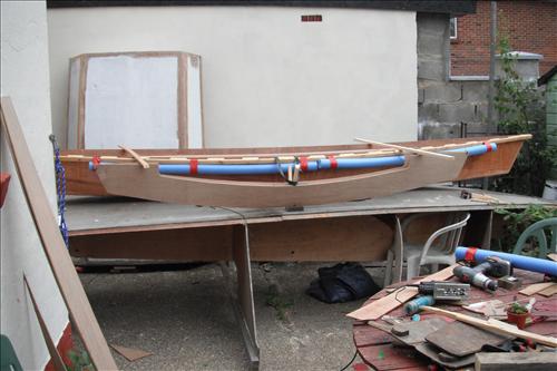

I hacked off 2 1 ft (305 mm) by 8ft (forgotten, but 2440mm - I think)
,,,and sort of looked at tehm for a bit.

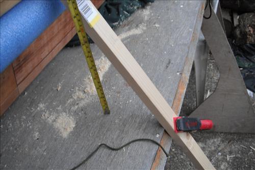

Ive clamped a bit of wood at teh steepest angle Im likely to paddle at.
No Idea
Sep 18, 2010
2,420
Dorset

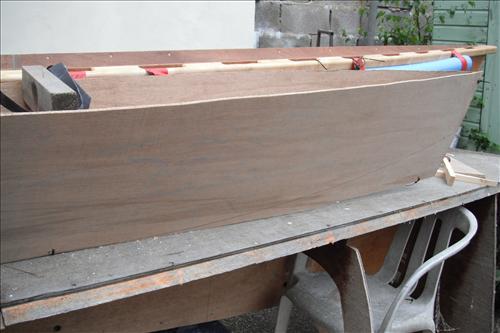

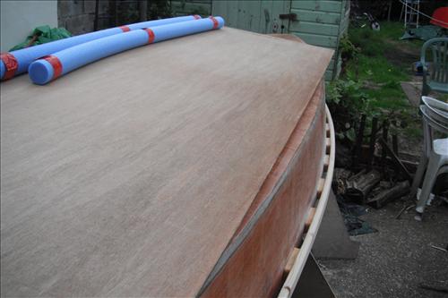

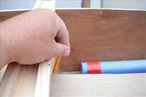

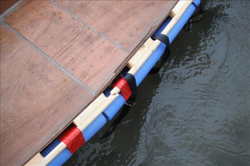

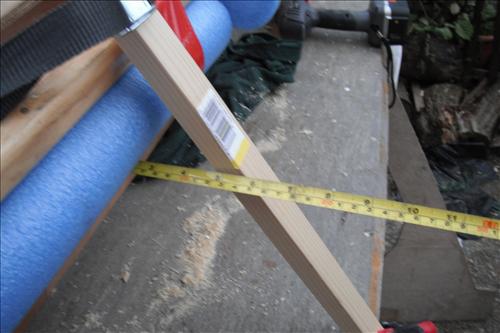

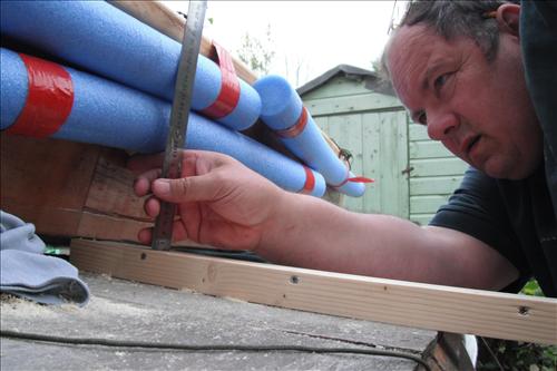

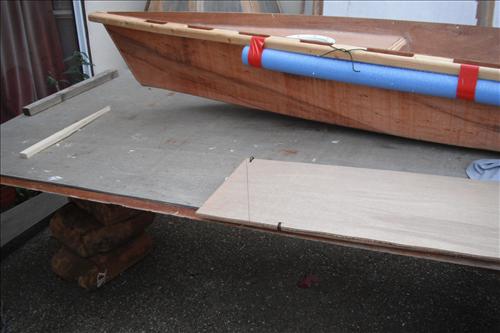

I had a good look at this pic and sort of worked out where the water comes to on the side of the hull.
Its a pool noodle width below the poolnoodle...sort of.
So...some careful measruring later....
Ive got 12cm width....
..and about 20cm high...
...at a guesstimate.
I carefully cable tied the two bits of ply together...

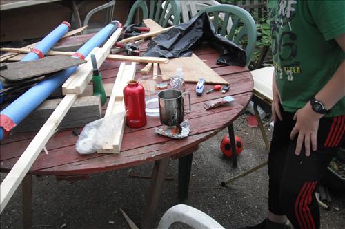

So I sort of hammered in this block of wood so I could look at the shape.
I decided I needed to reshape the ends a bit.
Done.
Even with the block jammed in the top, the bottom is still straight ( sort of expected the ends to curl up).
Having a look at the gap under two pool noodles, as that was about the size of the gap on the photo.
Struggling with this as I have No Idea how this will turn out.
No Idea
Sep 18, 2010
2,420
Dorset

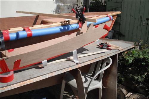

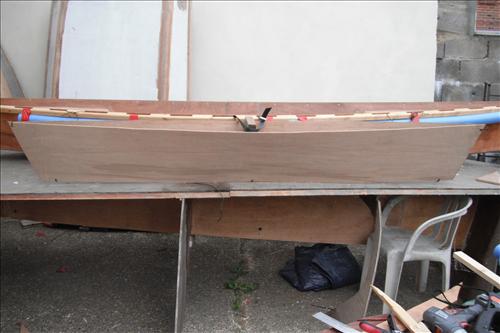

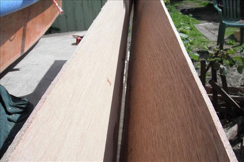

Knowing where the water came to on the canoe, I marked this at teh same height.
Drew in the line - which is very feint on the pic with a baton.
Marked where the arms would join on...
Thats the bottom cut to shape, and the baton bent to the shape I want for the top.
Its cut.

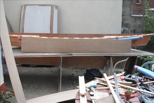

Hmmm.....
I sort of want it to pack up under the edge of the canoe, so I can get it between the roof bars on the car, and when on the water, still paddle it like a normal canoe if I need.
I taped it and microfibred the inside, but the sun cooked the tape off. Poxy tape. Need to put some clamps on it so it wont fail in future.
Its got a hole in it. I ground it and re did ti.
..Then I wetted it out and taped the joint.
I hammered the top on, but the joint inside cracked, so we had to go and replace i.
Then I varnished it.
