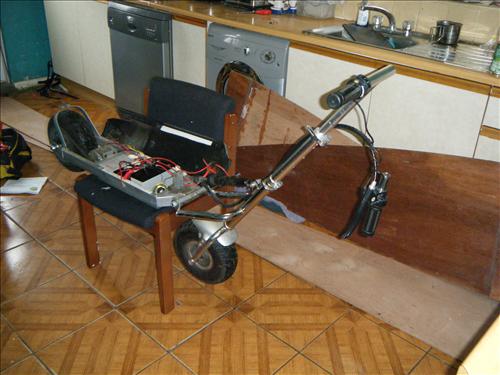

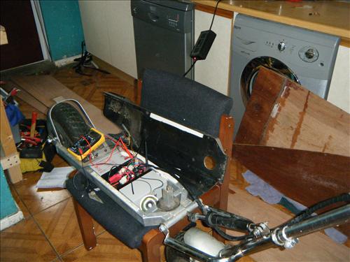

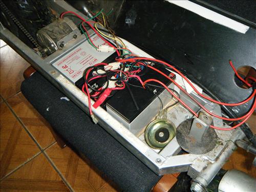

I suddenly had this overwhelming urge to go fix my electric scooter..
The batteries have died and it seems to have lost a wire...
Expert on wires me....

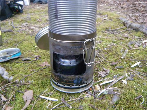

Was intending to use Bilmos woodgas stove here for the first time, but she was in the way and I wasnt about to go through the rigmarole of trying to move her.
I love these little stoves.
...nearly as much as I like hammocks.

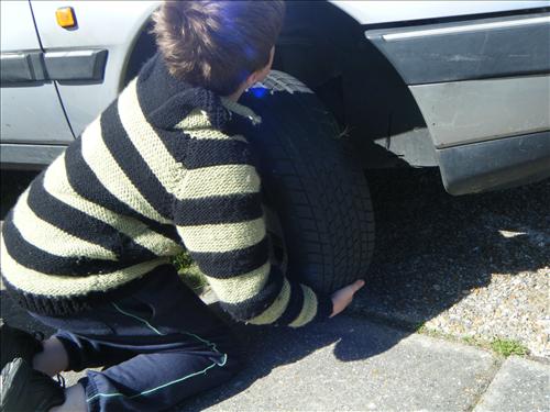

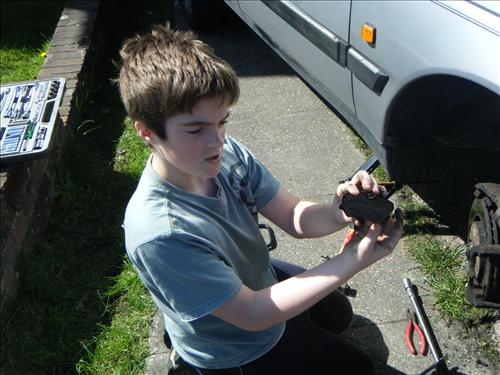

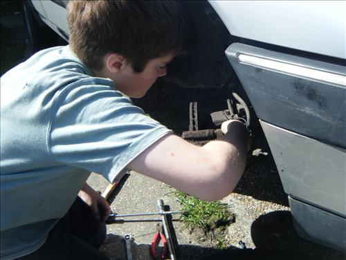

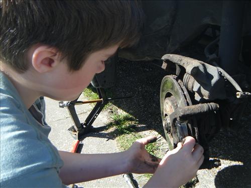

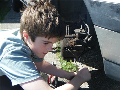

There was this horrible grinding noise comin from the front of the car.
decided it was the brakes.
I suppose I could have done them, but then the kids wouldnt get a chance to get filthy.
No Idea
Sep 18, 2010
2,420
Dorset

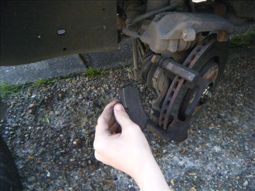

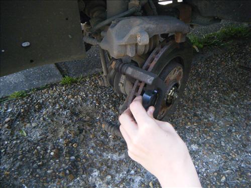

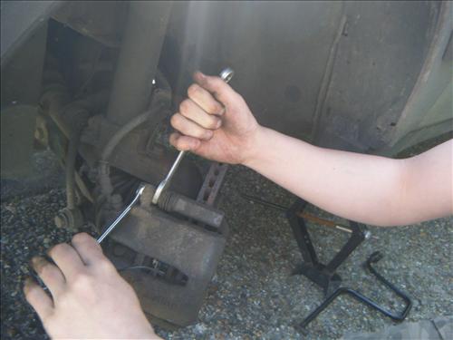

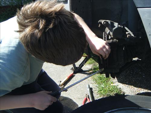

The pads are in here and they squeeze the metal disk to make the car slow down.
This one has only one cylendar and its on the back.
You have to take out these two screws to get the top off the caliper
They are harder to get undone than the wheel nuts. You get a longer spanner for them...
The tops off...
Need to poke out the pads now.
Its rusty.

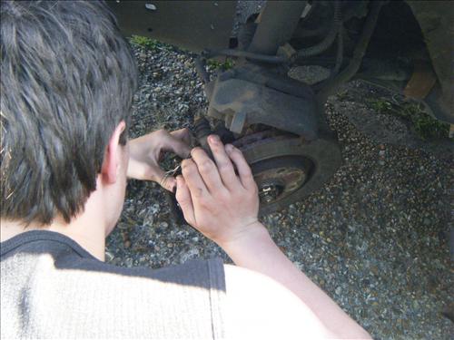

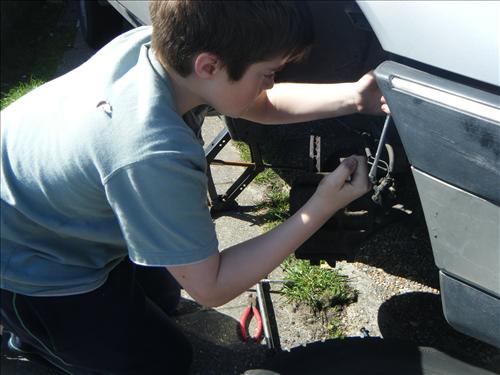

No Idea
Sep 18, 2010
2,420
Dorset

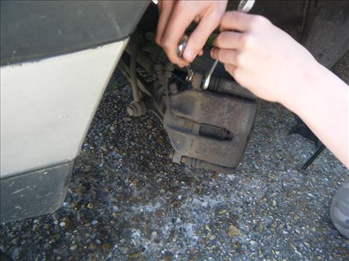

Got one out, but the other is trying to stay in.
The bit that rubs on the disk has worn through and the metal at the back was grinding on the disk.
Putting the new ones in..

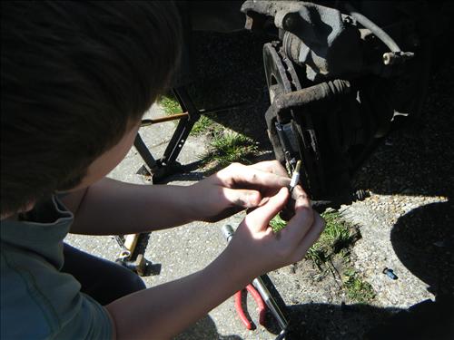

Joining up the wire that puts the warning light on when the pad needs changing - the light that dad ignores.
They need to go in a bit more as the top wont go on.
No Idea
Sep 18, 2010
2,420
Dorset

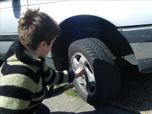

This is the best bit!
Bolting the top back on...

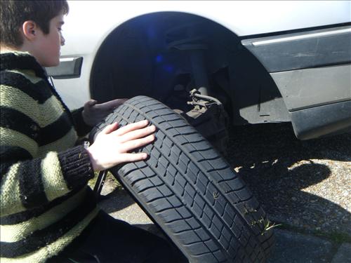

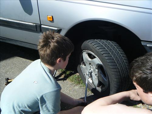

Needed help getting the wheel on as its got bolts instead of studs.

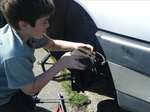

No Idea
Sep 18, 2010
2,420
Dorset

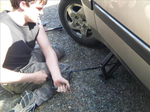

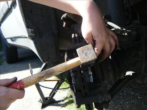

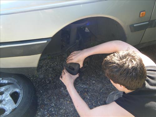

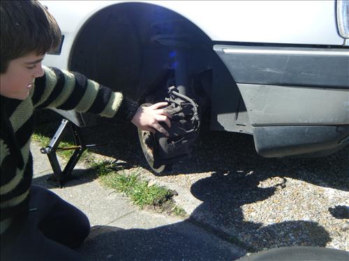

My turn says big brother..
Unbolting it..
Pulling the top off
They wernt completely destroyed on this side. Must be because dad sits on the other side. Ow !

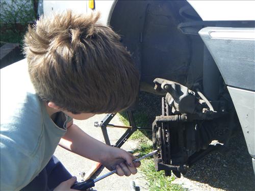

New ones

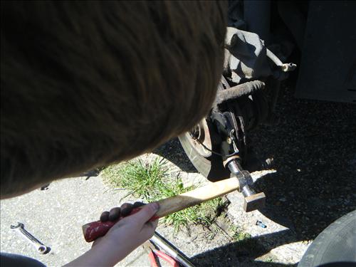

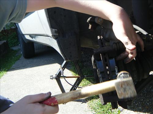

This one doesnt want to go in.
No Idea
Sep 18, 2010
2,420
Dorset

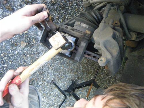

When you put your finger on the pad and hit it with a hammer...

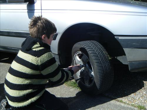

Dad said dont worry about it - I missed the wire.

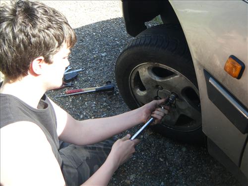

Bolts back in...
Wheel on...
I managed it even with the bolts
One of these days we are going to manage to get dad to learn how to do brakes.
