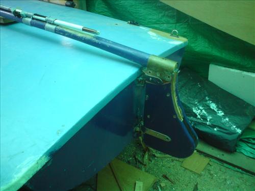

Decided I needed to fix my rudder.
Its sort of important to be able to try to point the boat where you want to go.
Doesnt always guaruntee Im going to go that way, but it helps...

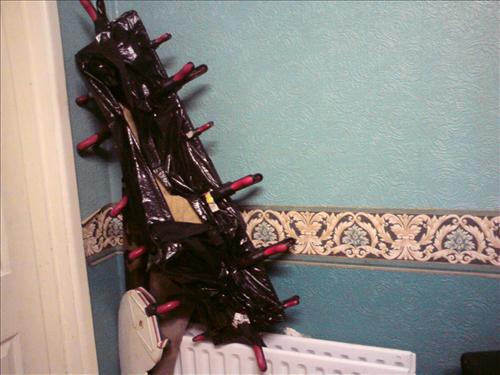

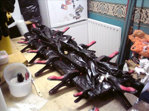

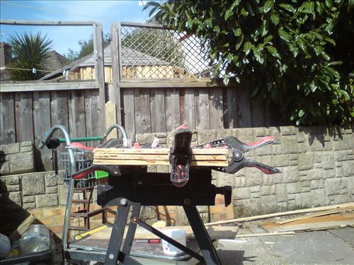

Wandered into Build Base. Picked up another sheet of Marine ply and staggered home with it on the car.
Hacked it into pieces ready.
I coated the pieces with a layer of fibreglass resin, to sort of seal it, then another thicker coat mixed with microfibres, which makes it into a good glue.
I stacked up the pieces while it was still wet and wrapped them in a bin liner and clamped it all around the edges.
Thats it, on the work bench in the kitchen.
No Idea
Sep 18, 2010
2,420
Dorset

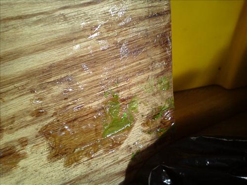

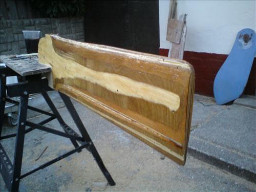

I decided I wanted it to dry quick, so I stood it on top of the radiator.
The next morening, I unwrapped it.
Seem the green ink on the bin bag leaked...
It is the right sort of shape...

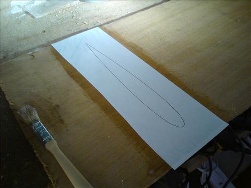

Nots sure Im that impressed with it though

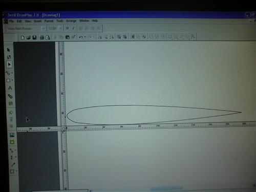

I carefully mapped out a propper shape for a rudder with co ordinates on a free foil designer, and fed them to a serif draw free drawing pack to make this, which I glued onto a sheet of ply to make me a template. Would have been easier if I hadnt glued it in the middle. Idiot.

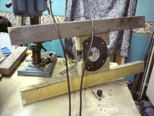

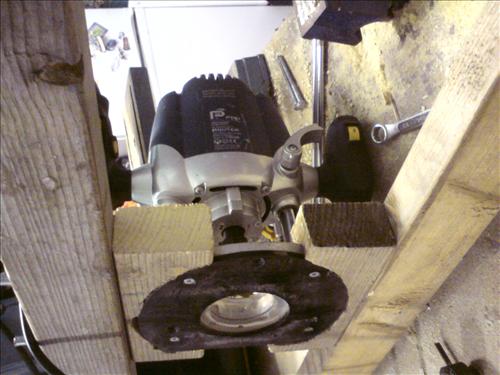

The ply had dried warped, so I built this jig to hold my router, so I could machine it true again.
While I was making this, I left the board on the kitchen floor.
I stepped back.
There was a crunch and a broken rudder blank......
Back to the drawing board.
Oh well, at least I can make sure the next one is actually flat.

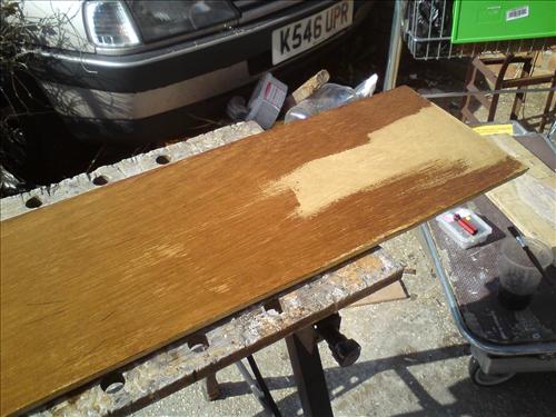

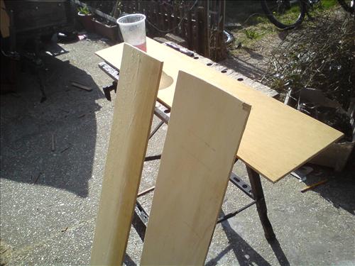

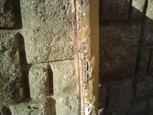

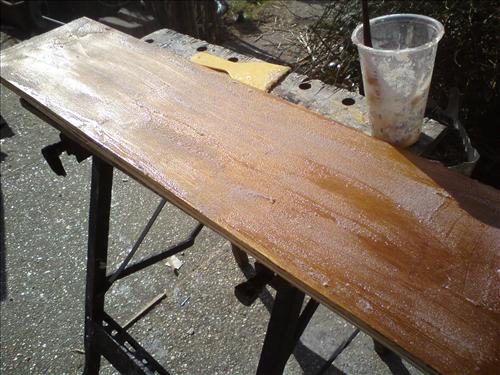

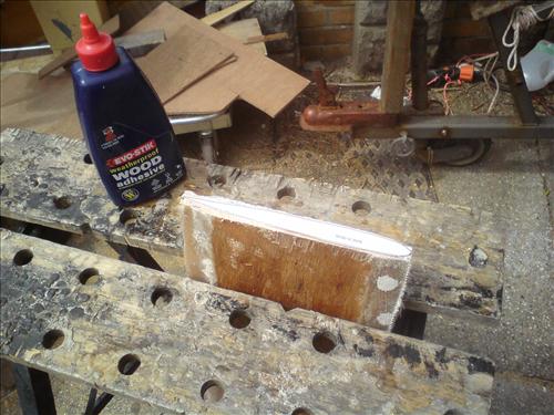

Another trip to Homebuild....
Mixing resin to seal the boards. If you dont coat them with activated resin before you coat them with the resin with the microfibres in it that you use as glue, the dry wood sucks the resin out of the microfibres and the microfibre coating fails as its not got enough resin...
No Idea
Sep 18, 2010
2,420
Dorset
Resin going on...
Ive mixed the microfibres - which is a lot like talcum powder, which you can use if you havent any microfibres, and painted that on thick..
No Idea
Sep 18, 2010
2,420
Dorset

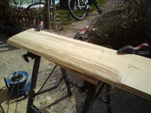

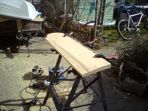

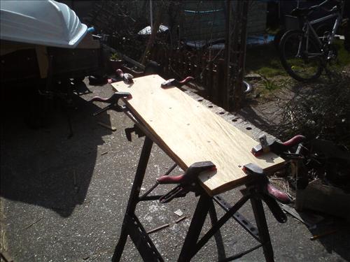

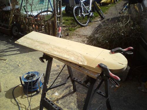

This time Im going to clamp it to my workbench so it pigging stays flat!
Third layer on...

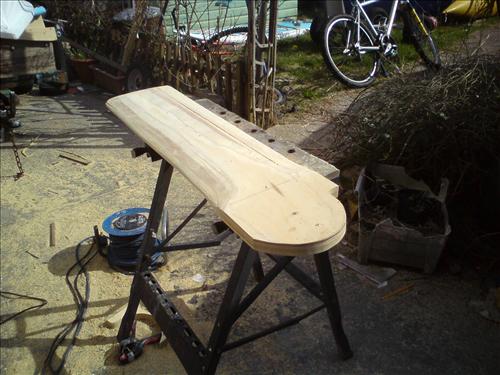

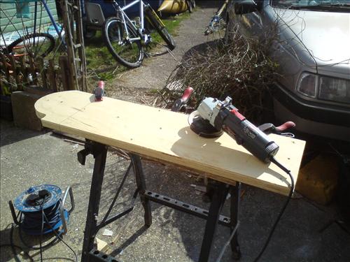

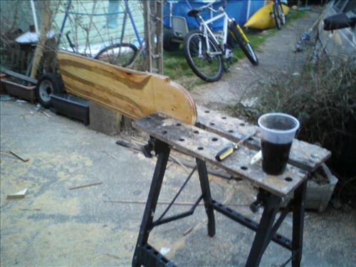

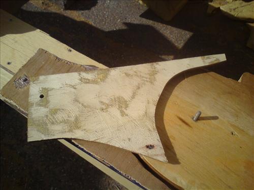

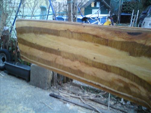

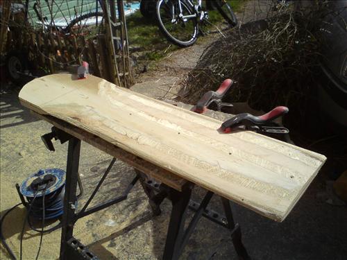

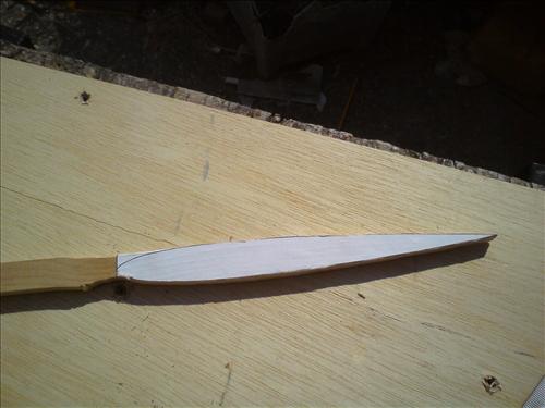

Ive decided to bodge it this time as my high tech approach with the router didnt really feel that good.
The pattern I made last time..
This is that grinder wheel that I remembered to take off when I was hacking bits out of my hobo stove a while back..
I love this thing!
Its really horrible but it works.
First face....
No Idea
Sep 18, 2010
2,420
Dorset

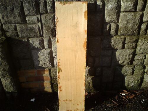

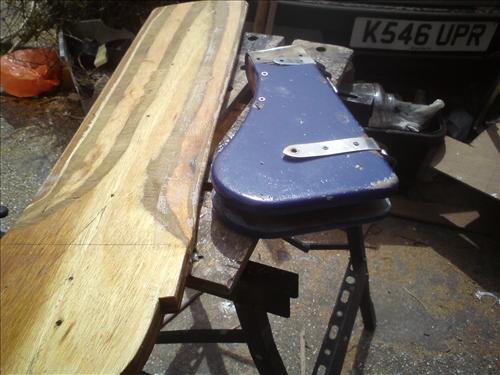

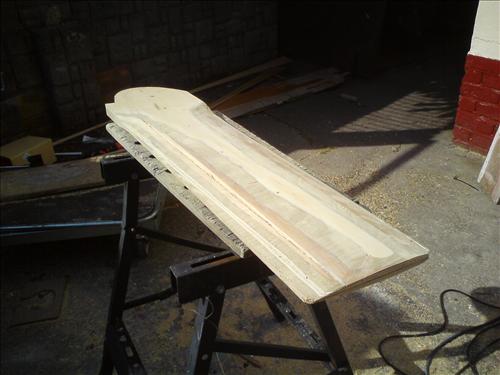

Looks better after its been planed and sanded a bit...
Time to coat the exposed grain...
Hmm.... probably not the smoothest piece of work in the world, but so long as it works...
Reinforcing the leading edge as I know Im going to hit it on things..
No Idea
Sep 18, 2010
2,420
Dorset

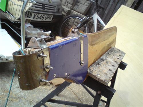

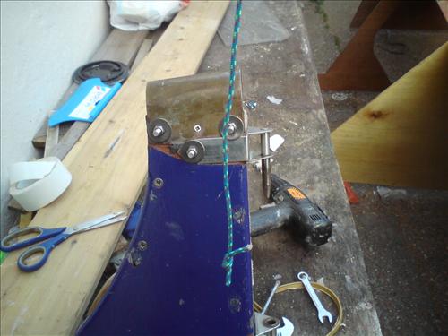

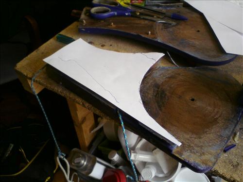

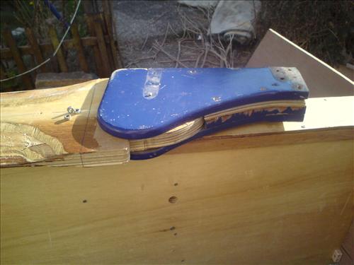

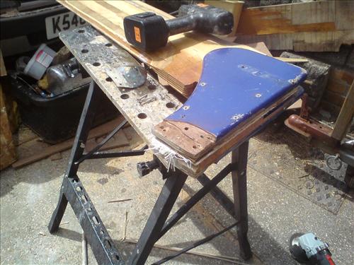

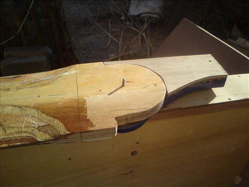

The bit this fits into is called the rudder stock.
Er.....
My nice new rudder blade is too thick...
I pulled it to bits..

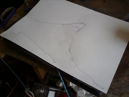

Marking out a template out of a bit of paper that i drew round on the stock so I would have the shape...
Its rough but it works..
Piece of ply cut to size...
Offering the blade to check thicknesses
Other side on...
It sort of looks right..
No Idea
Sep 18, 2010
2,420
Dorset

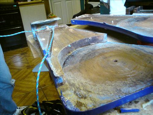

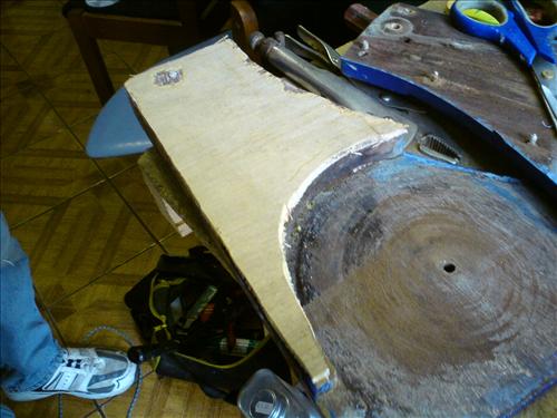

Needed to be a little thinner, so I ground off a ply..
ooh! Just found a pic of the plotting prog with the nacra 0010? profile that I used.
Ive just ground out where the hinge things fit on as its suddenly got a lot thicker..
If I hit it hard enough....
Well....It still fits on the boat...
Ive binned all the screws and got a set of stainless bolts and nyloc nuts.
It aint going to fall apart again!
When it goes into the water its flipped up, I need to be able to push it down from in the boat, so I must actually be able to move this.
Er....
when I cut the new template out after plotting it, I glued it to the end of my blade and then hacked it to that shape with the grinder..
Just found the pic of it glued on...

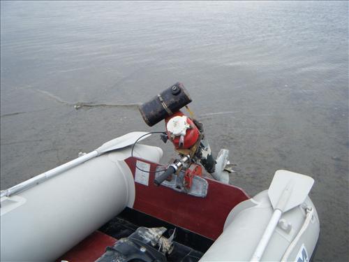

Went boating yesterday!
Hadnt been for a couple of weeks.
Mr Captain fixed a couple of outboards we were given.
Went out and tested them.
Looks like I might need to build a boat to put an outboard on...
Come to think of it, I have half a boat I built in 3 or 4 hours in the summer...
I wonder if I could modify it a bit...
...as well as finish it.
