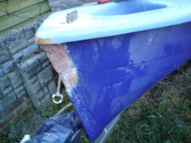

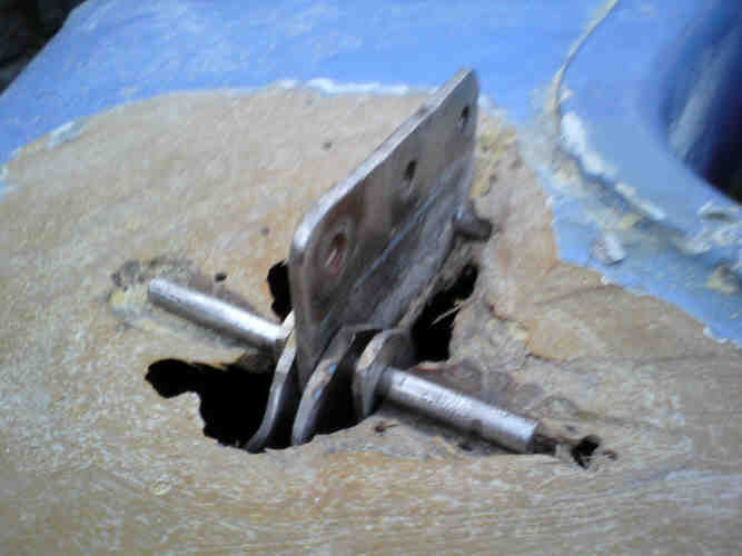

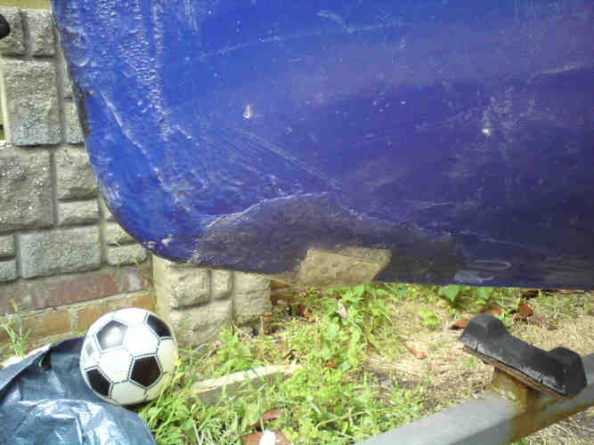

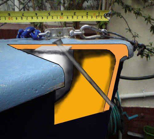

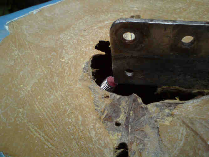

I got Little Idea to climb into the front of the boat - Im to fat to fit in there, and measure to the nose of the boat.
The fitting didnt go all the way through the, except where the deck had shattered.
This was roughly how it seemed to fit.

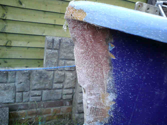

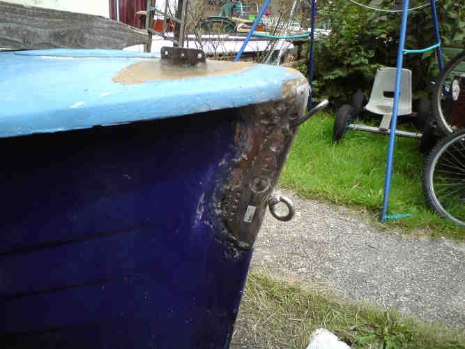

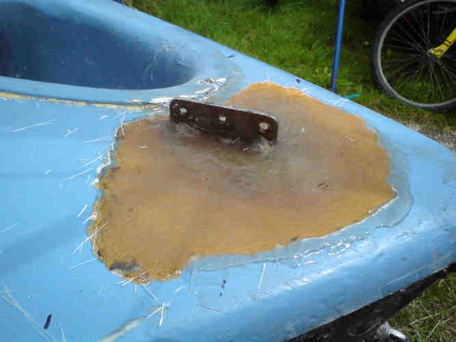

I decided the best think I could do was stick a chunk of bar out through the front of the boat and tether the fitting there.
The Osprey Association heard I was having some problems and sent an expert down to advise.
He thought I would do much better to tie it to the bottom of the boat as the angles would be much stronger.
Er.....lol
As if I would know.
I decided to try both.

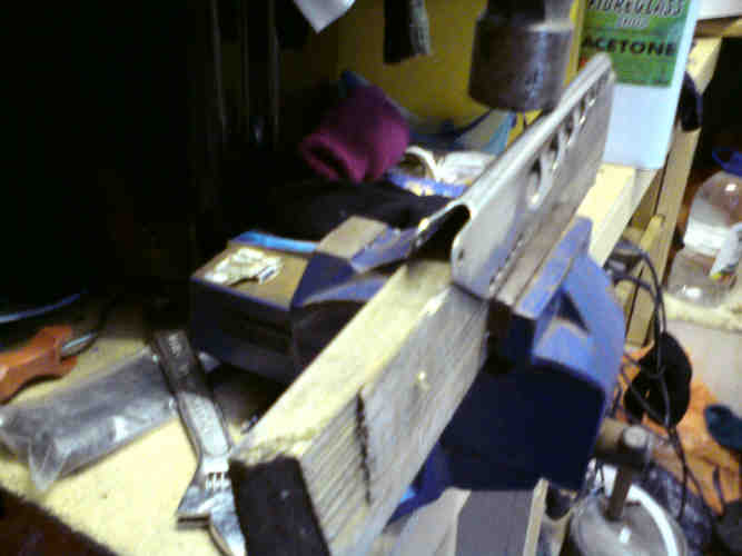

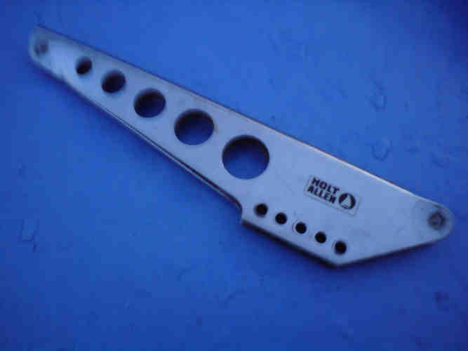

I found this boaty bit on Ebay.
Apparently, its part of an expensive thing called a vang.
Its supposed to hold down the boom, so it doesnt fly up when gusts of wind hit it.
er....
That was before I bought it.
No Idea
Sep 18, 2010
2,420
Dorset

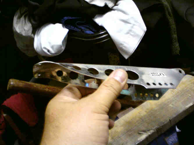

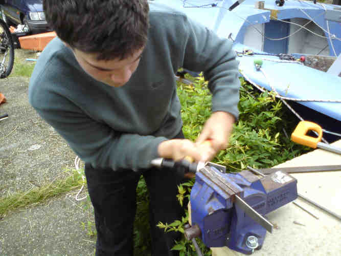

It wasnt quite the shape I had in mind....
Adjustable spanner in the kitchen workbench vice....
Followed by large hammer....
Hmmm....
Thats getting there.....
Im sure thats not quite what Holt expected me to do with it, but....

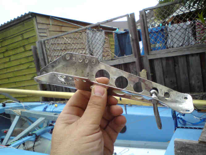

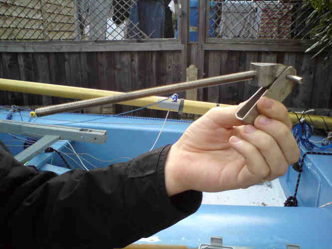

No Idea
Sep 18, 2010
2,420
Dorset
Big Idea decided to help.
Its amazing how much noise he can make.
Fitted with a er.... modified shackle.
Nope.
Probably not what Holt had in mind.
The bar stuck out the front is joined to the pin through the forestay plate - the pin that came out of the deck.
No Idea
Sep 18, 2010
2,420
Dorset
A double bracket to take two bars.....
The wifes boyfriend hammered the second into shape as she visited to see the kids and he wasnt doing anything.
No Idea
Sep 18, 2010
2,420
Dorset

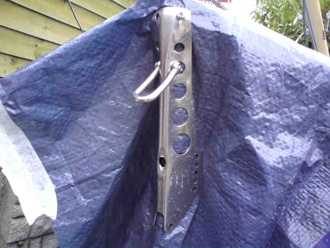

I coated it with P40, car body filler and put it together.
This is what it looked like when the tarp came off and I tidied it up a bit.
Im worried it wont be strong enough.
No Idea
Sep 18, 2010
2,420
Dorset

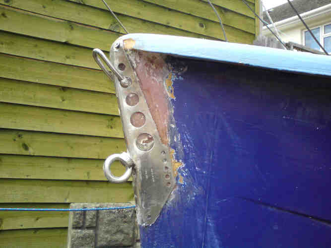

The bracket we made fitted to the forestay fitting....
One bar out through the front....
And one fibreglassed into the bottom.
The plate is on....
The top is glassed back in...

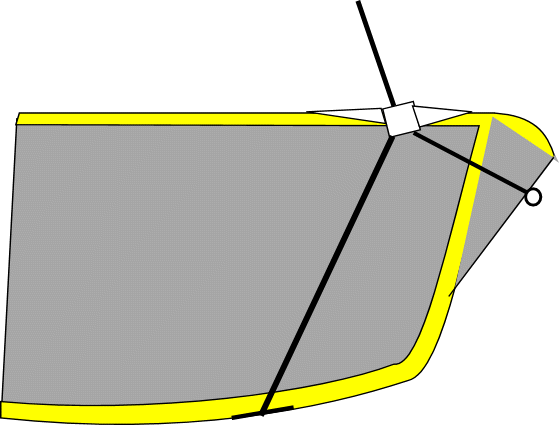

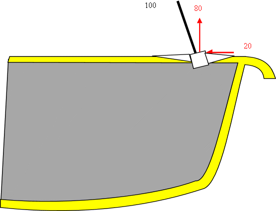

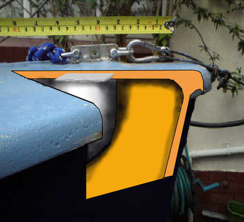

The Osprey Association told me that the 100% pull on the front rope was the same as an 80% pull straight up and a 20% pull backwards - ignoring any slight compression strengths.
They thought that if I patched the hole with the forestay in it properly, it wouldnt come out again.
I wasnt that confident of our fibreglassing skills, and as losing the mast was bad.....really, baaaad.....
I wanted to make sure it wouldnt come out.
No Idea
Sep 18, 2010
2,420
Dorset
I talked to them again and although you arnt supposed to modify a racing boat....
They told me that if I were to use threaded bar ( they winced), and tie the forestay to the floor, the pull would try to rotate the fitting around the anchor in the floor, which would change the loading percentages...
The pull would now be in the direction of the blue arrow...
There would then only be a 20% pull trying to pull my patch out of the deck, and an 80% pull trying to pull up the nose of the boat.
I decided I liked the chances of that a lot more than relying on my fibreglass patch not coming unstuck.
I was still a little worried though....
No Idea
Sep 18, 2010
2,420
Dorset
Thats why I fibreglassed in the nose and plated it with the stainless steel kicker/vang, and then anchored to that too with threaded bar...
I have No Idea what that did to those numbers the clever people from the Osprey Association worked out for me, but I felt a bit better.
Im still panicing about going and testing it though.
