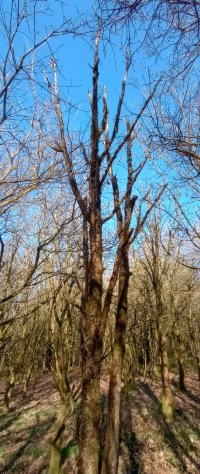

Obvious one to start: Dead or nearly dead ash, due to dieback.
