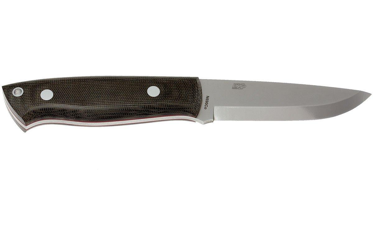

@Erbswurst
the trapper I have doesn’t fit I am afraid. It’s a touch long. Although I thought I had the trapper 95 but I actually have a trapper 115 so the 95 might fit, but if I am
Honest I don’t think the 95 will fit in a nalgene in a sheath. 20mm isn’t much to ‘play’ with with a knife in a sheath.
tip of blade to end of handle it is 208mm for the knife I have.
The Nalgene bottle is 195mm inside from the bottom to to rim.
what about something like the brisa elver? blade. We are talking survival here so a big chopper might not be necessary.
or the brisa necker with a 70mm blade. I think both give you a bit more room to have a sheath.
if you buy them as a blade blank you could fit some real slim scales aswell to save s

Correct, blade length is 2cm longer than the 95 but overall knife length I don’t know for the trapper 95 - those measurements are for my knife (a trapper 115). I edited my post above, sorry
I also must apologise I mistakenly thought I had a trapper 95, it wasn’t until I measured the blade I realised it was a 115.
The other dimensions I have put, the knife was stood vertically in the nalgene, without a sheath. I could *almost* get the lid on the threads but not quite.
if the trapper 95 has the same length handle but a shorter blade I think it will fit.
On another note I hope the 95 doesn’t have a shorter handle as the handle on the trapper 115 is only just long enough in my opinion

I found in the internet the following mathematical incorrect measures:
Brisa Trapper 115
Blade 11.3 cm
Handle 11.1 cm
Over all 22.3 cm (without sheath)
Brisa Trapper 95
Blade 9.7 cm
Handle 11.1 cm
Over all 21 cm (without sheath)
Nalgene stainless steel bottle inside height max 204 mm.
There are missing only 6 mm vertically.
If we put in the knife without sheath a bit diagonal it probably will fit.
interesting to me is if it fits also with sheath.
Did nobody here buy a Trapper 95???
