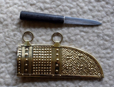

I would be really interested to see any examples of the horizontal carrying method for a puuko.
Being an archanic method, there are no historical drawings of this method that I am aware of in existance but we have several archeological findings that illustrate it. However one must remember that these particular knives were found from women's graves. Men probably wore more simpler ones.
Puukko from Inari, Lapland.
Puukko from Eura (reconstruction).
Puukko from Perniö (reconstruction).
