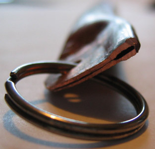

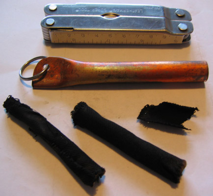

A bit late in finding this thread, but thought I'd give it a go - Two rolls of denim char-cloth at first two attempts. Took on board suggestions re the nail in the crimp (Hoodoo) and ring for fishing out of fire/hooking it on (Jon)
Leatherman supertool shown for scale
...and the hole in the end (used an oval nail and then flattened it a bit more.
So, had char-cloth and flint and steel - got a spark to catch first strike. :D It normally takes me quite a while longer. :eek:
Now one thing strikes me, since each time I've tried it, the heat dries out the earth plug, making it prone to fall out. So I won't be able to pick the cooked item up by the ring with a stick, else plug and char will fall out the bottom probably into the fire - I'll have to drag it from the fire with the stick to where it can cool down.
Great concept and very clear instructions from alick - thanks.
