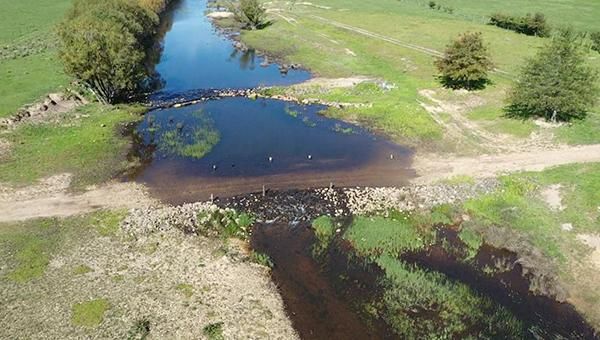

In Australia, they do something similar with what they call "leaky weirs". They don't have beavers in that part of the world, but the leaky weirs are basically a BDA that allows water through at a slower pace so erosion is limited.
Everything is site-dependent. As you can see in this image, they needed cross-water access, so they lowered the road into the water rather keep it above. The 2nd weir upstream prevents the road from being washed out while also making a pond of sorts where marsh plants and baby fish can grow.

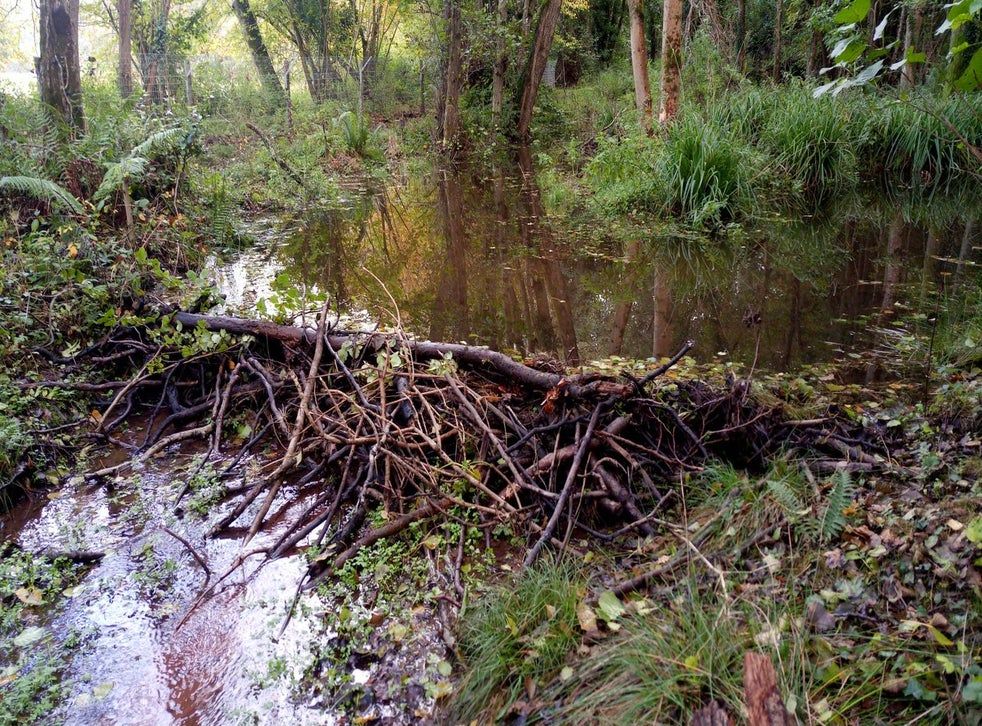

And just to show you how it's done.....
aHQ9NzI2
That's a picture of a genuine beaver dam; one of the very first built in Exmoor in some 400 years. The beavers were re-introduced to the area and they built their main dam a few dozen yards to the side. When the water backed up, it found a new path downhill and the beavers weren't having any of that nonsense.
Sure, the water's still flowing, but it's also ponding. We want the water to flow -- just slowed down and spread out. The beavers prevent deep gullies and raging torrents.
