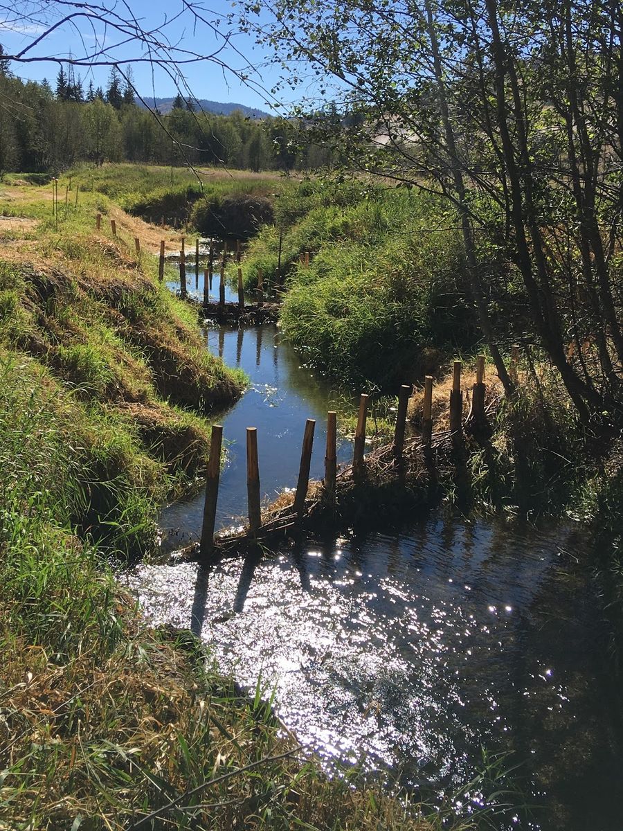

Contrary to popular belief, BDA's don't have to cross the entire stream. Like natural beaver dams that blow out during high rain events, you can use partial BDA's to force the water to the side, increasing sinuosity in the flow of the river and thus slowing it down. Creating meanders in the stream makes it prettier, increases habitat variation, and betters the fish, birds and bug populations.
Nl8wMDYuanBn
By spreading out the flow of water, you can help restock the water table, enrich the soils of the flood plain, kill non-native species that often encroach onto territory that's now too dry for native plants, and increase the overall health of the ecosystem.

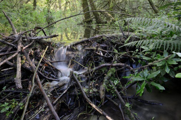

Here's a picture of one of the first beaver dams to be built in England in over 400 years. Pretty cool, huh?
cGc

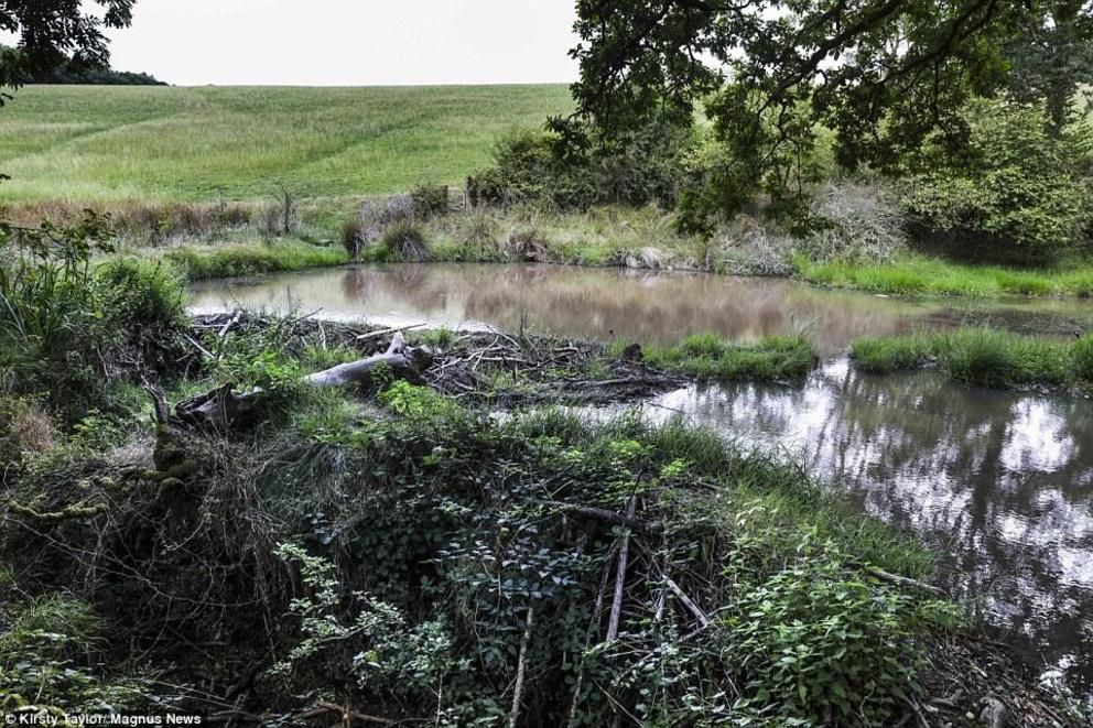

Here's a nice little dam and pond in the Devon Valley where beavers have gotten stuck in and are being watched.
dz05OTImaD03NDQ
This river bottom was once just a channel that drained the water out of the whole region just as fast as gravity could make it happen. It wasn't supposed to be that way, but the beavers haven't been there for 400 years.
As soon as they were returned, they got to work and the actual natural state of England responded accordingly. This is what the land is supposed to look like. This is what it looked like for millennia.
Nl8wMDYuanBn
cGc
dz05OTImaD03NDQ
