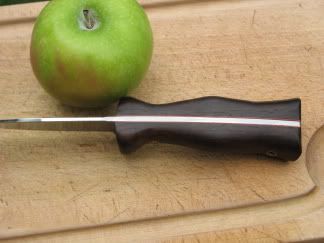

For a deeply sculpted handle, like the one shown in these images, what would you recommend?
This is the first time I've made such a handle, and I don't have a lot of experience making sheaths.

If you think the difference in thickness between the blade and the handle are so great that wet moulding isn't possible/sensible, why not make a stacked leather sheath with fillets behind the welt to allow for the thickness of the handle? This design will allow the knife to sit squarely and safely in the sheath but will almost inevitably need a retaining strap or similar device as the handle will tend to make the rig top-heavy. Witha larger knife you can do away with the strap (if the knife is a really good fit to the sheath) as the weight of the blade keeps the rig upright.
A sheath like the one I made some while ago for a bowie demonstrates the stacked sheath with fillets behind the welt and blade quite nicely. The extra little "sheathlet" built in for a sharpener is, of course, optional.
