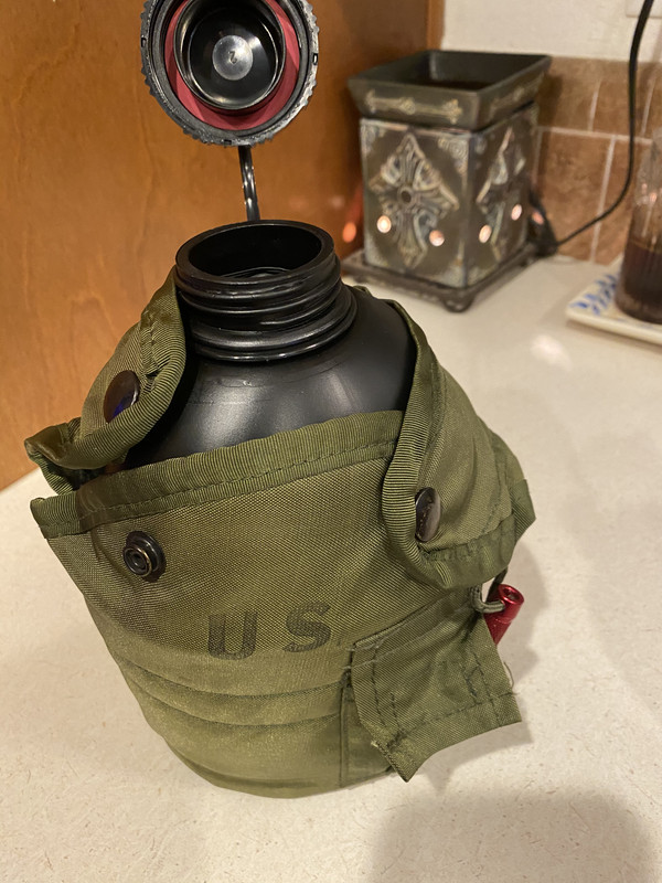

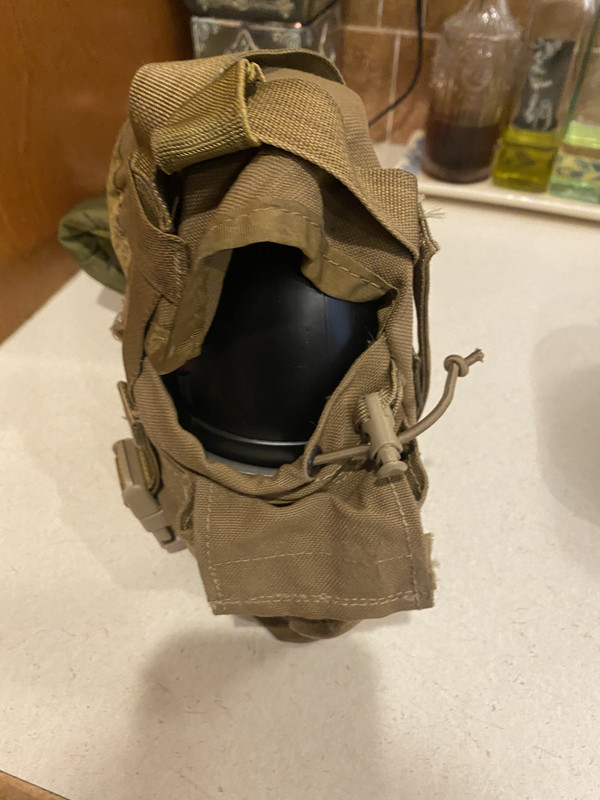

Does for example the British Osprey bottle with steel mug fit into an ALICE canteen pouch?

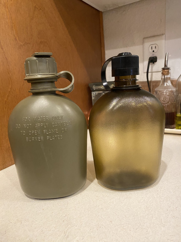

Has the Nalgene canteen exactly the same shape like the issued one?
Nalgene we get easily every corner in Europe, the original US army canteen is just rarely available.
I can not get the Osprey bottle and cup into an ALICE carrier with both buttons snapped. The MOLLE carrier works.
the Nalgene is close enough. It fits the US GI cup just slightly more snug than the GI canteen.

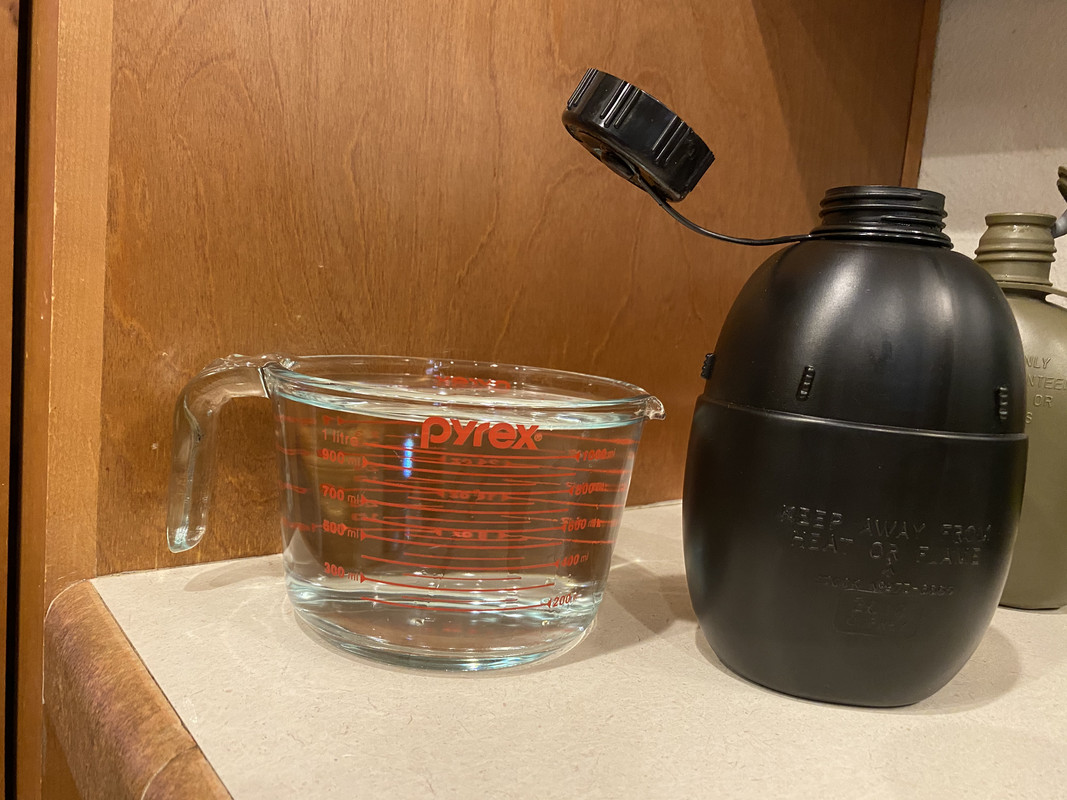

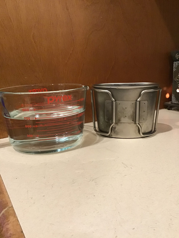

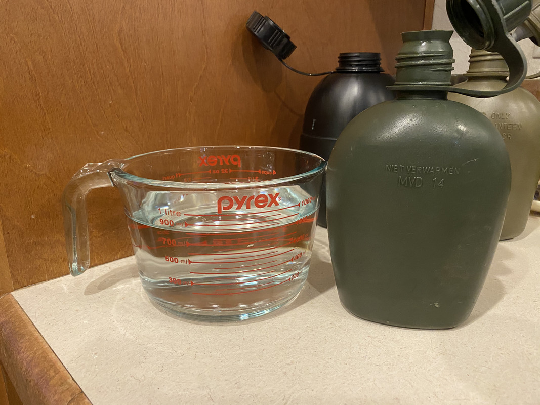

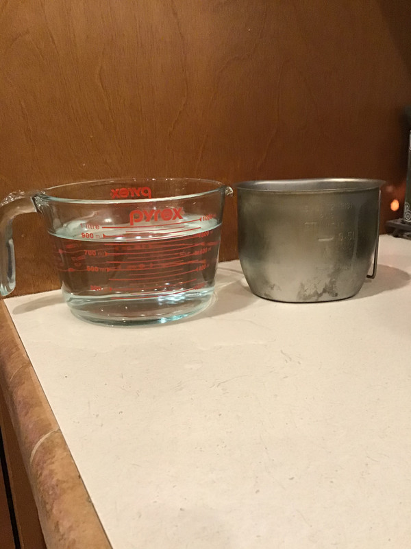

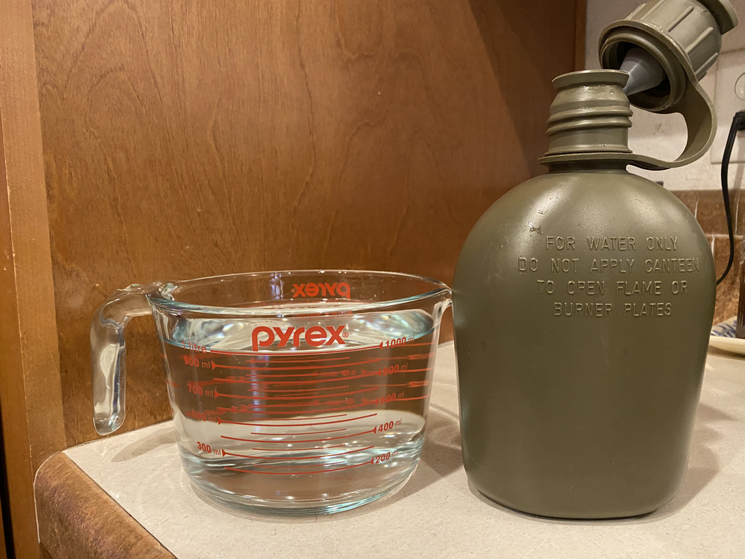

I was personally curious about capacity of each canteen. Pretty sure my Pyrex pitcher markings are not exactly accurate, but they give a good reference. each canteen was filled up to the mouth of the canteen as if trying to keep them from sloshing.
US canteen- right at the 1 Liter mark.
Dutch canteen- 800 ml
Osprey- about 1.2 Liter.

Here is a photo of how Nalgene canteen and dutch canteen cup fits together.
The canteen does not go all the way down, some 2 cm empty space between canteen and bottom of cup remains.

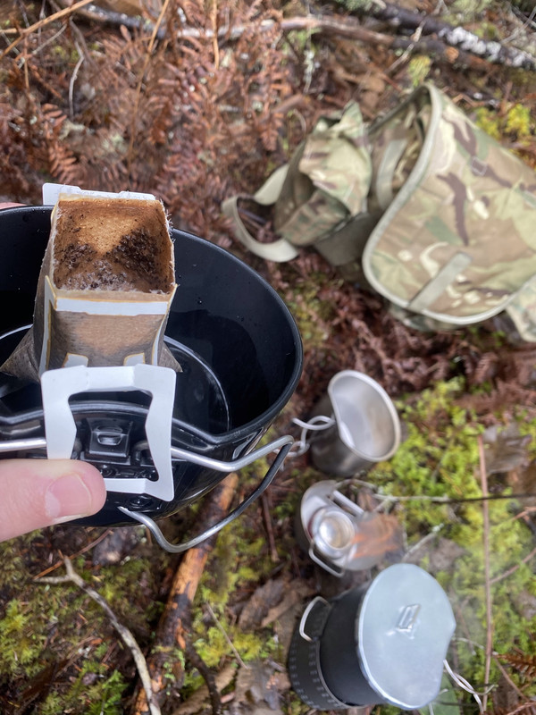

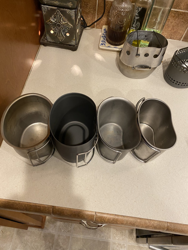

Comparing Crusader cookers:

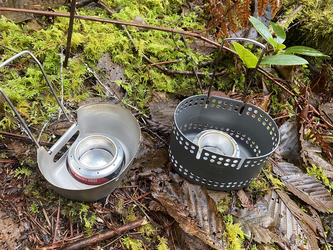

Obvious points are that the Mk2 is larger than the Mk1. However, it is lighter. When it comes to nesting for storage, the Mk2 mug does not settle as deep into the cooker base. This could be viewed as a negative for the amount of total bag space it takes up. However, it does allow for storage of an alcohol burner and a few small odds and ends if one takes advantage of the space. The Mk2 pot stand wires rest high enough from the bottom to allow use of a Trangia type alcohol burner. The wind screen height helps in both mitigating wind effect from whatever fuel source is chosen and it helps channel and reflect heat at the mug, when heating water, which seems to contribute to getting faster boil times.
The Mk1 cooker while being more compact in size as well as nesting ability has the drawback of not having a pot stand height sufficient to use a commercial Trangia type alcohol burner. It’s lower height also makes using it as an improvised twig burning stove a bit harder to manage, as it has less organic fuel capacity. But, being stainless steel it is a durable piece of gear.
I made my own soda can, alcohol burners to a height that can be employed in the Mk1 cooker.
Some coffee along with some chicken and pasta on my first hike with both systems a couple of months ago.
(And I like the plastic mug as a way to not burn myself on a mug that was just off the cooker.)

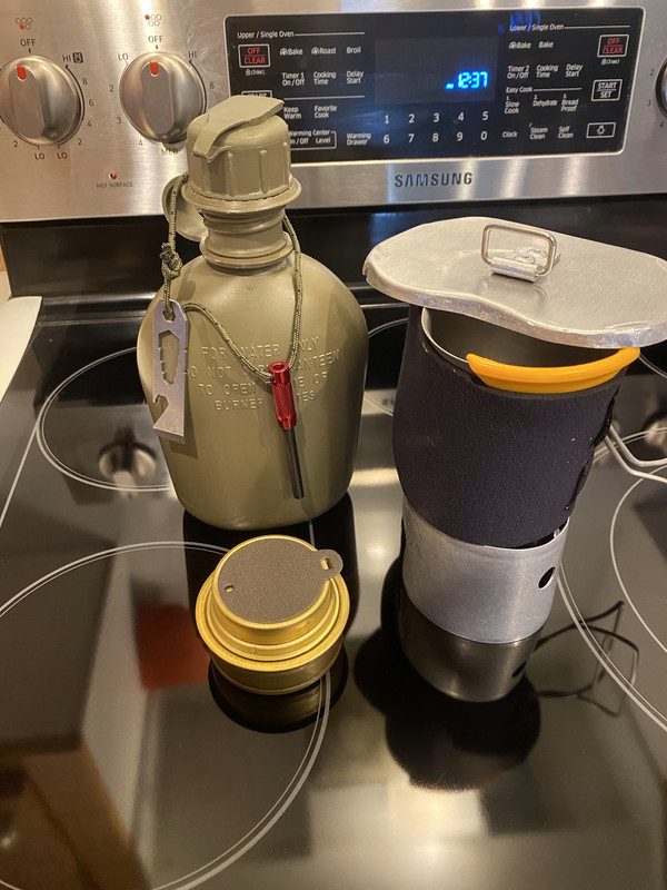

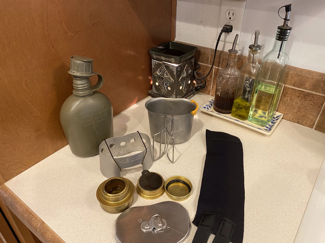

My USGI is something I’ve had for a long time. Actually bought another complete new set to turn in after returning from deployment so I could keep my issued set. I’ve made or acquired a few additions to “civilize” or improve the kit a bit.
Lid made from a stainless steel baking tray, helps cut boil times. Trangia burner, heats fast and clean. Sheet of neoprene, makes handling the cup after cooking, much more pleasant. Silicone “Hot Lips” mouth protector helps keep me from burning my mouth on a hot cup. Some bent wire, holds the cup slightly above the cook stand, to prevent it from sticking in the cook stand.
weird I remember mine fitting better than that - I could fit the set in a repro m56 canteen pouch
the nalgine is slight smaller than the mill issue bottles - infact you can cut down an old bottle to make a bowl that fits oveer the nalgene
