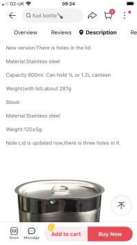

Another update and option for canteen cup cooking system.
Jolmo Lander version from AliExpress less than £14. Included is cup, lid and stove stand
I have not used it to cook yet but I am very impressed. Build quality seems very nice, better than the Rothco and Mil-tec versions. I might actually prefer it to the original issue system. :D
The system fits USGI 1 Quart canteens as you’d expect. The cup, stove and bottle will fit in an Alice cover, the whole ensemble including lid will go in the Molle carrier.
The stove/cup stand is the later style but with small rear slots and side cut outs (I can’t remember their function).
The cup butterfly handles lock together. :cool:
The lid doesn’t clip on and sits inside, it’s also a pretty good fit for the issue cup. :cool:
The lid has drain holes at one end and the handle will stand up as the fitting is snug enough to grip it.
:cool:
L to R: Mil-tec/Rothco; Issue first gen; Jolmo Lander; MFH cup with later type stove.
