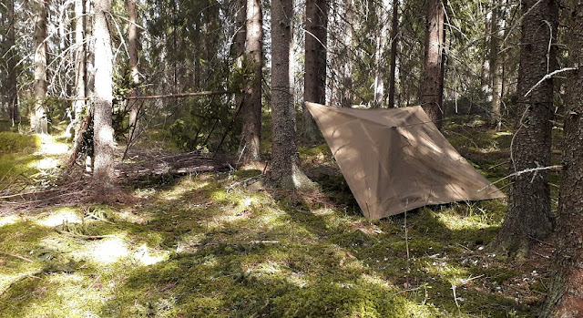

First things first. Since it still is april, we have april showers, so an emergency shelter is setup using my plash palatka and bungees in the fashion I came up with last time out, meaning one bungee around the center toggle.

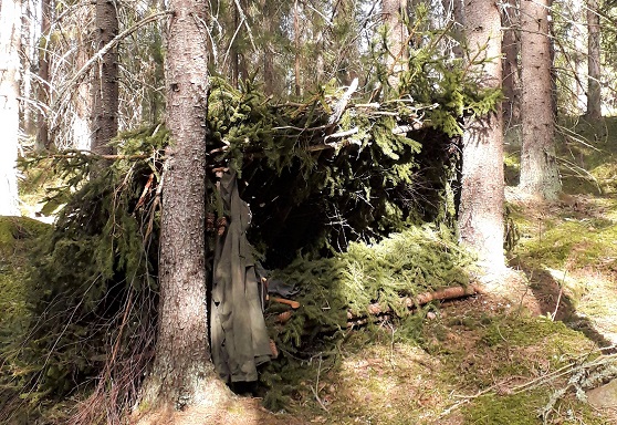

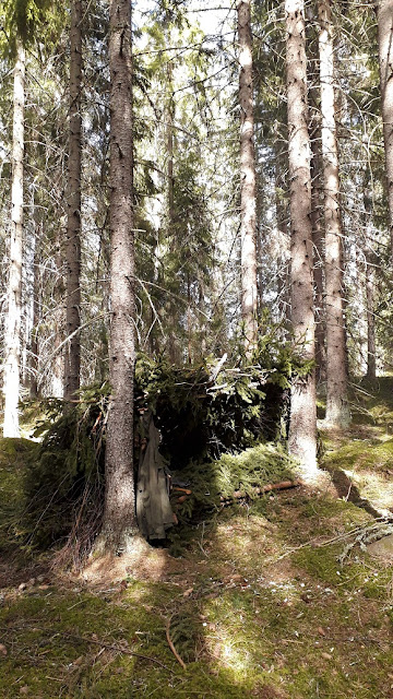

After the phase 1 shelter was erected, it was time for a phase 2 shelter; a 1-man shelter of the type I had built once, way back in the beginning of my outdoor adventures, inspired by Ray Mears. Enough talk; it was material gathering time! There were heaps of spruceboughs and small trees all over the place and I used the smaller sprucetrees as sleds for transporting a load of boughs toward the campsite.
The limitation I had set myself was to use nothing but my hatchet and so I set to work!
I erected a frame of thinner birch trees. The top pole is my length with outstretched arm and the supports are forked, so that they catch into each other and support each other and the pole. The joit can be strengthened using birch twigs. Fresh ones are best, since these are very flexible. Mine were already a few months old, so snapped from time to time. I then laid out the "ribs" of the shelter, using the thicker branches of the birches. Onto those I added the spruceboughs, which overlapped one another, creating a lattice as shown.
The entire structure was then covered using smaller boughs which I pushed into the lattice from the bottom up. That way they will act as tiles as shed water on the outside. I also did a small patch covered with moss and laced together with small birch twigs, which would create a completely closed surface.
I could not go the entire way, since time was rather limited (or I set my goals to high), but also because I had not asked for permission from the landowner to rip up all that moss, but the idea is clear I think. The smallest birchtwigs were laid across the floor inside and spruceboughs and off-cuts were spread over these, creating a layer of about 20-30cm, onto which a floormat and sleepingbag would be laid out.

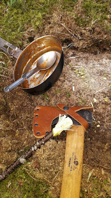

I cleared a rock from its mossy blanker, carefully rolling that back, so that it could be put back in place once I was done. It also made a much more stable base for my messkit & burner.
For lunch was leftover beef&bean stew and that can be really hard to remove later on, especially if it gets time to dry up. The trick here is to use a thicker, reasonably fresh birch branch, first as an extended panhandle, of which you pound one end into a brush, using a rock or the back of your hatchet.
Then you heat up some water and as the water heats you scrub the pan with the brush end. At first this is hard and stiff, so good for scouring and scraping the caked on food, but as the water warms the brush softens and you can rinse the remaining less coarse residue from your pan. If you can add birchleaves, the warming water will release the saponin therein and you have natural detergent to boost.

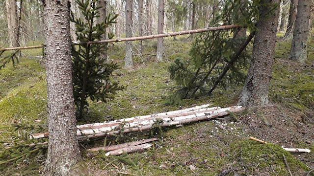

After lunch it was time for phase 3; an all-natural lean-to. My first ever lean-to to be honest. And again only using my hatchet.
I found a pair of suitably spaced trees and used to roughly man length poles to shore up the top pole against those trees. I used the thicker trunks of the trees to construct a bedfloor and the thinner ends I used as ribs for the wall. I left the side branches onto these end, so that I could use these to weave together these ribs and subsequent branches. I used long and thin birch branches for weaving horizontally, creating a coherent and sturdy lattice again.
Once that lattice had been completed to my liking I started adding long spruceboughs to and through that lattice, locking the ends in place by weaving again. I worked from the bottom up, using a rooftile principle. Once these were in place I started using smaller boughs, shoving them up into the structure, again from the bottom up and again overlaying each other.
By now it was getting late, so I could not completely finish the procedure to produce a completely tight wall. I spread all the surplus smaller and thinner birch twigs over the logs lengthwise and on top of that I laid a layer of spruce twigs across those. That was topped of by the smallest of twigs and off-cuts, creating a 30-40cm thick, springy layer.
One thing I had underestimated was the amount of weight such a construction would accumulate and carry and I ended up supporting the thinner end of the top pole. You can see that support between anorak and backpack. I would have wanted to add extra support onto the side of the wall, supporting the joint between top pole and supports, so that these could not move outward. I will do so the next time I go out there and complete the construction.
