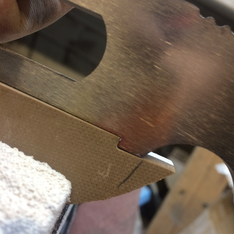

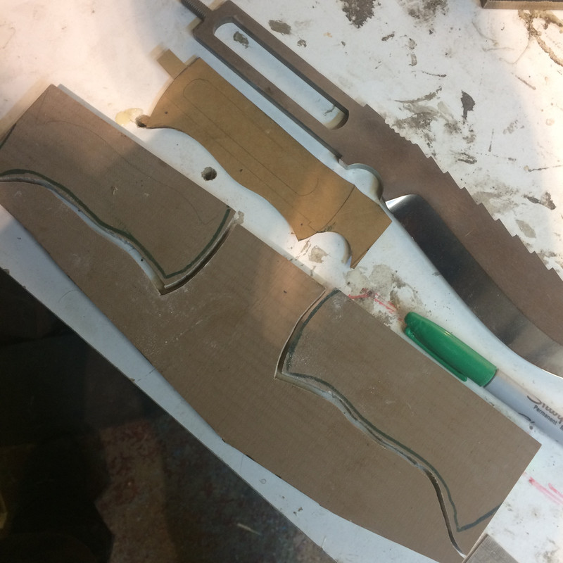

Gearing up to start a handle for this Wilkinson Sword Dartmoor.
Partial frame tang handle and the cardboard colour is almost right for what it'll be too - coyote brown G10!

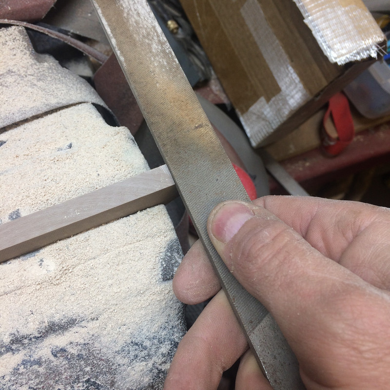

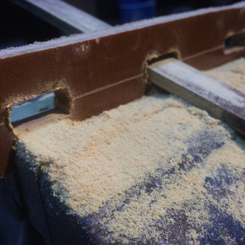

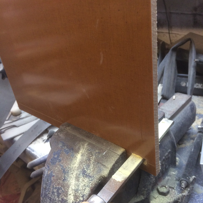

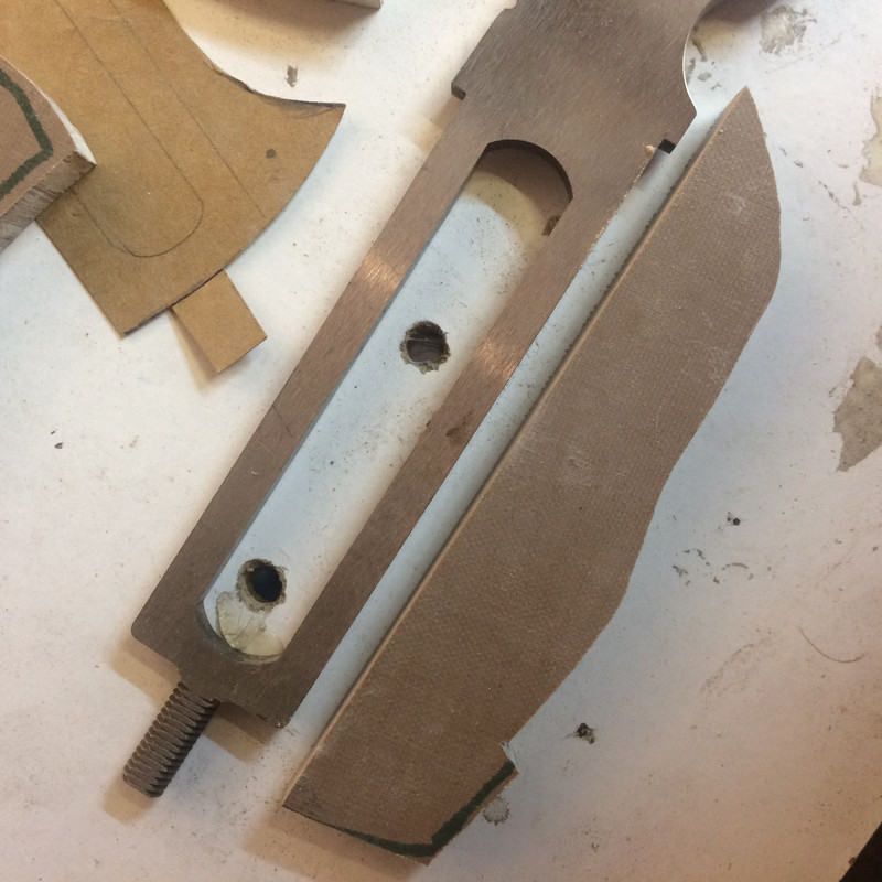

Progress on the Dartmoor handle.
Hand saw the scales out with a modified hacksaw.

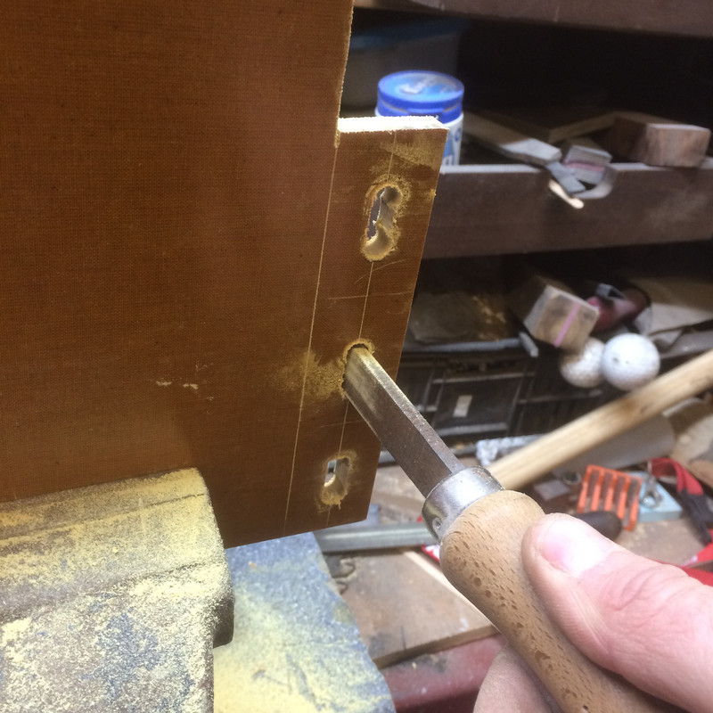

Decided to keep the step in the tang to help index the handle so a nice slow bit of filing to fit.
Bit of glue next.

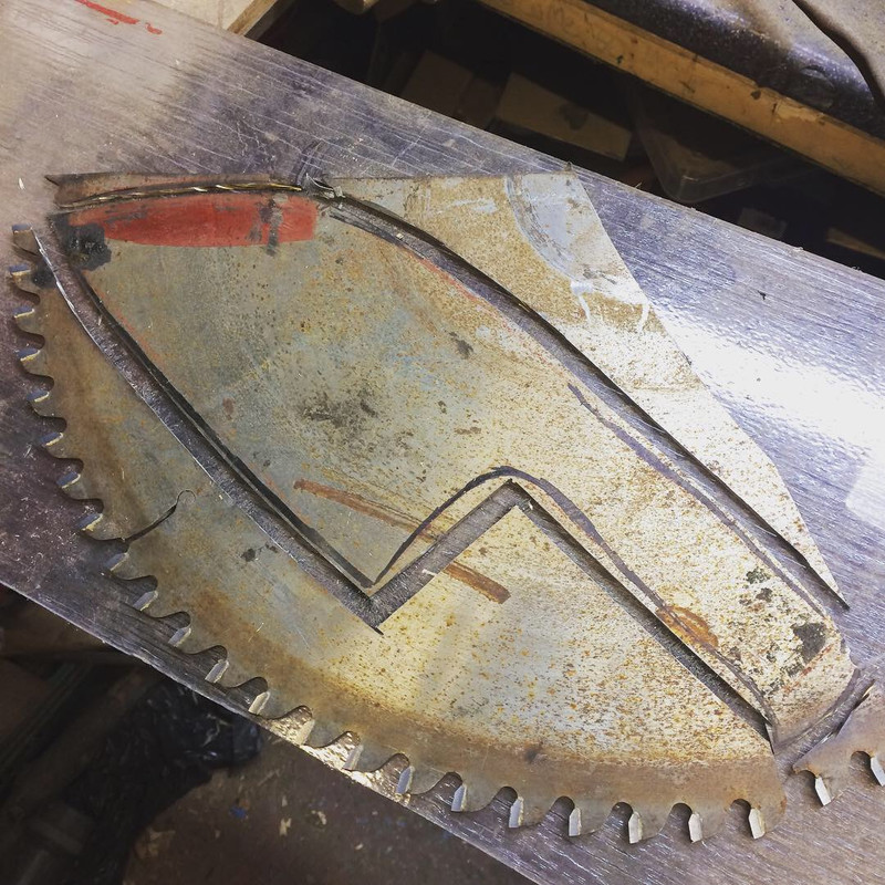

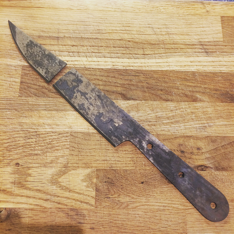

Sometimes you just have to let the devil out and go for it:
Had an 'issue' with another project so decided to jump on the bandwagon of the Siberian Chef Knife pattern and cut this out of a woodmill saw blade.
Bigger then it will be but easier to grind more off than dust off the reverse grinder if I wanted it a bit larger.

Not that you will feel any better but it is better it fails at this stage than later.......well that's how I silver line my problems!
I try to embrace failure and use it to learn. I've had the chance to see the grain structure and also won't make the same mistake of the cause of the failure again.
This will get used as a template to remake it (it's a commission) then I'll regrind it into a smaller version - shorten the handle to match and curve up the edge to reform the tip.
