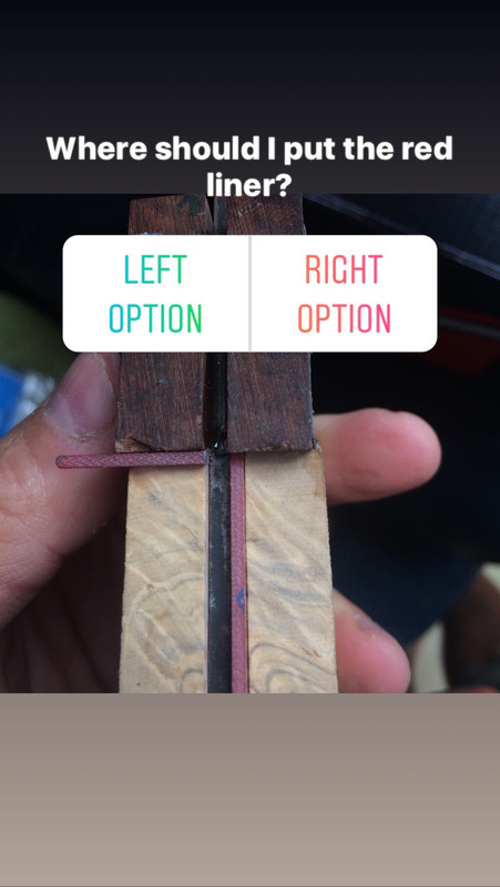

A very quick trip through how I do it. :)
https://instagram.com/p/Bn6jOWpA8uA/
Reactions: greencloud
greencloud
Oct 10, 2015
117
30
Newcastle
Left option. The contrasting woods sometimes works and sometimes... not (nothing I'm good enough to explain, probably the 'flow' between the different grains). The liner will give a nice buffer between.
