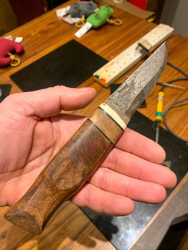

After fitting my new garage door last weekend, I had chance to do some sorting and have come across some(!) knives. I doubt I’ll be back at any real making any time soon but there a few I might consider working on.
This one is quite a significant knife for me. The blade was the first handmade piece I ever bought, along with a blacksmiths one piece knife, direct from Trond.
I’ve made quite a few knives by now but for this one, it is at least the third attempt at a handle. The first was way too ambitious for a first attempt though I think I could have rescued it now. The second suffered a split and this one, I’ve taken too much off the rear!!
It’s cow bone for the bolster, yellow mallee burr for the spacer and ironwood at the back.

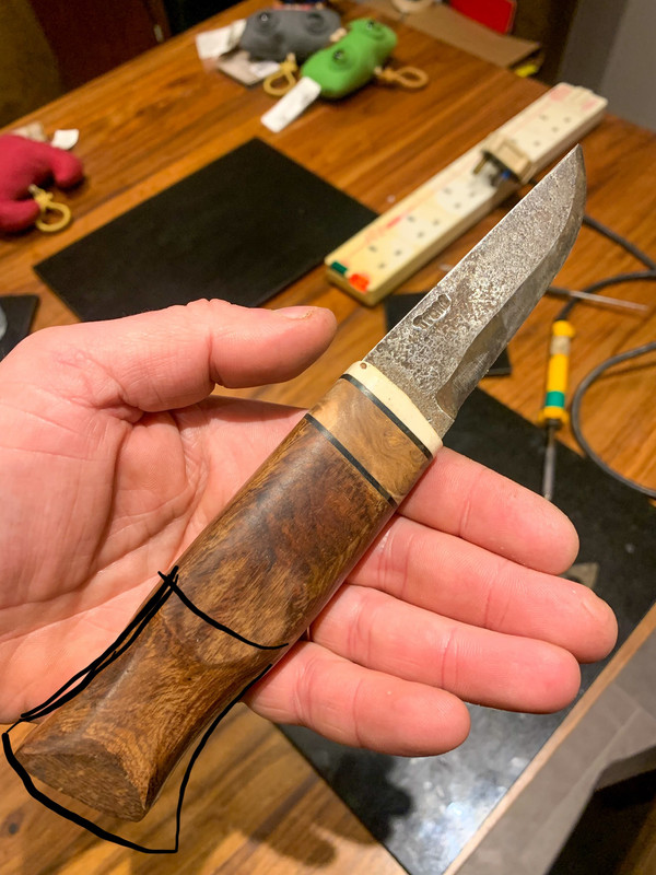

I need to get the crayons out but I think I need to just commit to chopping a section off the back and sticking a bigger bit of something on. What that is, I’m not too sure.
To me, it needs to look different enough but not odd (I don’t have any more yellow mallee to match)

Needs an antler crown, moose or reindeer.

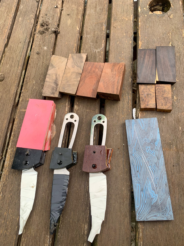

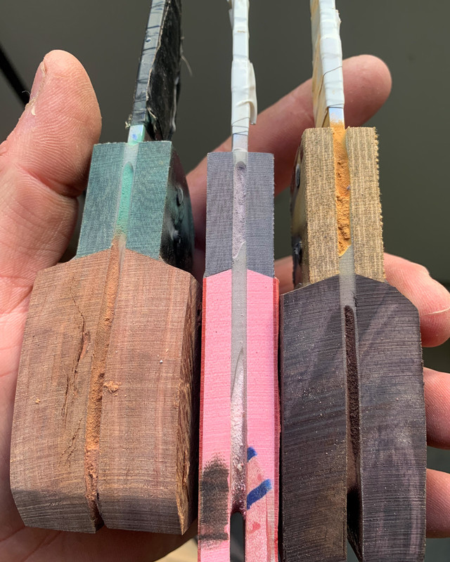

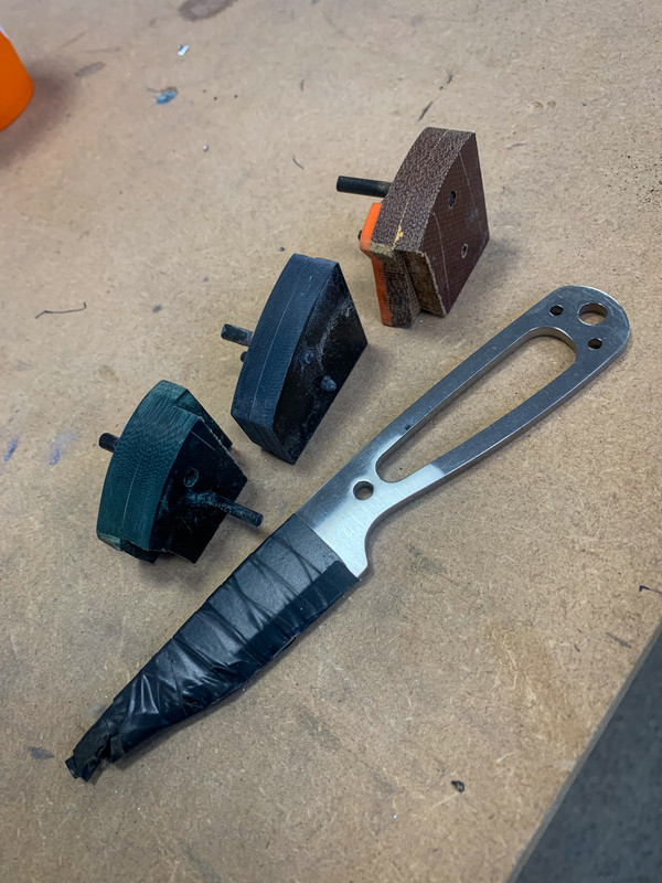

That’s bolsters glued up on three.
I should have two more of these blades somewhere!

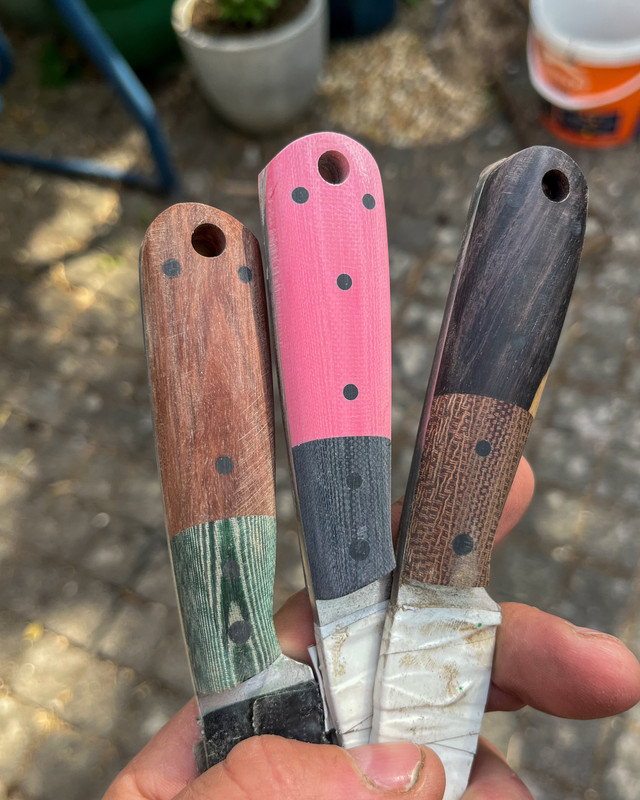

I know I’m putting the black g10 with pink g10 but am being indecisive about the other two now that I have a fourth set of bolsters ready.
I might pick with my eyes closed!

I really reckon one finished with solid slabs of pink G10 would look fabulous. Those blades have delicate ‘femme fatale’ curves. Black leather sheath, ooh, suits you madam. ;)

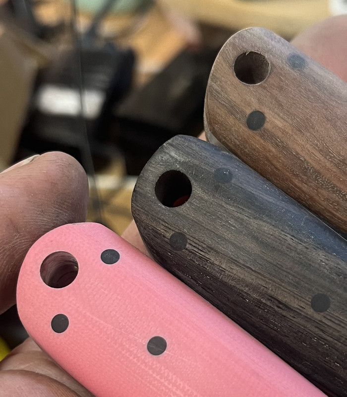

Hhhhm, lanyard hole…
So I went with carbon fibre pins for these. The carbon fibre tube that I have is quite thick walled and so I decided to leave the holes unlined to maximise the hole size.
I’m now doubting that, especially with the two wood ones. One is African Blackwood and the other is red mallee - both tough woods. The wood grain there is short grain so there’s the potential for damage and a tube would protect it from the cord. Or is a lanyard on a necker such a small thing that it’s no bother? Hhhmm!
So, leave them unlined and countersink?
Or line them with a silver tube that could look odd in contrast?
