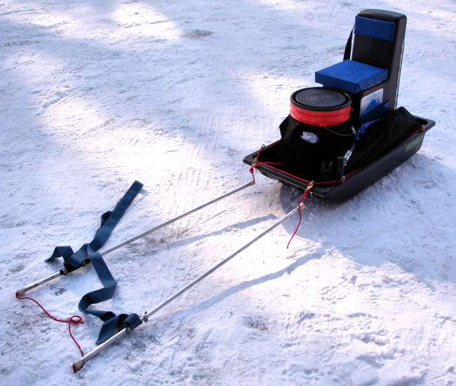

Looks like it will work well. I use something similar. You might consider a single loop in the front. It would go behind the head and uder the arms. I use poles to space myself from the sled, and a strap is more comfy than a rope imo. This is my ice fishing rig.
